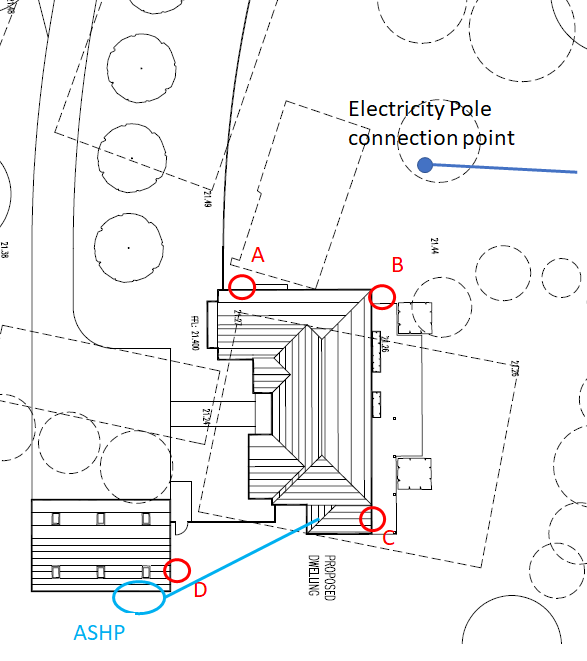

MortarThePoint Posted May 14, 2020 Share Posted May 14, 2020 I need to decide where to put the hockey stick for the electricity meter as the sub floor blockwork plan is being finalised. The diagram below shows where the electricity enters site and the DNO would make the connection. I can see three main options A - On the house elevation nearest pole and most visible from the drive B - On the rear elevation nearest the pole and visible from gthe back garden C - On the utility wall (rear or side) where the plant is located, but not the ASHP D - On the garage which is where the ASHP is to be located The Air Source Heat Pump is planned to be on the back of the garage so as to hide it visually and acoustically. I have asked ASHP suppliers and they say that run of pipe to the house is fine. What do people think? I am tempted to go with 3 phase as well as the pole supports that (site previously had it). Link to comment Share on other sites More sharing options...

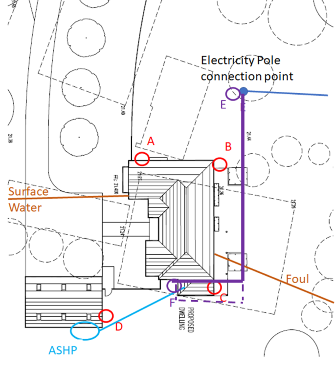

ProDave Posted May 14, 2020 Share Posted May 14, 2020 E In a kiosk at the bottom of the electricity pole. Will be a cheaper connection. Can be connected and finished before the house is built so you have a site supply without having to move it later. No need for a meter box on the outside wall of your house. Run your own SWA cable from this kiosk to the house when you are ready with no DNO involvement. Link to comment Share on other sites More sharing options...
dpmiller Posted May 14, 2020 Share Posted May 14, 2020 You also need to find where the DNO *allows* you to put it. NIE are sticky about that, refused to let us site ours beside the back door... Link to comment Share on other sites More sharing options...

MortarThePoint Posted May 14, 2020 Author Share Posted May 14, 2020 2 minutes ago, dpmiller said: You also need to find where the DNO *allows* you to put it. NIE are sticky about that, refused to let us site ours beside the back door... I'll pass it by them. Did they insist it had to be visible from the front elevation then? Link to comment Share on other sites More sharing options...
epsilonGreedy Posted May 14, 2020 Share Posted May 14, 2020 OP: Have you considered internal wiring runs and placement of the master fusebox? The default rule is to keep the meter box to fuse box (CU) cable run to under 3m otherwise extra circuit protection is needed. The internal CU also needs to comply with disability placement and access regs. Final thought, what about drainage trenches? Could there be a later routing clash? Link to comment Share on other sites More sharing options...

ProDave Posted May 14, 2020 Share Posted May 14, 2020 4 minutes ago, MortarThePoint said: I was mindful of the routing clashes but not the 3m requirement. The 3m requirement rules out A & B. ProDave: does that mean you have the CU in your kiosk? In terms of clashes, can the electricity be routed under drainage pipes? The 3 metre rule means you can only rely on the suppliers fuse to protect meter tails up to 3 metres long. you can have any distance you want between your meter and consumer unit, but if longer than 3 metres you need to provide your own circuit protection, commonly in the form of a switch fuse. I have a switch fuse in my meter box with an 80A fuse in it to discriminate from the suppliers 100A fuse. Link to comment Share on other sites More sharing options...
MortarThePoint Posted May 14, 2020 Author Share Posted May 14, 2020 3 minutes ago, ProDave said: The 3 metre rule means you can only rely on the suppliers fuse to protect meter tails up to 3 metres long. you can have any distance you want between your meter and consumer unit, but if longer than 3 metres you need to provide your own circuit protection, commonly in the form of a switch fuse. I have a switch fuse in my meter box with an 80A fuse in it to discriminate from the suppliers 100A fuse. OK so it sounds like A & B are back on the cards then. I have emailed UKPN to ask if they allow new connections inside a new house. Link to comment Share on other sites More sharing options...
MortarThePoint Posted May 14, 2020 Author Share Posted May 14, 2020 I've added a couple of other options: E - ProDave's suggestion F - On front elevation of utility near where house consumer unit likely to be I've also added drain routes. I'm hoping it's not an issue to pass under a surface or foul water drain. If not only A, B and options. 1 Link to comment Share on other sites More sharing options...

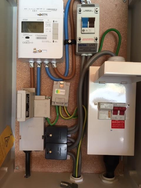

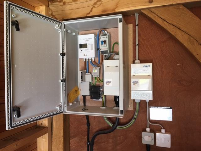

Redoctober Posted May 14, 2020 Share Posted May 14, 2020 Hi - a little late to this thread but for my two pennies worth, we stuck ours in the car port / garage whatever you wish to call it. See image and or my blog for details. SP Energy supplied up to 50 metres of cable all within the connection costs they charged, which was about £900 job done. We used best part of that 50 metre run to take the cable from the pole into the carport. This was all done ahead of the TF being erected and allowed the Trades to tap into the power supply as and when. The meter is held within a proper approved box and we have had no trouble with it since. It keeps it out of the way and accessible . Link to comment Share on other sites More sharing options...
