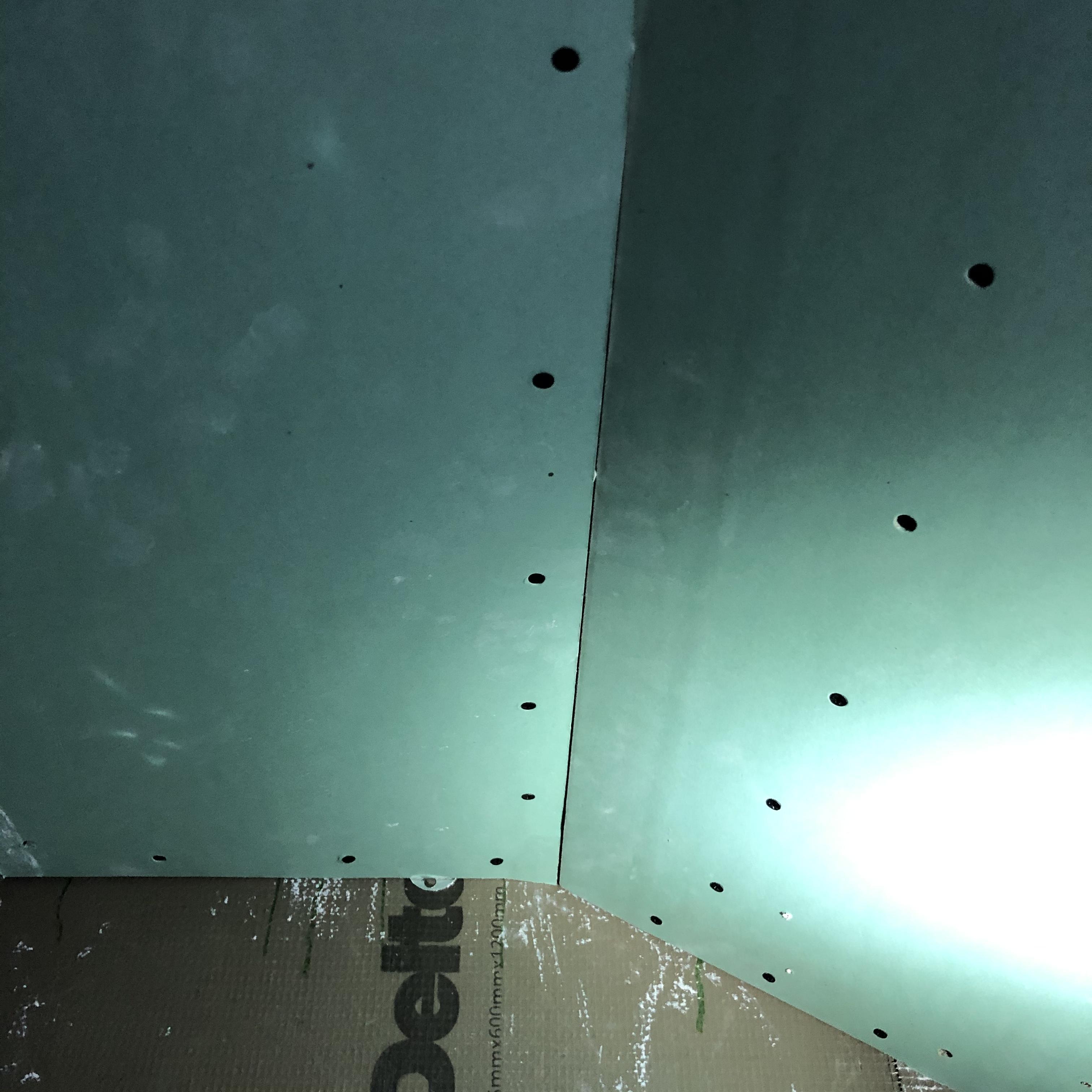

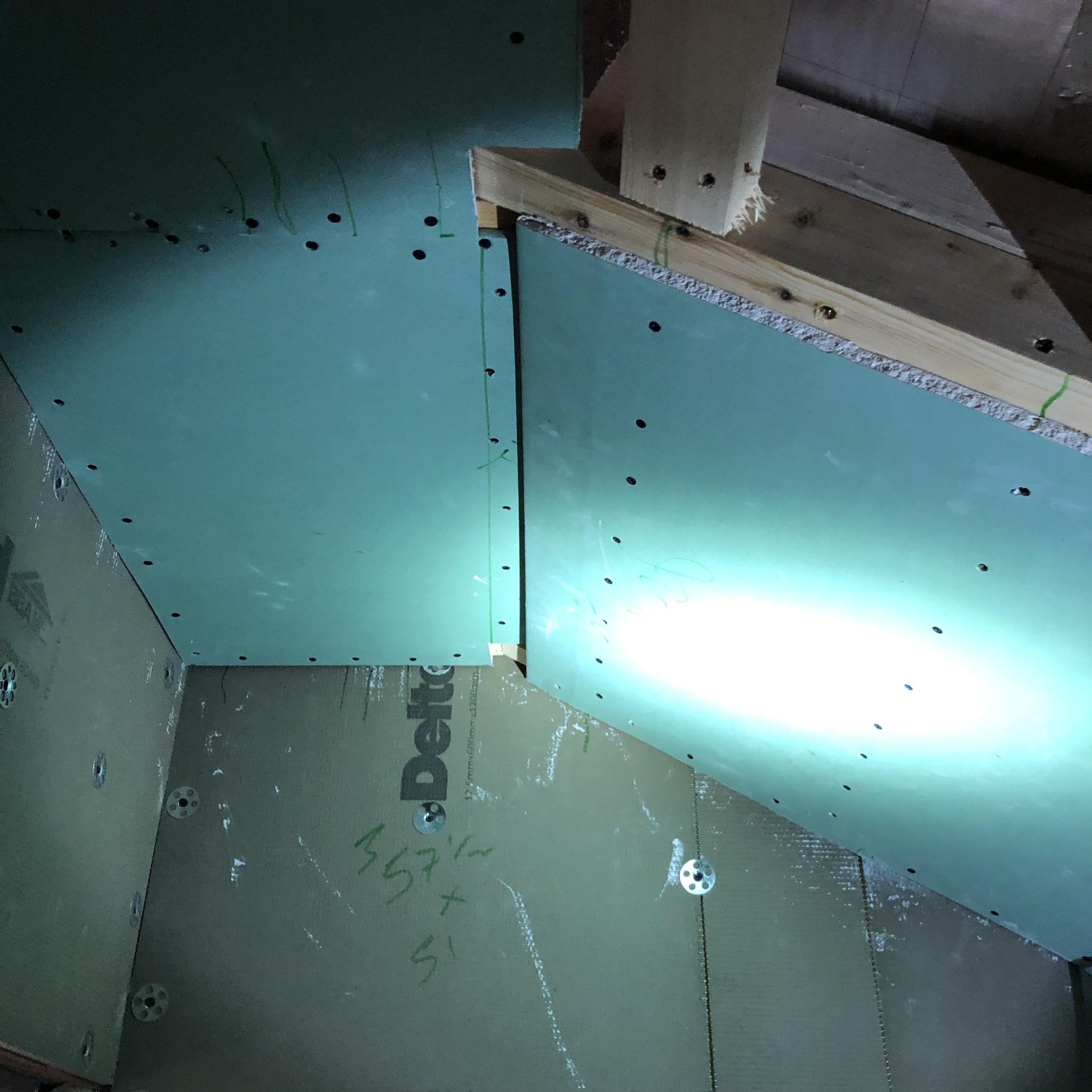

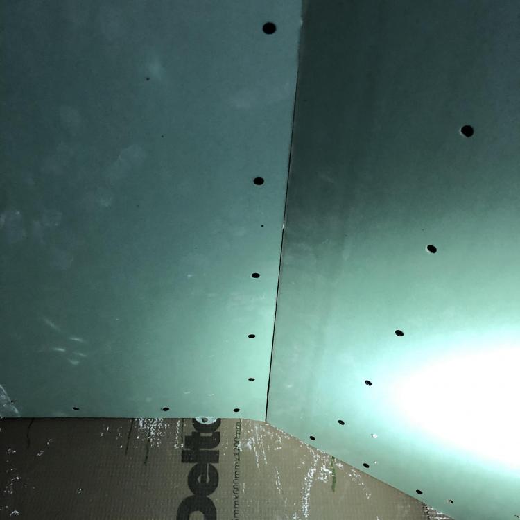

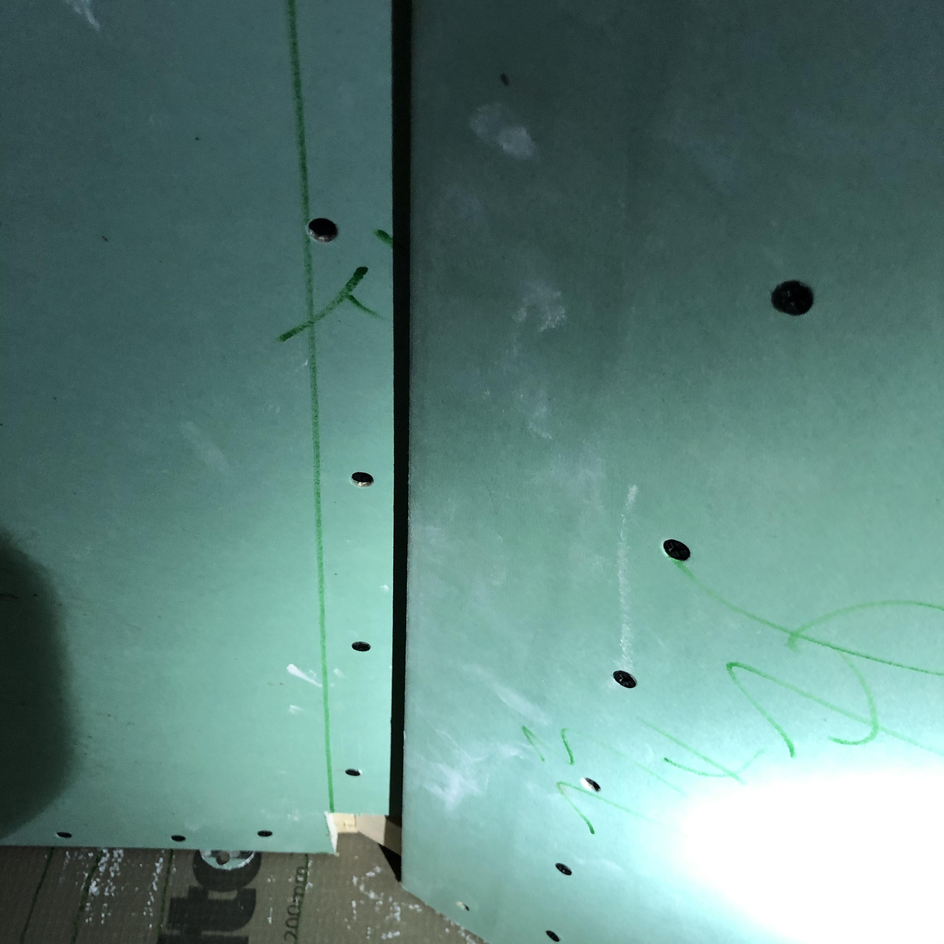

Started on the ensuite ceiling .
The ceilings angled where they meet .
This ok ? ( apart from timber bit showing - will cut a bit to fit in there ) .
Will a plasterer get over the ‘step’ ?
Also I read that apparently he can curve the  join between horizontal ceiling and angled ceiling . Assume this looks better ??

Plasterers can cover up almost anything to be honest, however, here it looks like the diagonal piece should have been a bit higher and the horizontal piece cut back a bit so the join was level, the issue you will have here is if he plasters that out, he will end up having to build up the material across the horizontal sheet a fair bit to get the level looking right, and you will always then have a uneven section which may show against the wall depending on finishing and eye lines etc.
Personally I would have done that in a single piece by scoring and snapping the piece but not broken it off to get a really nice straight line. Straight sharp lines look better, curved lines look like you were trying to hide a mess and he will not than you for that if he is there to do a skim coat as that will need built up.

I was going to take the diagonal higher then changed my mind !
Hmmmm ; think I’ll take the diagonal down and the horizontal . Put diagonal back up . Be easier to get the horizontal to be near flush with the diagonal then . Photo’s to follow of attempt 2 !

In that case, take those piece down (for all they are) slide the diagonal up till it hits the horizontal timbers then re-cut the ceiling PB to suit.

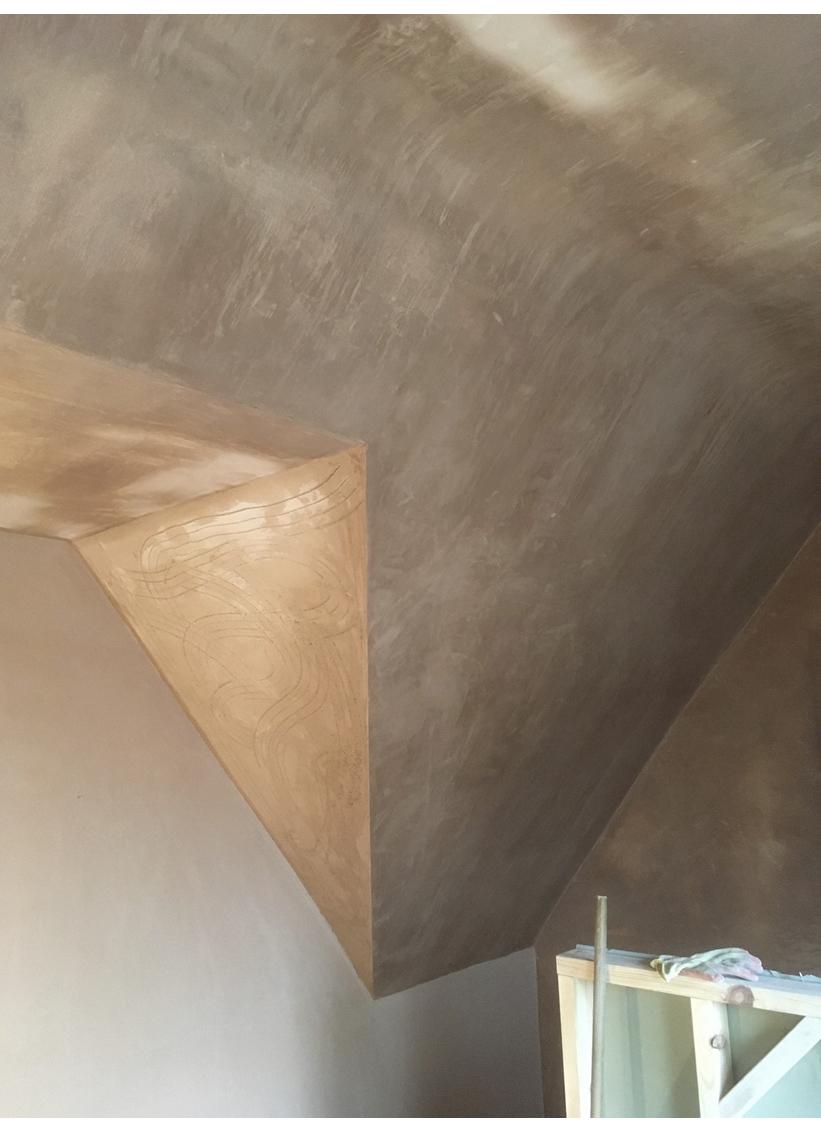

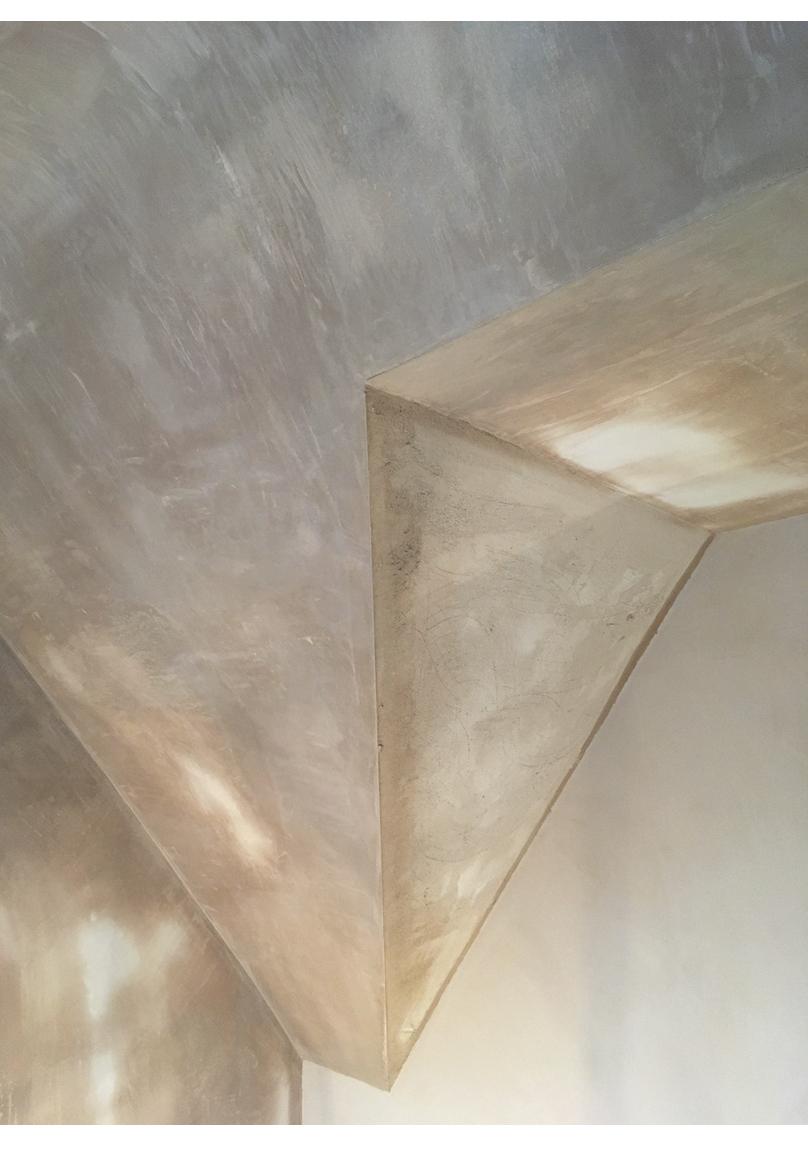

Posted

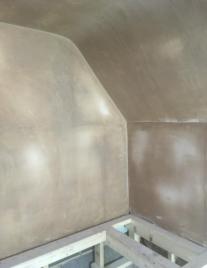

Curves can look good but they need to be built up with bonding first and then skimmed to look right.
Did a big room in roof conversion a year or so back and this was the en-suite ceiling junction
  • Like 5

Posted
That is a nicely executed curve to be fair!

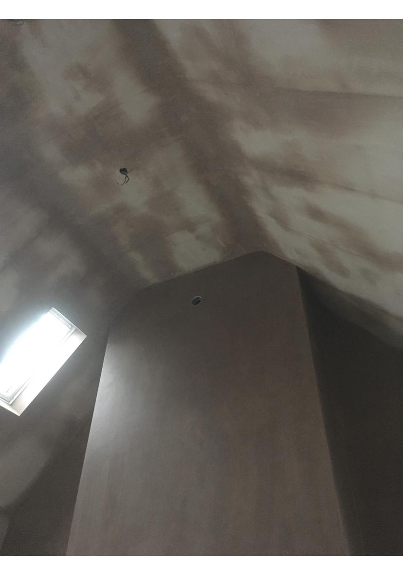

Posted
8 minutes ago, pocster said:
If in doubt add more . If still not sure add some screws . Not confident yet ? - perhaps it needs more screws .
That is actually counter intuitive - put too many screws in a plasterboard and it will fracture along the line.

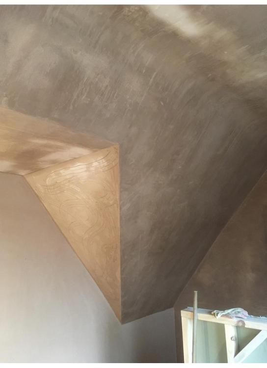

@wozza there are a few more ...
This is the ceiling between two curved sections and a wall...

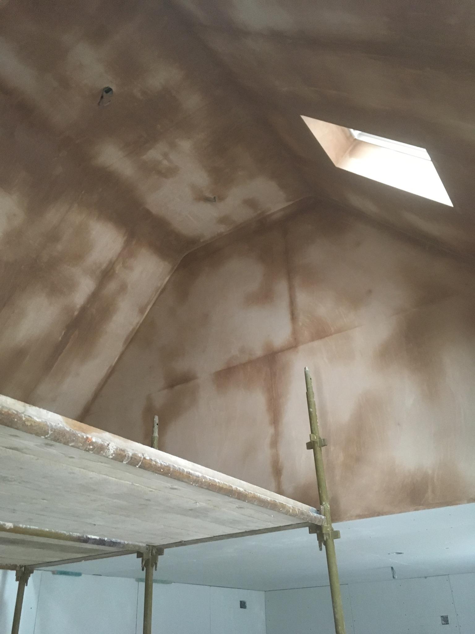

And a 5.3m vaulted ceiling
When it was finished it was nicknamed the chapel of St Andrew the Plasterer .. Pretty lucky that he is a perfectionist and also very reasonably priced too ..!!
We had to do very little prep for paint on this - probably saved 3-4 days labour.
  • Thanks 1

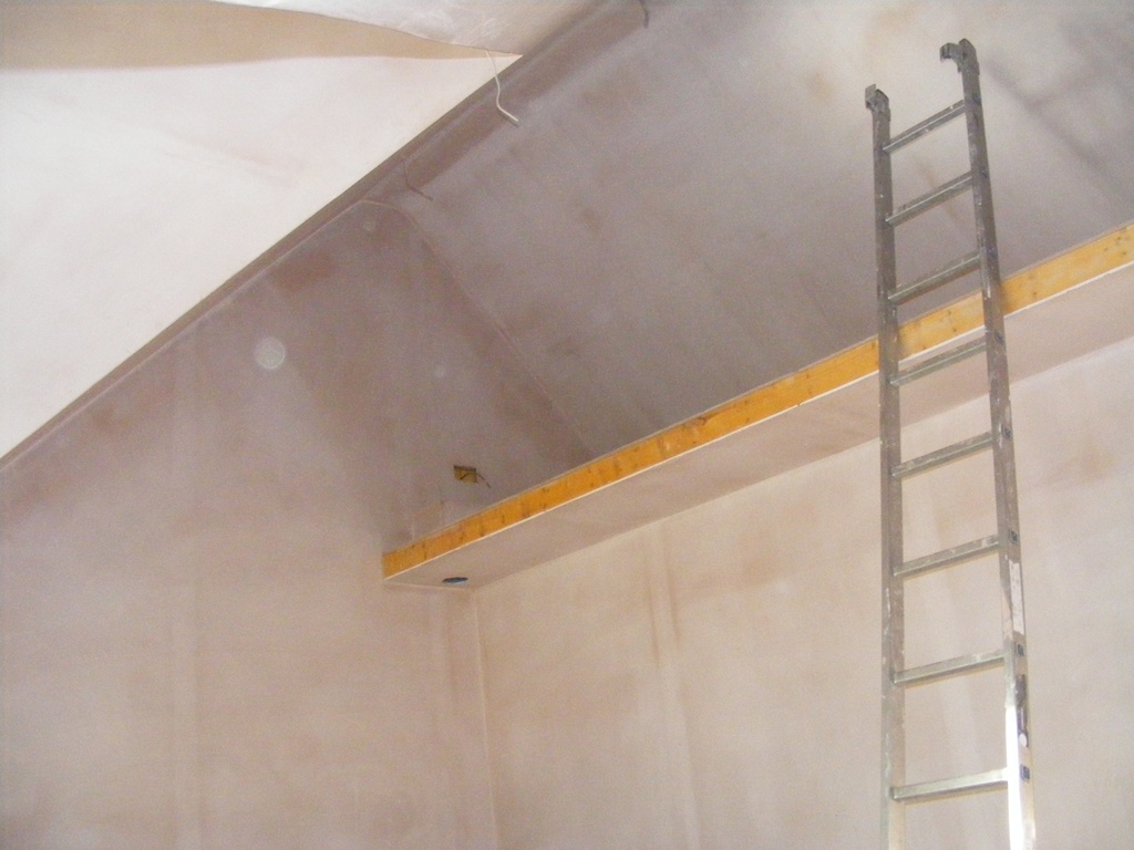

Posted
How did you get access?
Looks tricky to get the top and skeiling in one.  This sort of thing often ends up a bodge and a work from height risk.  That has come out really well.
Posted
Was all done using a full kwikstage platform built in the room, basically from wall to wall. The sides of the chimney breast were a challenge but they were extended out using side extensions on the scaffold and a double layer of boards.

Posted
Ours was done the same with curved edges at the ceiling.
Also done from a Kwikstage platform and partly in our case from the mezanine.  Only about 4 metres to the ridge in ours.
  • Thanks 1

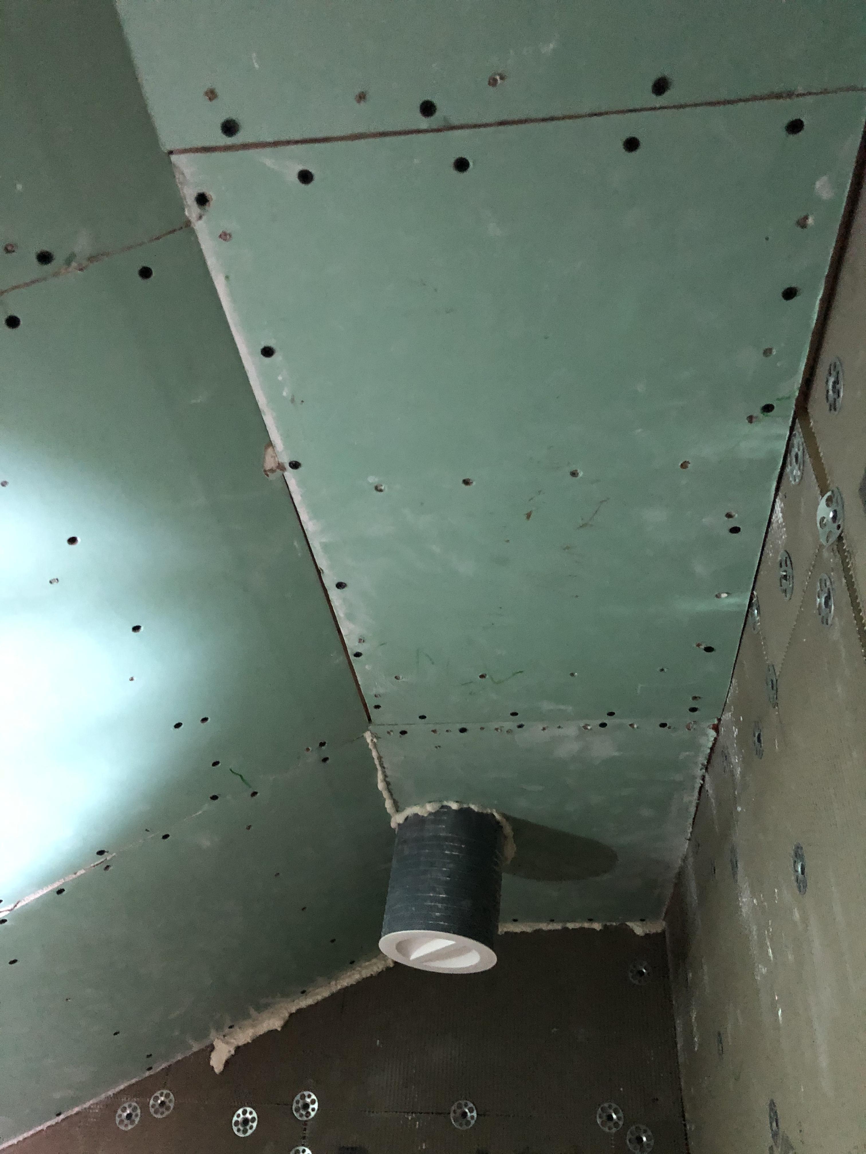

Ensuite done .
Used twice as much plasterboard as I should and 1000% screws more than necessary .
Do I or the plasterer fill gaps etc. tape joints ? .
I assume I leave it now for a professional to sort .
Before anyone says - the mvhr vent is on the piss ( but I can cut flush ) - though the vent cover will be an issue as it will be trying to sit on horizontal and angled ceiling ( blame @Mr Punter for making me move it )
Posted
Trim your mvhr vents flush before the plasterer arrives.  He will fill the gaps (and mutter under his breath about the boarder)
