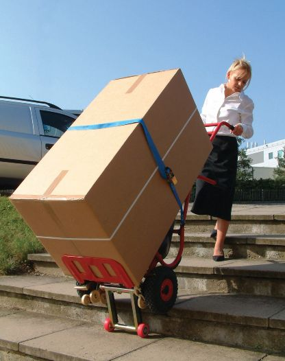

Jeremy Harris Posted April 30, 2020 Share Posted April 30, 2020 Welcome. I can understand the issue, as I believe the safe lifting load limit is normally restricted to 25kg per person (under the Manual Handling Regs). There is a solution, though, and that's to hire an electric stair climber. These come in a wide range of sizes and can shift loads fairly easily and safely up and down stairs. Most bigger hire shops have electric stair climbers, and probably worth looking into, if only from the peace of mind one of these would give, over the risk of damage from manual lifting. This is one around the right size: https://www.speedyservices.com/71_6010-h-stair-climber-powered-310kg-swl Link to comment Share on other sites More sharing options...

Jeremy Harris Posted April 30, 2020 Share Posted April 30, 2020 2 minutes ago, BotusBuild said: Break out the rope and tackle. Done! or a chain hoist That's how I got a ~150kg Sunamp up the stairs on my own. Took me the best part of a day, and was damned hard work (and it slightly damaged the stairs). That was before I discovered just how very useful an electric stair climber can be. 1 1 Link to comment Share on other sites More sharing options...
