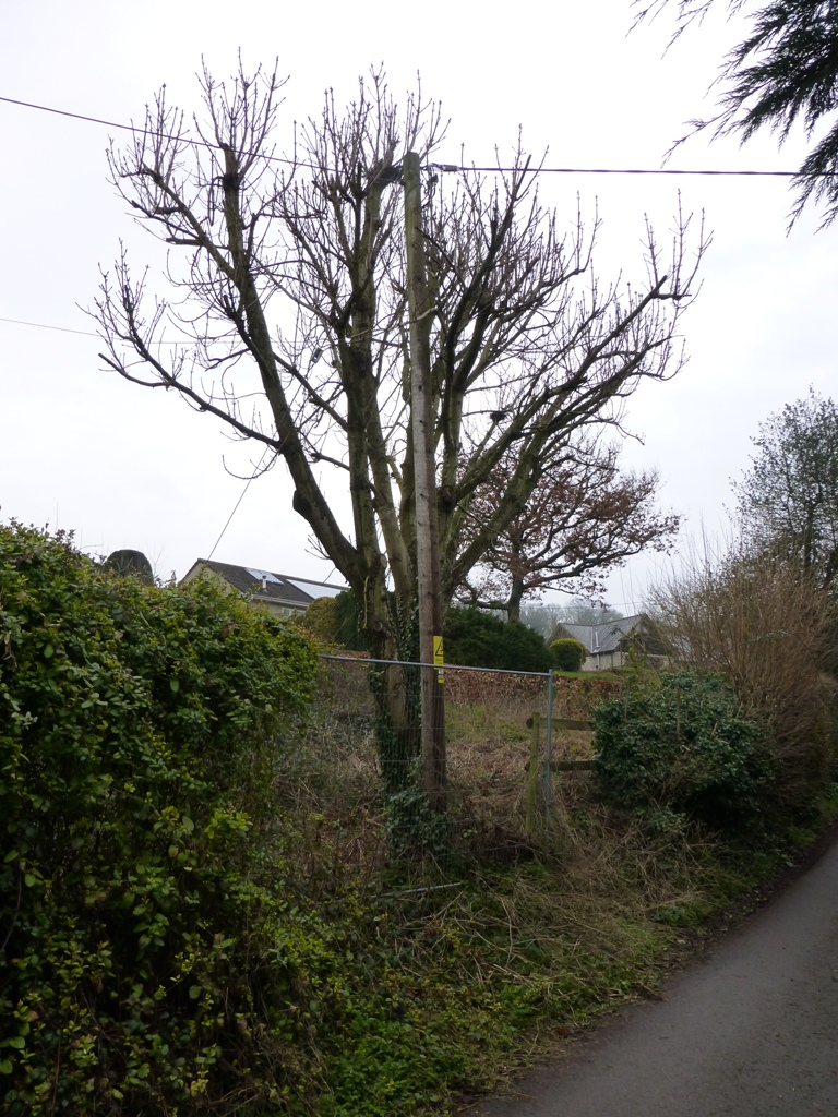

Jeremy Harris Posted April 29, 2020 Share Posted April 29, 2020 Trees can be a beautiful addition to the environment, or a complete PITA, in my view. The right tree, in the right place, is magnificent, but we shouldn't really forget that trees can be destructive weeds, just like any other plant growing in the wrong place. Our plot had two horse chestnut trees on it when we bought it, one right smack where the only possible entrance could go, the other growing inches from a pole with overhead power and telephone cables, with one branch growing around a power cable: The pole and cable needed to be relocated as well, so there was no alternative but to take this tree down, quite apart from the problem where it was growing around the cable. My approach was that it was far better to seek forgiveness than permission, so I took both trees down before we submitted our planning application. It annoyed one or two people, but was quickly forgotten, and by doing this we pre-empted anyone deciding to try and block our PP by deciding to put a TPO on either of these trees. We were also lucky in that, at the time we did this, the conservation area boundary ran along the lane, and missed where these trees were by a few feet. We've since planted several replacement trees, anyway, plus our house is a "CO2 sink" in effect, that is roughly equivalent to about 40 mature trees, in terms of the zero carbon energy we export to the grid, so I feel no guilt at all about having hacked down a couple of fairly tatty horse chestnut trees. It's just irritating that the easiest way to do this was to be a bit sneaky and cut them down before putting in a planning application, as the pain and grief we'd have probably had to go though had we done things the "proper" way might have been a bit like the problem the OP of this thread is running into. Link to comment Share on other sites More sharing options...
