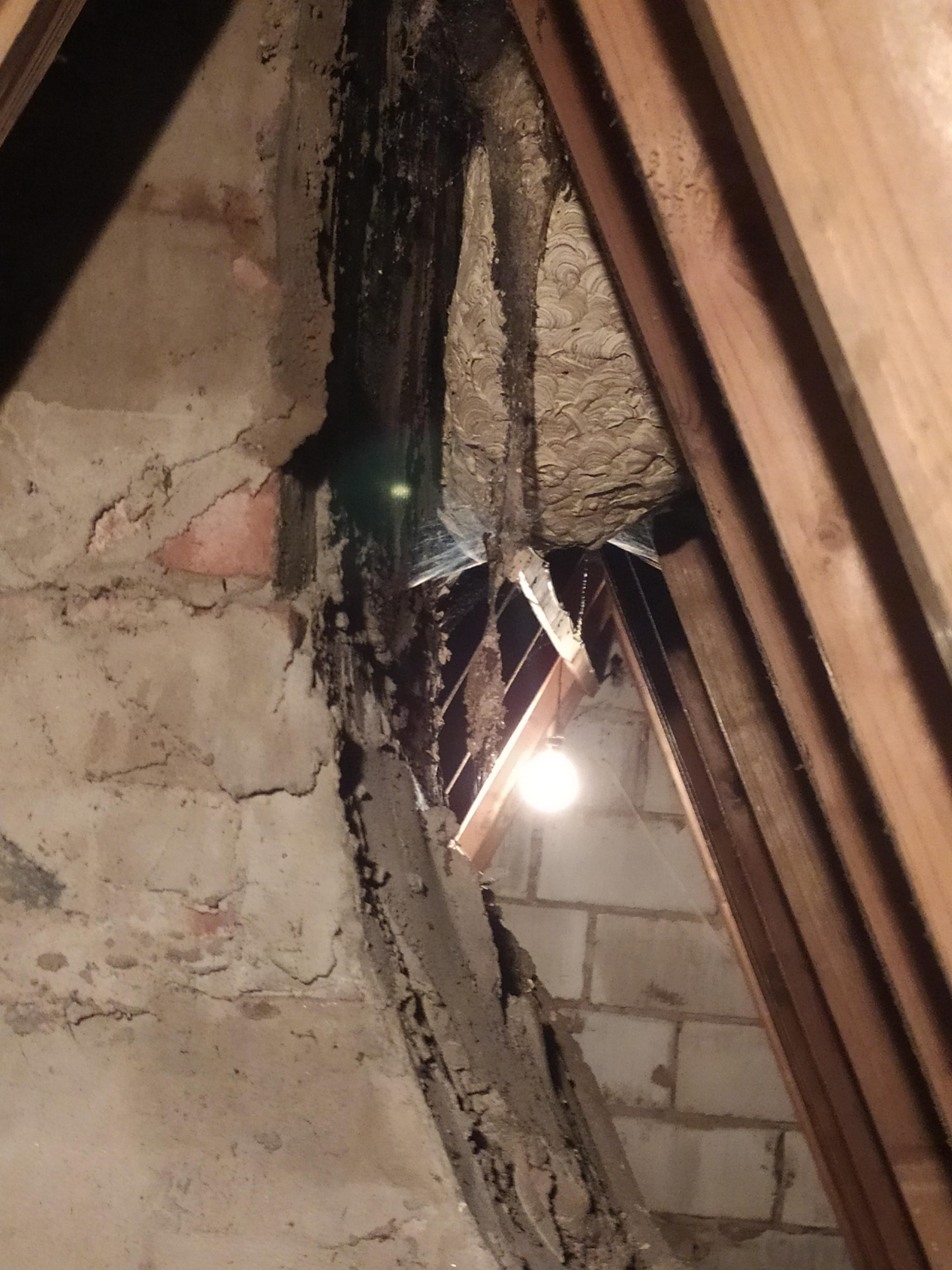

canalsiderenovation Posted April 21, 2020 Posted April 21, 2020 Just been up loft to discover this.... I think it's wasps, or could it be bees? It could be from last year when we had major issues with wasps which we put down to the fruit trees. I was walking around the loft and didn't see any wasps there but did a hasty exist. If they were there last year will it be more likely they will come back again to the same nest? Any good advice on how to get rid of it?
Jeremy Harris Posted April 21, 2020 Posted April 21, 2020 Definitely wasps. At this time of year it will almost certainly be an old nest from years gone by, and they rarely, if ever, re-use an old nest. If you do get a nest like this in an enclosed space, it's not generally a good idea to try and tackle it yourself. We had a problem with a big nest at our old house, and I got a chap in to deal with it, and watched how he did it. When we had another a year or two later I made up a remote gadget to spray powder in and kill them, which worked very well. I wrote it up here at the time:
canalsiderenovation Posted April 21, 2020 Author Posted April 21, 2020 3 minutes ago, Jeremy Harris said: Definitely wasps. At this time of year it will almost certainly be an old nest from years gone by, and they rarely, if ever, re-use an old nest. If that's the case I'll leave it and hope the builders will remove it when they deal with the roof.

A_L Posted April 21, 2020 Posted April 21, 2020 3 hours ago, canalsiderenovation said: Just been up loft to discover this.... I think it's wasps, or could it be bees? Its wasps, in our climate wasp nests are not multigenerational. They die out each autumn, there have been a small number of cases where nests were kept warm by displaced insulation and these were multigenerational but they a trivial in number. At this time of year a wasp nest is golf-ball sized with only an adult queen and larvae at most. Last years nest is full of disease because of disorganisation in the colony in autumn and new queens instinctively avoid them. Builders might adopt an 'ain't my problem' attitude as they will not understand/know its empty. You can just cut it down with a saw, it only paper mache, or if your nervous about it leave it to January when it will very definitely be safe. Adult wasps get at least some of their energy requirements from an excretion produced by their larvae, when the larvae die out in late summer/autumn the adults intensify their efforts to obtain sugars from fruit trees etc https://www.nhm.ac.uk/discover/what-do-wasps-do.html 1

canalsiderenovation Posted April 21, 2020 Author Posted April 21, 2020 Thanks all. I'm not too keen to give it a go but I'm glad it's more than likely to be empty. Perhaps if I'm feeling brave at the weekend I'll try and hit it away with a brush or something.

JFDIY Posted April 22, 2020 Posted April 22, 2020 Could you sheet off the area with clear plastic, both sides and floor seal off entirely. then cut a slit for access with a garden hoe or similar , then dislodge it and see if anything comes out, leave it for a few days then wrap up and remove from roof. I'd do all this with as much skin covered as possible. 1

joe90 Posted April 22, 2020 Posted April 22, 2020 I have cleared loads of wasps nests when re roofing houses, as long as I can’t see any wasps nearby!
