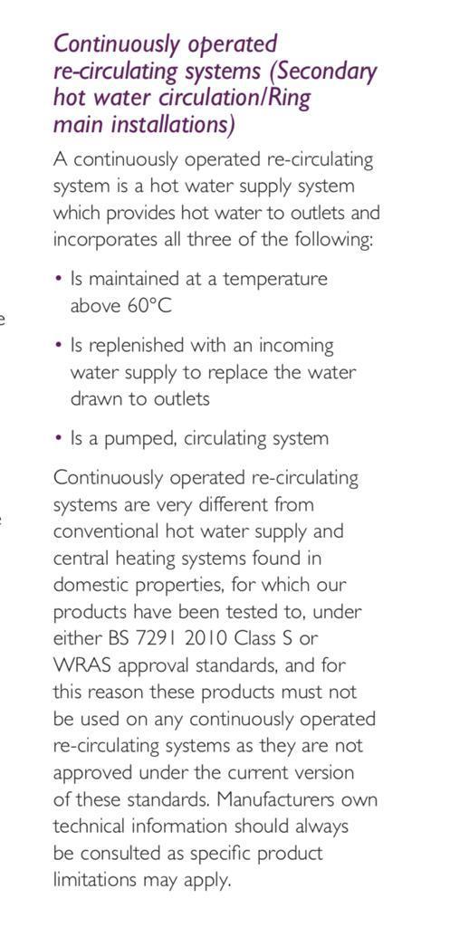

@Russdl That’s not a cast body - it’s a resin body by the looks of it so I would query the model number on the front as a resin body pump is suitable for potable water instead of a bronze body (and Wilo confirm this)
And Hep2O can be used as a hot water return circuit. You have (incorrectly) read the guidance and don’t understand the BS/ EN definitions and I have had this confirmed by Wavin.
For info the below is the definition they (Wavin) use for a hot water return circuit which you don’t meet on 2 of the 3 criteria so you have no issues.

4 hours ago, Russdl said:
Thats from the Wavin site, and Hep2O has been used in our hot return loop. As ours won't be continuously operating I think we're in the clear but it was going to be initially. I didn't really want a hot return circuit but the plumber cajoled me in to agreeing to one and came up with a simple solution to only make it run when the bathrooms are occupied.
it’s a decent solution tbh and one that actually makes sense. Got any photos of the install under the sinks or bath as would be interested if it’s in 15/10 or 10/10 etc.
