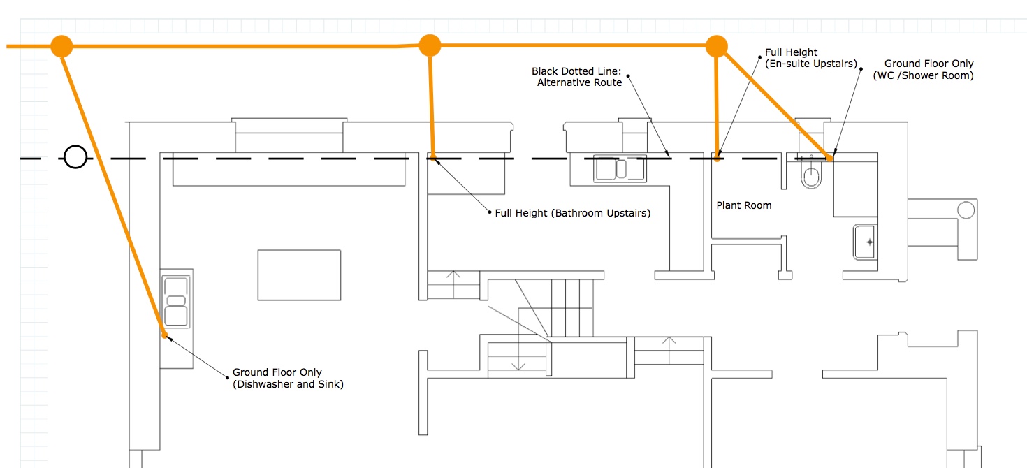

I've just been pondering my soil pipe locations.
Am I right in assuming that best practice is to take the soil run outside to a chamber as quickly as possible to aid rodding etc?
As you can see in the attached picture I've assumed that scenario, but could equally have a single run under the slab but that seems like a massive issue if there were ever a blockage.
I also assume that more soil pipe locations is much better than long lengths of 40/50mm waste?
All of the chambers shown are to the North of the property in a fairly narrow access strip so there are no asthetic issues at all.

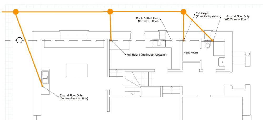

Here's the layout:
I have worked on 2 principals, keeping the soil/waste locations as close together to minimize travel and also to minimize penetrations into the shell.  That said I have kept it to 3 full size 110mm soil penetrations through the slab.  Two are close together because of a ground floor wet room shower forcing a second one near the main stack.  The third serves 2 en-suites and the kitchen.
Soil.pdf
If it were me I would run the pipe outside as you suggest Barney, others may differ but to run the pipe inside under concrete slab would be a major pain in the arse and mess up your rooms if anything went wrong. Imagine having a big hole punctured though your floor and how unpleasant it would look particularly guest are around at a seasonal time of the year, smell might penetrate into the house more also.
Consider flipping your WC and plant room so you only have one soil pipe instead of two.
The furthest soil pipe (e.g WC) generally has to be vented to the outside anyway, which might be an issue.
Otherwise I would stick with the orange lines.

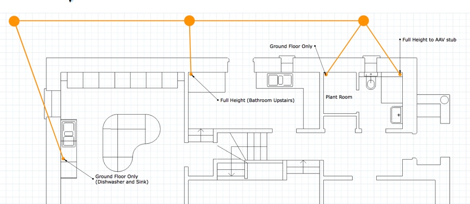

So does the AAV also have to be as high as possible or can the AAV be on a ground floor stub?
Answering my own question I see that McAlpine make an AAV which can be placed below the flood level.

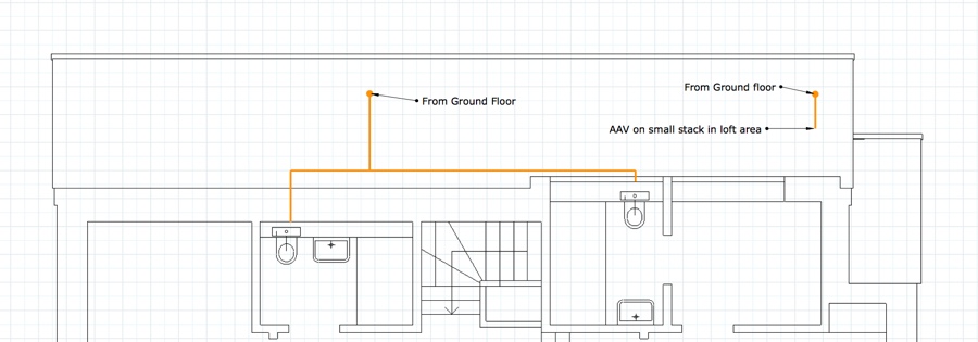

So I'm wondering if this is the best layout?
You can see that our ground floor is bigger than the upper so I have the roof/loft void for pipe runs.
I hate indoor soil pies, noisy, draughty big time, difficult to access or work on.
never have any drain in kitchen or utility, nightmare when gulley blocks, outdoor gulley, outside tap over it easy to clean, use accessible gulley and it can be Y'd into drain run.
re manholes and short pipes, I minimise manhole numbers, try to combine entries I think you only need one or possibly two inspection chambers.
I don't like aav at head of run,prefer vent
I don't think you will get away with an AAV where you have indicated.
Usually furthest away from the mains sewer your building control officer will want to  see it vented to the outside.
