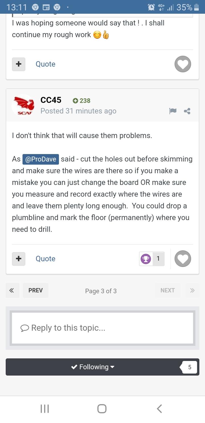

zoothorn Posted May 19, 2020 Author Share Posted May 19, 2020 26 minutes ago, PeterW said: You won't notice 5mm but thats your call - I know what I would be doing. Understood. Unfortunately I think your idea came a bit late, I'd put alot of time & searching on the 12.5mm avenue I was driving on that route. I can only go with what's ordered now.. at least I only have 1 layer. Is the idea to cut small holes for the light wires in the board before fixing up, & somehow pull it thru whilst getting board up (I cant see how I could, alone).. or mark/ drill a hole to leave it for electrician to enlarge/ find cable later? Link to comment Share on other sites More sharing options...
