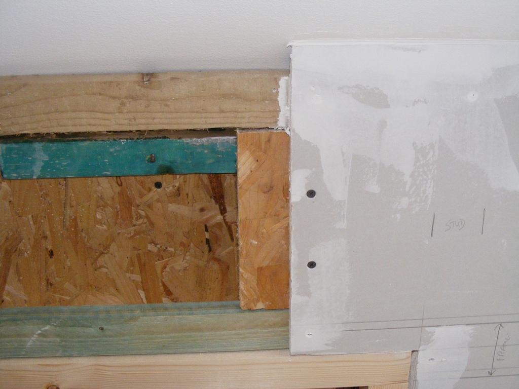

ProDave Posted May 14, 2020 Share Posted May 14, 2020 Re this nogin thing. Your issue appears to be you are nervous about how to attach them to the joists. Don't. This is what I have often done. Fix one board. That will leave the tapered edges of the board unsupported. I then cut some bits of 6 by 1 timber that just fit between the jousts. Lay them one at a time on top of the board so they are half over the boad and half overhanging Screw through the plasterboard with 2 or more screws. that secures the "noggin" in place. Do this for all the gaps between the joists. Then when you put the next board up, screw through the edge again to catch the other side of the "nogin". Just don't push very hard when doing that or you could burst the first set of screws. All you are trying to do is support the otherwise unsupported joint to make it less likely you will get cracks. I might be doing a small biut like this later so I will take a picture to show it better. Link to comment Share on other sites More sharing options...
zoothorn Posted May 14, 2020 Author Share Posted May 14, 2020 @ProDave aha this seems a good compromise, I get the idea. So they just provide a stabler 'meet' of boards to preventing any shifting of the edges. I am going 12.5mm Fireline (straight-edge) boards though. Not T-Edge, so the boards maybe a bit sturdier on this long edge? (& BCO said Firelines are denser, so again sturdier than std 12.5mm). Still think I need any 'noggins' ? I'm loathed to call him up in case he says 'yup/ whole hog/ joist-fixed-nogs pls'.. & he cannot tell surely once the ceiling up, if I didn't do exactly this but instead go your idea. thanks, zoot Link to comment Share on other sites More sharing options...
ProDave Posted May 14, 2020 Share Posted May 14, 2020 Here you go, here is my "eezee nogin" method. So imagine my battens are the bottom of your joists. The plasterboard spans between the top (white) and bottom (green) battens leaving the edge unsupported. In this case I have used a bit of OSB as the "noggin" fixed with 2 screws through the edge of the plasterboard. When the next sheet goes on, 2 more screws fix through the edge of that into the "noggin" Just be careful not to press hard with the screwdriver. It might be best to do those by hand rather than an electric driver and just let the screws bite and pull themself in. Link to comment Share on other sites More sharing options...

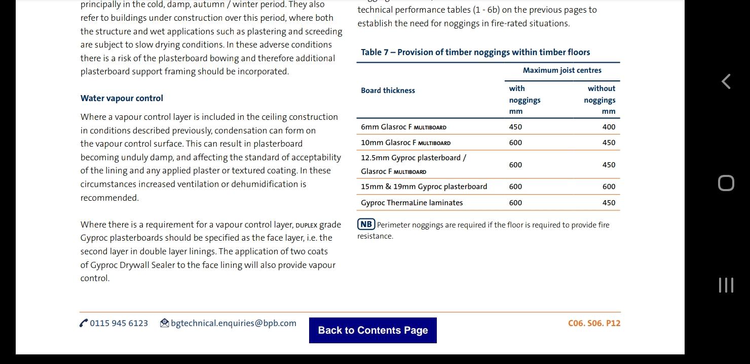

Onoff Posted May 14, 2020 Share Posted May 14, 2020 As to whether noggins are required: This from the British Gypsum White Book. 1 Link to comment Share on other sites More sharing options...
zoothorn Posted May 16, 2020 Author Share Posted May 16, 2020 @Onoff ok just seen this info- very informative. But I cannot make any sense of it, relative to the noggin suggestion you've been saying needs doing. This seems weird.. so likely not right. Or are you eluding to the fact that it says I do not need them, after all-?? Ok, unless I'm mistaken (highly probable) I read that I do not need noggins, with my 12.5mm board, looking at the table above, because it says 450mm Joist centres. And mine are 400mm (and surely they're being very wide @ 100mm is inherrant to the need, but this doesn't seem relevant). So I'm not sure either what you are eluding to the answer should be, or able to see any other info on the table that contadicts what you have been suggesting I do. So I am in a further heap of confusion. And so I'm quite sure this reply will make you go insane. Could you not say "look.. it says you need noggins" ? then I could ask 'I don't see that, can you explain for me? because doesn't it tell me that -I don't- need noggins?' (then you might answer 'no.. because A, B, C'. I might then say 'Aha ok got it!! thx'). Link to comment Share on other sites More sharing options...

zoothorn Posted May 16, 2020 Author Share Posted May 16, 2020 Can anyone say whether that table tells me I need them or not? Ive looked at it for so long.. I just cannot understand. the wordings of these building tech tables/ seems utterly ambiguous to me. My joist centres are 400mm. As far as my brain can process, the table says only 6mm board requires noggins. Is this what Onoff is suggesting now-?? chrissakes this is doing my nut in. Link to comment Share on other sites More sharing options...
ToughButterCup Posted May 16, 2020 Share Posted May 16, 2020 46 minutes ago, zoothorn said: ... So I'm not sure either what you are eluding to the answer should be, or able to see any other info on the table that contadicts what you have been suggesting I do. So I am in a further heap of confusion .... Re-read Table 7 in @Onoff's response above. Look at the footnote to the table: You have 400 centres I think @Onoff might be suggesting you decide for yourself on the basis of the evidence he presents. I can confirm that the information he presents is accurate . Here is the link to the White Book ready for you to download Almost every single post in BH is offered in good faith. But after reading all the posts and thinking things through for ourselves, every one of us has to take sole responsibility for what we do on our build, unless we have consulted a properly qualified professional who carries the appropriate level of Professional Insurance . Link to comment Share on other sites More sharing options...
Onoff Posted May 16, 2020 Share Posted May 16, 2020 I had hoped you would pick up on the fire resistance bit. In essence the plaster should fill the gaps that your builder has left reinforced with joint tape. Simply put the joints will not be as secure against fire or hairline cracking as if noggined. Bottom line is you can generally do a better job yourself than many so called professionals. Do what @ProDave says. You have a solution. You could have done it by now. Link to comment Share on other sites More sharing options...
