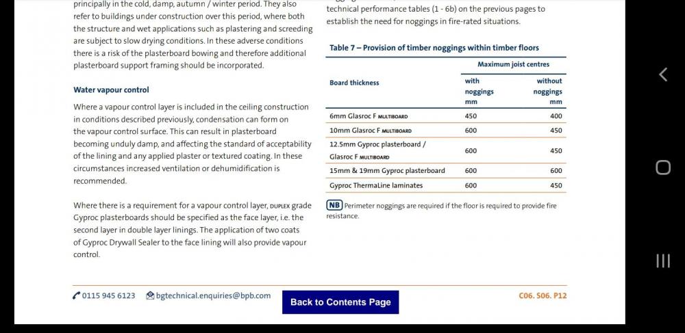

ADLIan Posted March 4, 2020 Share Posted March 4, 2020 The use of a vcl is shown in relevant Bldg Reg Approved Doc & British Standard (and I believe timber frame guidance from TRADA) Link to comment Share on other sites More sharing options...
andyscotland Posted March 4, 2020 Share Posted March 4, 2020 As I understand it a VCL is required - it can be done by taping the foil faces of the PIR across all the timber but that's a bunch of hassle and not as effective as a standalone layer. It's variously described as Vapour Control Membrane / Vapour Barrier / Vapour Check (with some arcane technical differences). You don't need any of the fancy expensive ones though for your purposes. A roll of DPM or similar heavy duty polythene is fine (semi-transparent is easier for seeing the studs etc for fixing boards but I think a bit more expensive). Given how susceptible timber can be to damage from moisture accumulating through condensation on the cold side of the insulation, and that you can get a roll of plastic fairly cheap and have it up in no time, I'd say it's a no-brainer. 1 Link to comment Share on other sites More sharing options...
zoothorn Posted March 4, 2020 Author Share Posted March 4, 2020 44 minutes ago, ADLIan said: The use of a vcl is shown in relevant Bldg Reg Approved Doc & British Standard (and I believe timber frame guidance from TRADA) Hi ADLlan, I'm sorry but can you translate this? (is relevant, or in relevant.. is there a typo here: if so "is relevant" means the sentence makes sense, & suggests [but only a suggestion- nothing definitive] that the vcl is needed). As it is "the use of a vcl is shown in relevant.." doesn't make a logical sentence: I wouldn't be surprised if this is worded exactly like so, wherever this is from. Christ why can't this building stuff be comprehensible!?! its absolute insanity. Link to comment Share on other sites More sharing options...

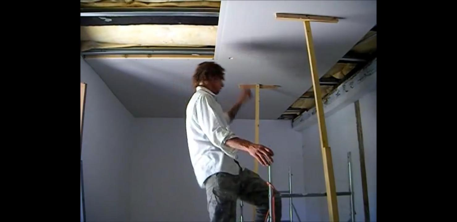

Onoff Posted March 6, 2020 Share Posted March 6, 2020 This sort of thing. Still from a YouTube vid. Bloke's doing it on this own. He's standing on a hop up of some sort. T bars are made to such a height so they "wedge" near vertical. Best to have two people. It's a bitch when on your own and a T bar slips and falls and the board comes crashing down. Loads of ways to do it. Watch YouTube vids! Link to comment Share on other sites More sharing options...
