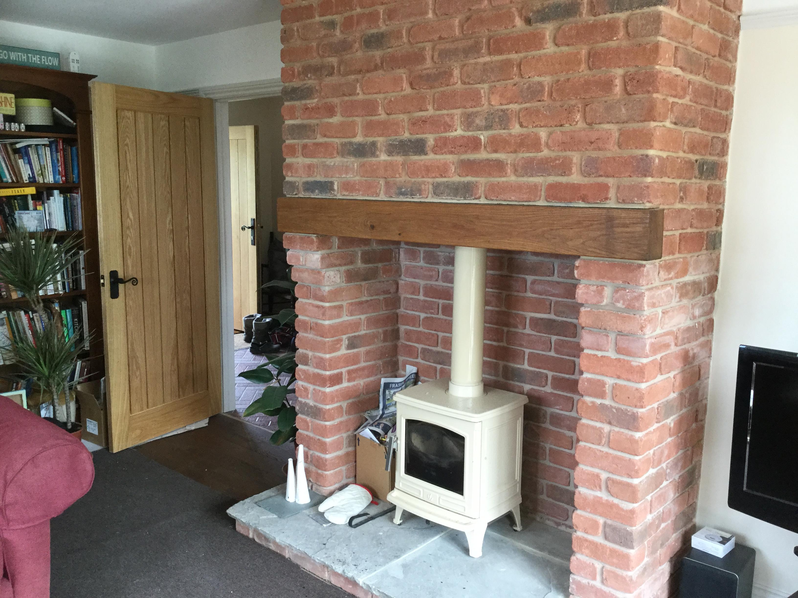

epsilonGreedy Posted March 2, 2020 Share Posted March 2, 2020 (edited) My brick laying team is nearly ready to build the basic structural skeleton of the fireplace and chimney above. The chimney breast is internal i.e. the outside wall is flat so the depth of the fireplace is formed by its intrusion into the room. The room is 17ft x 19ft and the width of the fireplace is decent at 1.6m. The stoves I am looking at are around 400mm deep. We also like a higher than average mantle to give a hint of the inglenook fireplace style. Edited March 3, 2020 by epsilonGreedy Link to comment Share on other sites More sharing options...
Temp Posted March 3, 2020 Share Posted March 3, 2020 Check the building regs (Approved doc J) as they specify things like the gap behind a stove and the minimum projection of the hearth in front. So you might find the minimum depth is determined for you. For ease of construction choose a stove with feet that the maker certifies cannot raise the hearth over 100C. Approved doc J is hard to follow until you realise some bits apply to stoves that are certified and others to stoves and fire baskets that aren't. Link to comment Share on other sites More sharing options...
nod Posted March 3, 2020 Share Posted March 3, 2020 We did ours 600 deep While you cancan be restricted by how close to the back and sides you site the WB Purchasing a double skinned WB will allow to site it very close to the wall Also worth remembering that the timber mantas is longer allowed to encroach int the chimney breast Link to comment Share on other sites More sharing options...

epsilonGreedy Posted March 4, 2020 Author Share Posted March 4, 2020 On 03/03/2020 at 06:07, nod said: We did ours 600 deep While you cancan be restricted by how close to the back and sides you site the WB Purchasing a double skinned WB will allow to site it very close to the wall Also worth remembering that the timber mantas is longer allowed to encroach int the chimney breast 600 sounds about right. We like this example from a Potton show home though without an external chimney breast we won't have anything like the same depth. And here is another example, which also features a mantle beam installed above a typical height. https://www.bookcottages.com/cottages/100-UKC1537-gorse-cottage.htm Link to comment Share on other sites More sharing options...

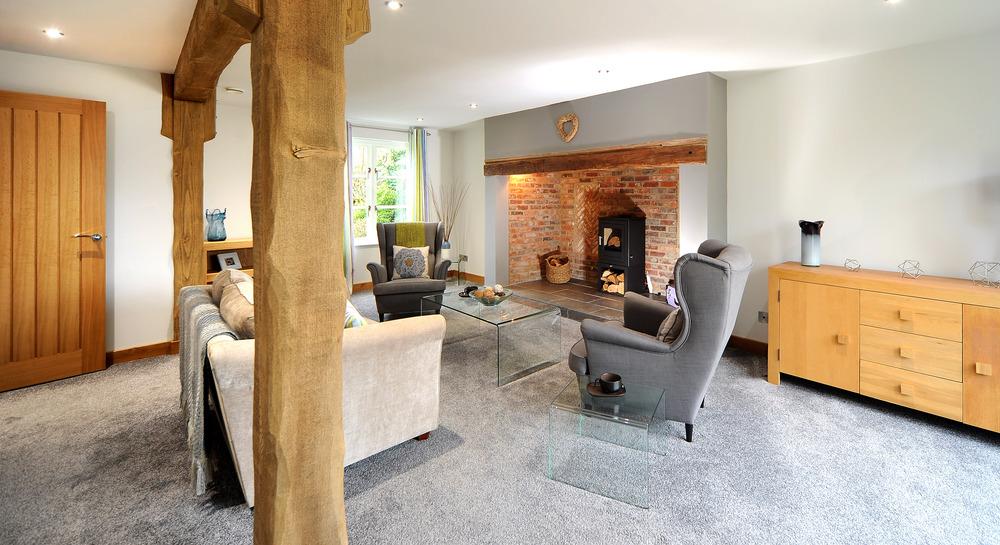

patp Posted November 3, 2020 Share Posted November 3, 2020 We, too, are at the stage where we need to choose our fireplace and woodburner options. Our chimney is going to be external and the brickie is asking us for dimensions of the internal part. This means we have had to go looking at woodburners. We have had one before in our old cottage but this is a new build so I am struggling to marry new fireplace with old style wood burner. The modern looking ones seem to all be sited free standing in a room. There is an amazing stove seller near us who has lots of makes to choose from but recommends Heta. Any one had a Heta? They do seem very good quality (Danish?). The array at the warehouse is immense. Went in looking for modern cylindrical and came out thinking of a more traditional style but with a log store underneath. The store gave sensible guidance on ease of opening the door and emptying the ash can for us oldies (cheek!). Link to comment Share on other sites More sharing options...

epsilonGreedy Posted November 3, 2020 Author Share Posted November 3, 2020 In the end we treated ourselves to a short break in Ludlow and spent a few hours looking around the Clearview stoves showroom. The showroom is based in a Georgian era house which provided inspiration for the style of our newbuild, the staff there are very knowledgeable. If depth constrained we noted that a stove can project 50mm forward of the face of the chimney breast. The staff at clearview talked us down from a large stove and said anything over 8kw is nuts in a new build. Treat the low end of kW output ranges with a pinch of salt. We demolished our first chimney breast and rebuilt after our showroom visit. Have you sorted out the technicalities of the air feed? Link to comment Share on other sites More sharing options...
