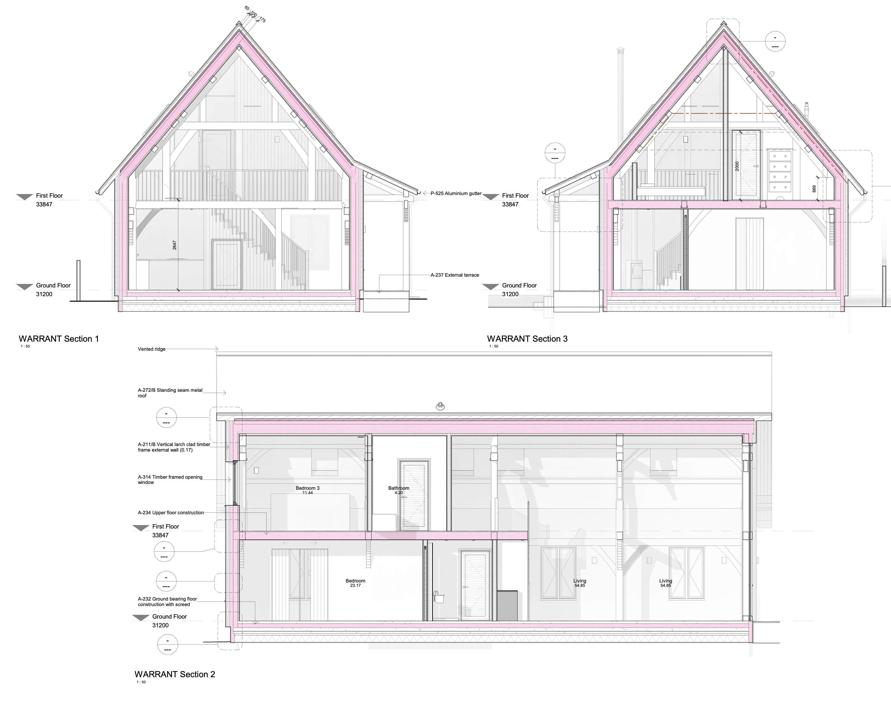

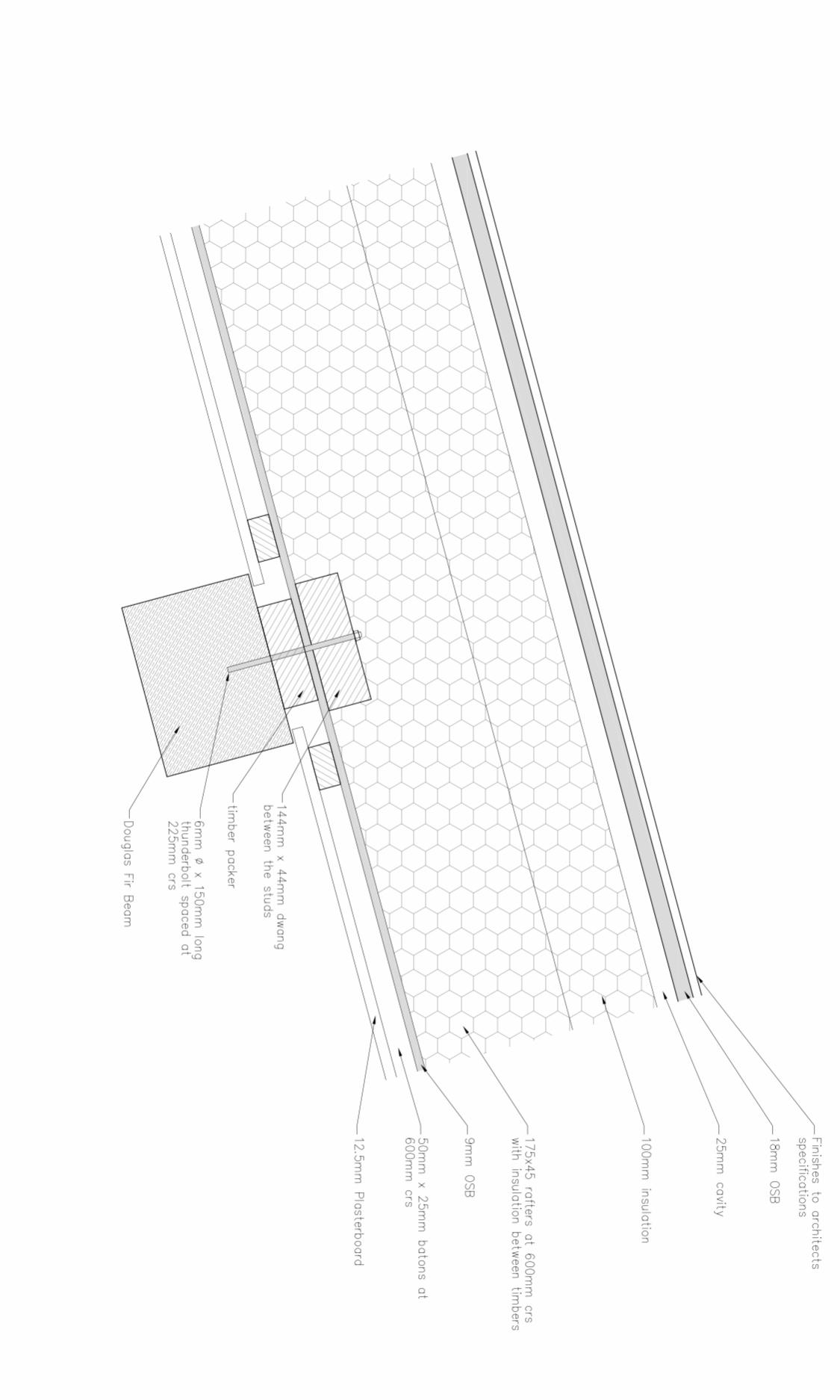

Simplysimon Posted February 25, 2020 Posted February 25, 2020 could you post a make up of the wall and finishes?
Joanna Susskind Posted March 13, 2020 Author Posted March 13, 2020 On 25/02/2020 at 18:33, Simplysimon said: could you post a make up of the wall and finishes? Finally got the drawing! Wood fibre order has now been placed!
ProDave Posted March 13, 2020 Posted March 13, 2020 ^^ No vapour control / Air tight layer? What external finish?

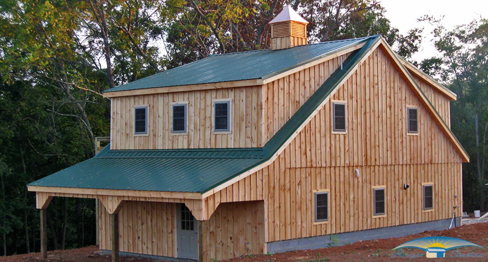

Joanna Susskind Posted March 13, 2020 Author Posted March 13, 2020 On 22/08/2019 at 14:14, the_r_sole said: who's your engineer for the project? do GCC give you soil test/trail pit results with the plots or have they already tamed engineers to deliver on the plots? It's an interesting design that you've gone for, it's very rural in character - is your big window looking to the canal? 46 minutes ago, ProDave said: ^^ No vapour control / Air tight layer? What external finish? The OSB provides the airtightness. There isn't any requirement for a membrane with our insulation... Attaching PDF with full details here. Board & baton larch cladding on the outside. Like the attached image... Timber_frame_techincal_manual.pdf
Joanna Susskind Posted March 13, 2020 Author Posted March 13, 2020 On 24/02/2020 at 16:06, MikeGrahamT21 said: Have you contacted the manufacturer directly? I don't know how many packs 150m2 comes to, but they may sell to you direct? This worked out really well! Found someone who's selling direct and got a massive discount on delivery... thanks! 1 1
ProDave Posted March 13, 2020 Posted March 13, 2020 3 minutes ago, Joanna Susskind said: The OSB provides the airtightness. There isn't any requirement for a membrane with our insulation... Attaching PDF with full details here. Board & baton larch cladding on the outside. Like the attached image... Timber_frame_techincal_manual.pdf 3.55 MB · 0 downloads Our design was the same, but while OSB can provide the air tightness, I was not convinced it was enough as the vapour barrier so I chose to add an air tight / vapour tight membrane over the OSB on the inside.
ADLIan Posted March 13, 2020 Posted March 13, 2020 +1 @ProDave From BS 5250 vapour resistance of 13mm OSB is approx 7 MNs/g. Compare to vapour resistance of 0.12mm (500g) polyethylene sheet at approx 250 MNs/g. This would be classed as a (A)VCL - the OSB offers little resistance.
