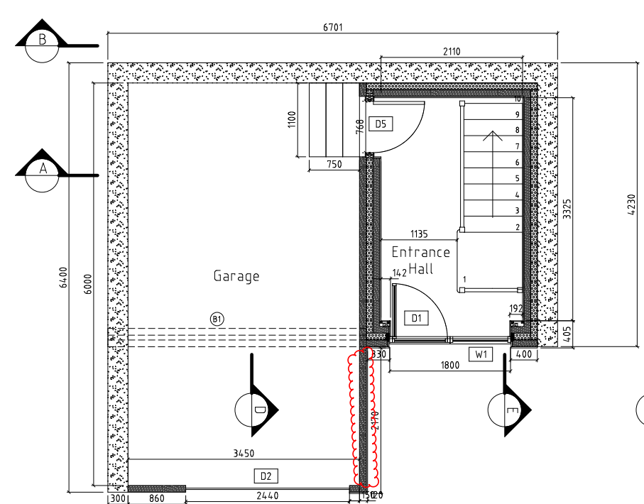

Moonshine Posted February 21, 2020 Posted February 21, 2020 I am looking at potential locations of recessed meter boxes, and the best place for them to be would be in a single skin wall located between external and the garage at entrence level, as per the red cloud below. The problem is that the meter boxes are typically ~210mm deep, (150mm into the wall https://www.tlc-direct.co.uk/Technical/DataSheets/Mitras/MBEB1_Datasheet.pdf) so with 100mm block and 20mm render, these would be sticking out into the garage by 30mm. Would this 30mm overlay be o.k and the back of the box visible, or would it need stud work to cover it in the garage? and also a exit path for the cables to the consumer unit. If so the single skin of block work could move 50mm to the right to allow for a stud batten to be fixed to the block and plasterboard over, thus keeping the same line as the internal wall of the garage. same issue with the gas meter box

Moonshine Posted February 21, 2020 Author Posted February 21, 2020 5 minutes ago, joe90 said: Can’t you mount it to the left of the garage door so it not by the front door? unfortunately not as that space will have 'stuff' in front of it. 1

Mr Punter Posted February 21, 2020 Posted February 21, 2020 Build the wall in 140mm blocks. They are better if you need to cut deep chases as well.

Jeremy Harris Posted February 21, 2020 Posted February 21, 2020 We had the same, SSE refused to allow a new supply head and meter inside the house. One of the issues I had was how to avoid the thermal bridge that putting a ~150mm deep cabinet in an external wall would create. For us it would have meant about a 40% reduction in insulation where the cabinet was, had we set it into the house wall. This, more than anything else, drove the decision to use an external meter cabinet, located in a fence, and run a thick cable from there into the house.
