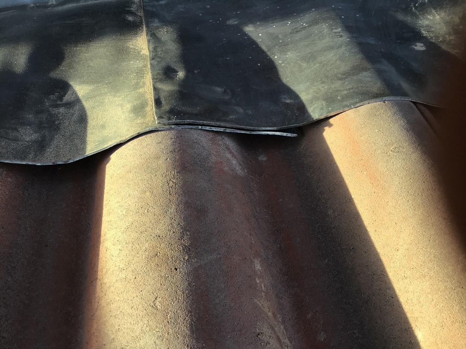

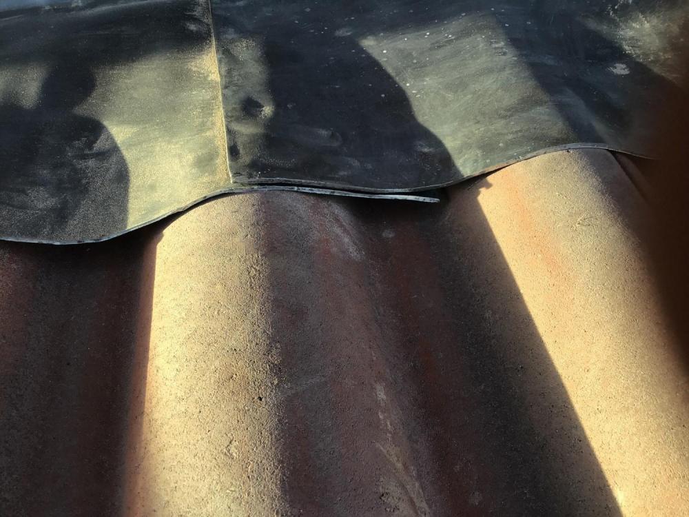

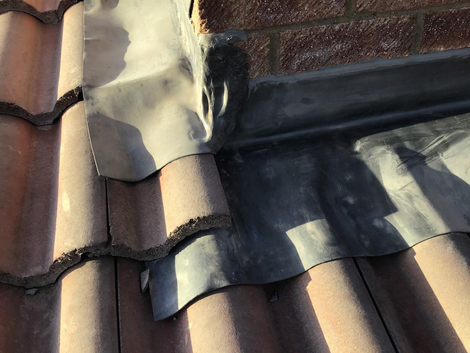

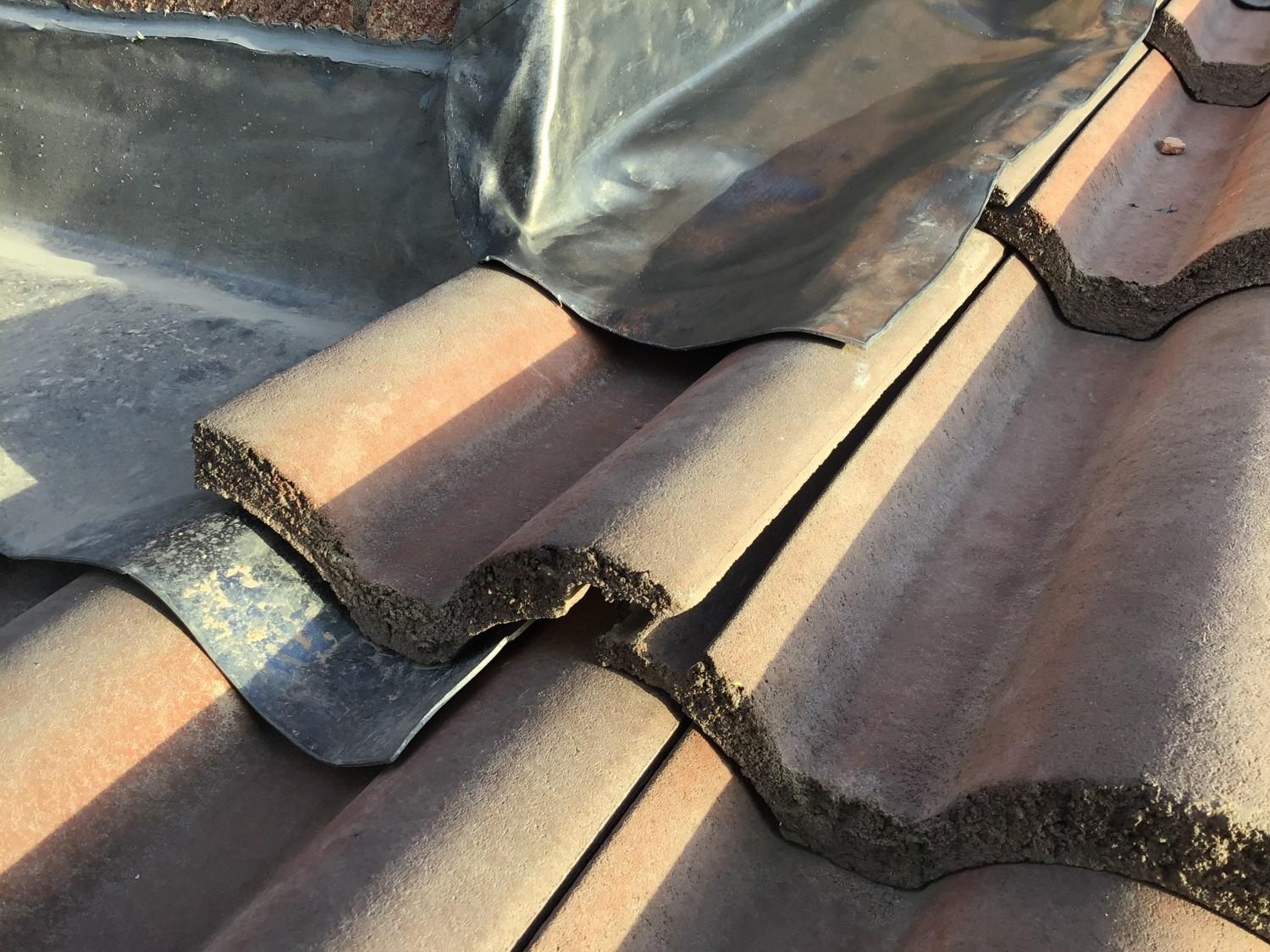

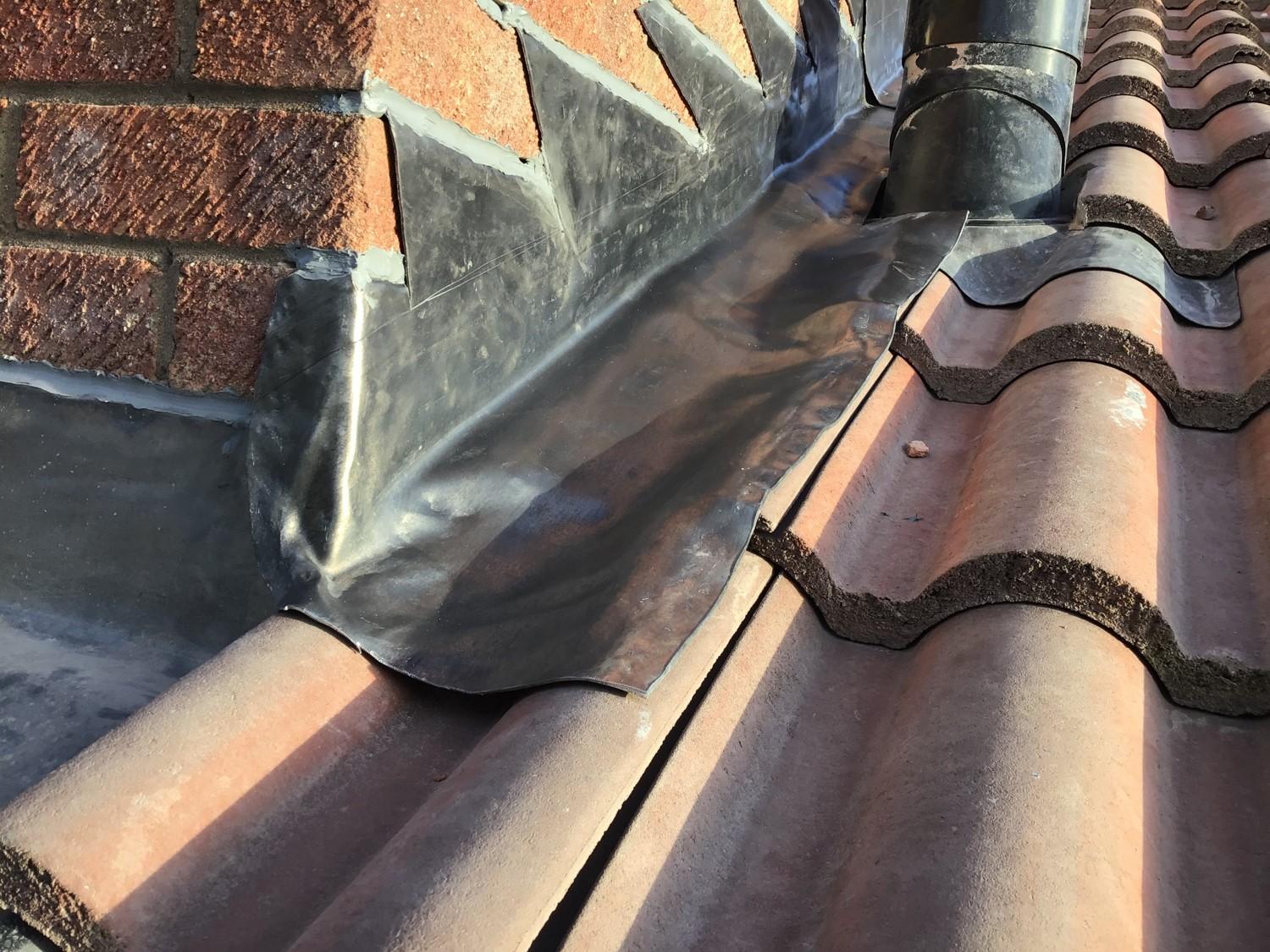

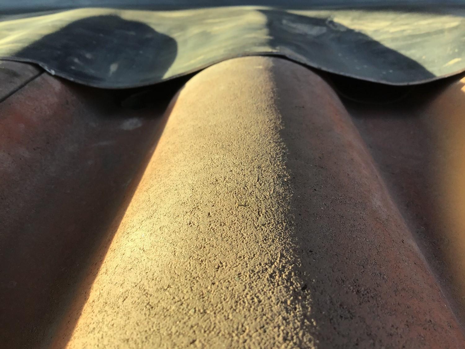

wozza Posted February 16, 2020 Share Posted February 16, 2020 (edited) Hi All, Had a roofer quote us for around 30 meters of Lead flashing a couple of months ago - he turned up this week and did the job. When he viewed the job, we spoke for a while and one of the last things I said to him was "so you will use code 4 lead,? you will do a neat and tidy job? and the lead will be tight on the tiles?" he replied yes. He turned up this week and did the job and I am shocked at the quality of work. They have broken at least 8 roof tiles, the corners of the lead look terrible, the lead is not dressed tight onto the tiles so its not weather and vermin proof and finally as I found out last night (thanks to storm Dennis) one of the overlap joints leaks. I asked him about the broken tiles and he said that some were already broken -there was only one - and that his lads went round changing the broken ones - the only tiles available to change them with was my pile of tiles with broken corners, missing lugs etc. I know that it inevitable that tiles will get broken when working on a roof, but to leave them broken and / or use my tiles is poor. I asked him why the lead was not dressed down tight onto the tiles - he said that the old lead was code 3 and that the new code 4 lead will split and need welding if he tries to dress it down onto the tiles, this I believe to be unacceptable as wind, rain, snow, birds, insects etc can easily get in. I asked about the corners and he said that he could come back and put them right - wait until you see the pics. He does not know about the leak as we found it last night - I have proven it was the overlap as I got very wet covering it up - the leak stopped once covered. I have not paid him anything. What are my options - do I legally have to let him try to put it right? I think I have lost faith in his ability and do not want to let him back onto my roof. Thanks Wozza. Edited February 16, 2020 by wozza Link to comment Share on other sites More sharing options...

bassanclan Posted February 16, 2020 Share Posted February 16, 2020 Terrible job You should give him the chance to put it right as it sounds like he let his workers/subbed do it. I would write a formal letter explaining everything you think is wrong. I'm not 100% that is even code 4 lead. Link to comment Share on other sites More sharing options...
Danny68 Posted February 17, 2020 Share Posted February 17, 2020 This guys a cowboy ,if it was my roof I'd be tempted to tell him to go forth and multiply but with age I've learnt to think twice before opening my mouth .if you know hes a local builder traceable I'd tell him the works shoddy he's not getting paid and take photos and give him the chance to sue you ( he won't ) but if you only have a mobile contact then the chance of getting a brick through the window or your car scratched quite frankly isn't worth the hassle ,offer to pay half wipe your chin and get someone proper to do it or have ago yourself . Link to comment Share on other sites More sharing options...
ToughButterCup Posted February 17, 2020 Share Posted February 17, 2020 Get a quote from a reputable company to put it right. Deduct that amount from his bill, or he puts it right on his own. Link to comment Share on other sites More sharing options...
Cpd Posted February 17, 2020 Share Posted February 17, 2020 It’s a terrible job. If possible try and find an off cut and see what thickness it is, it look thin.... I hope you can get it resolved without to much trouble..... make sure you have photos of what it should look like, scour some internet images and get them printed off so that you can clearly show what a professional job should have looked like. Also include some diagrams if possible. Link to comment Share on other sites More sharing options...
Mr Punter Posted February 17, 2020 Share Posted February 17, 2020 Just awful. Get a proper leadworker in to redo it. Link to comment Share on other sites More sharing options...
Gone West Posted February 17, 2020 Share Posted February 17, 2020 On the fourth picture showing the chimney? flashing shouldn't the cut by the vertical pipe be tucked under the pipe flashing? It's not been dressed at all and is appalling. It's so disappointing when so called professionals carry out work so badly. It's the reason I ended up doing so much of my build myself. 1 Link to comment Share on other sites More sharing options...

MikeSharp01 Posted February 17, 2020 Share Posted February 17, 2020 Yep it is a terrible job and does not meet any of the leadwork standards. Some good examples here. https://leadsheet.co.uk/service/rolled-lead-sheet-the-complete-manual/ Link to comment Share on other sites More sharing options...
makie Posted February 19, 2020 Share Posted February 19, 2020 I'm a roofer and a lead worker. It is an awful job and needs fixed by someone that actually knows what they are doing. Get 3 quotes from other roofing/lead companies and don't let that guy near your roof again. If he requests let him collect his scrap lead when the job is redone 1 Link to comment Share on other sites More sharing options...
