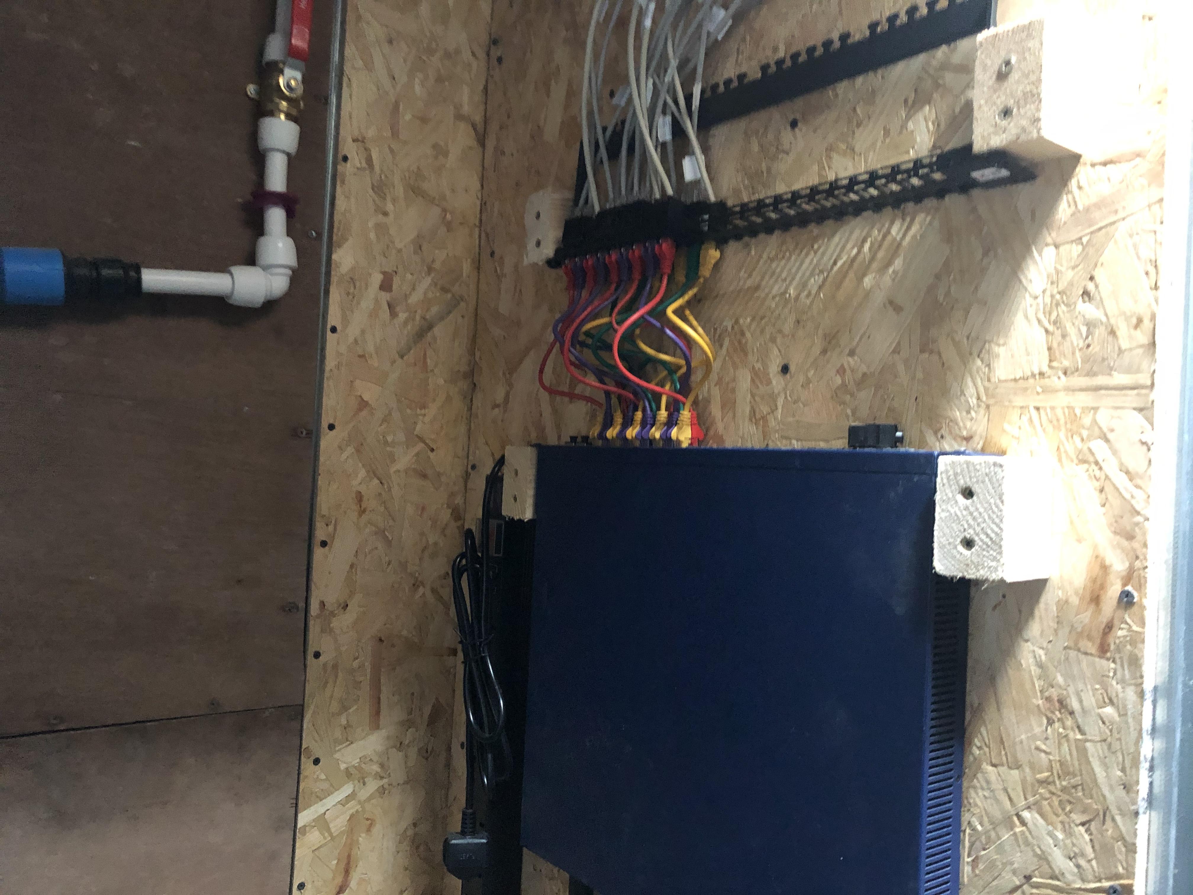

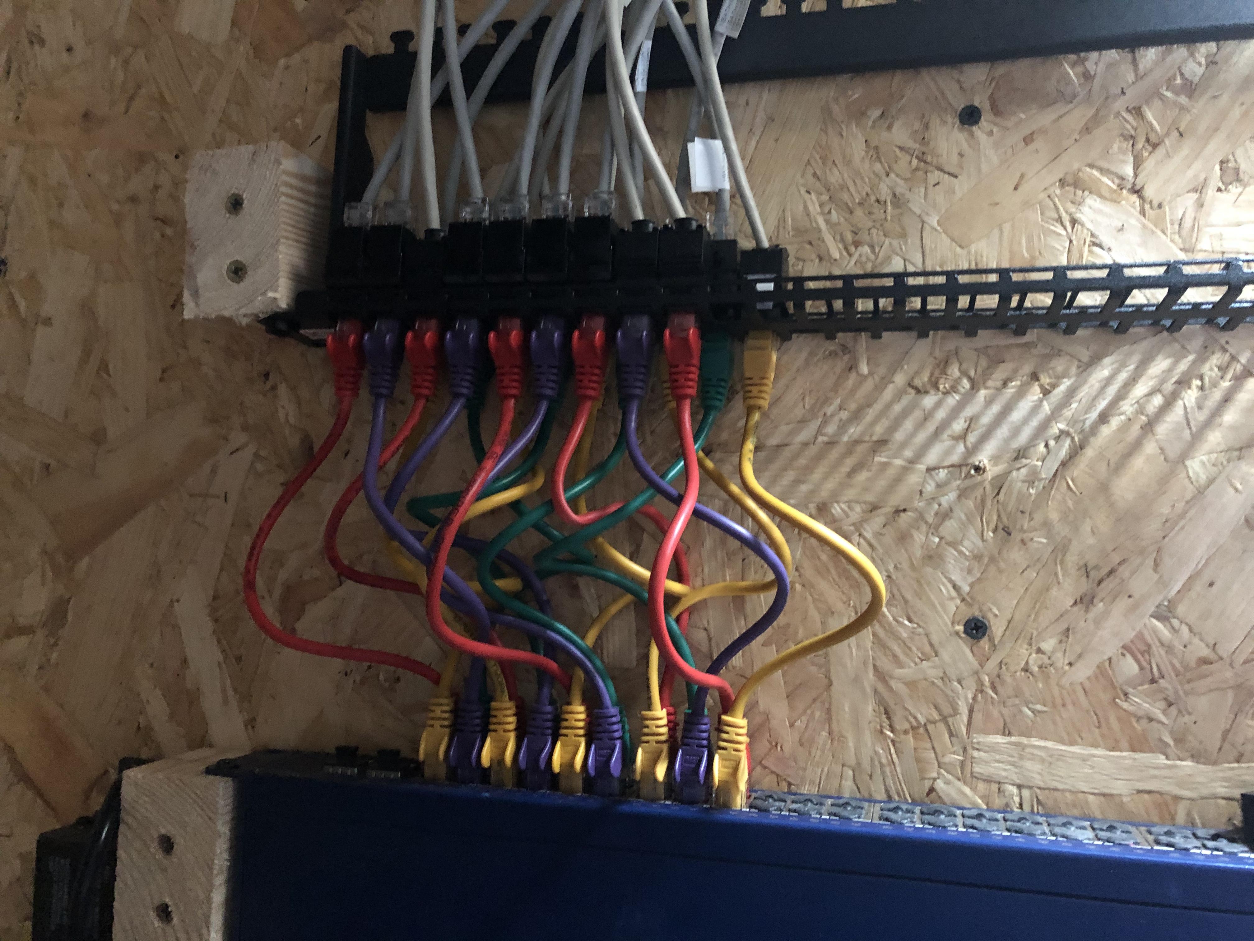

Pocster Posted February 13, 2020 Author Share Posted February 13, 2020 Almost half the cat5 cable in . Pretty colours help ! 1 Link to comment Share on other sites More sharing options...
ProDave Posted February 13, 2020 Share Posted February 13, 2020 Okay I will bite. Why the termination strip and patch leads? I would have just crimped an RJ45 onto the end of each cable and plugged them straight into the switch. That's all I have done with the few I have in use. Link to comment Share on other sites More sharing options...
Pocster Posted February 13, 2020 Author Share Posted February 13, 2020 19 minutes ago, ProDave said: Okay I will bite. Why the termination strip and patch leads? I would have just crimped an RJ45 onto the end of each cable and plugged them straight into the switch. That's all I have done with the few I have in use. ? Some cables are crimped as stranded cat5 ; some or keystones as solid core cable . I prefer the patch board as it means the cables won’t hopefully get moved - so any unplugging etc . Done by patch cables ( pre bought ! Didn’t fancy making them ) Link to comment Share on other sites More sharing options...
Mr Punter Posted February 13, 2020 Share Posted February 13, 2020 24 minutes ago, ProDave said: Okay I will bite. Why the termination strip and patch leads? I would have just crimped an RJ45 onto the end of each cable and plugged them straight into the switch. That's all I have done with the few I have in use. I like the patch panels as they tidy all the cables away. I have mine flush with the plasterboard. You can adapt to phone and poe where needed. 1 Link to comment Share on other sites More sharing options...
Pocster Posted February 13, 2020 Author Share Posted February 13, 2020 7 minutes ago, Mr Punter said: I like the patch panels as they tidy all the cables away. I have mine flush with the plasterboard. You can adapt to phone and poe where needed. This is all in my man cupboard. Flush cables to the wall is just too much ?. As long as it’s manageable and obvious which cables goes where I’m happy . This cupboard does not need SWMBO approval !! ??? Link to comment Share on other sites More sharing options...
joth Posted February 13, 2020 Share Posted February 13, 2020 3 hours ago, pocster said: ? Some cables are crimped as stranded cat5 ; some or keystones as solid core cable . I prefer the patch board as it means the cables won’t hopefully get moved - so any unplugging etc . Done by patch cables ( pre bought ! Didn’t fancy making them ) Yeah if you're using solid core runs, the patch panel is the place to convert to stranded cables. Ideally the solid cores then will never have to be touched or moved again and can last decades. Analogous to why in a lighting circuit you have a ceiling rose rather than drop T&E to the pendant, say 1 Link to comment Share on other sites More sharing options...
