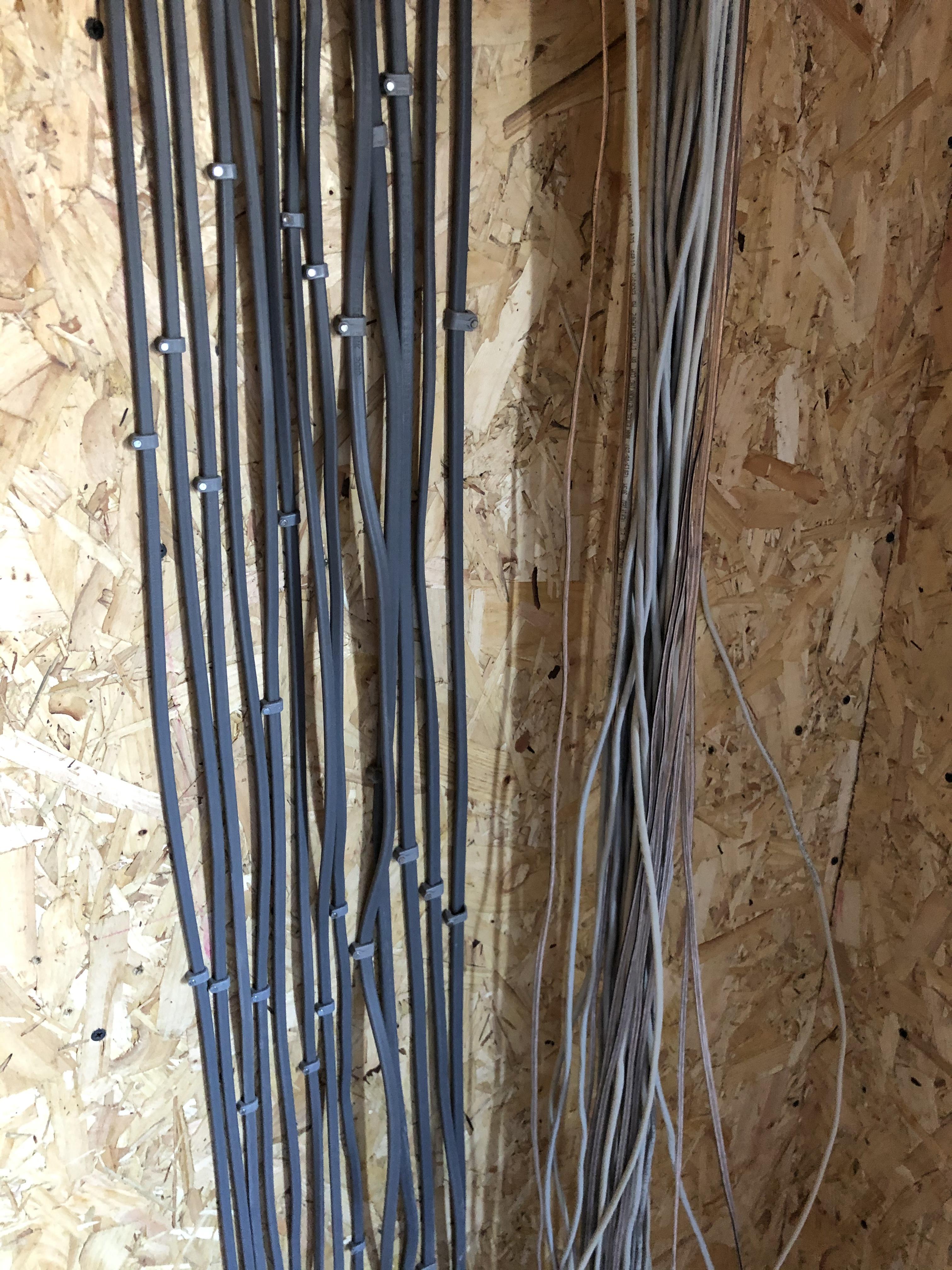

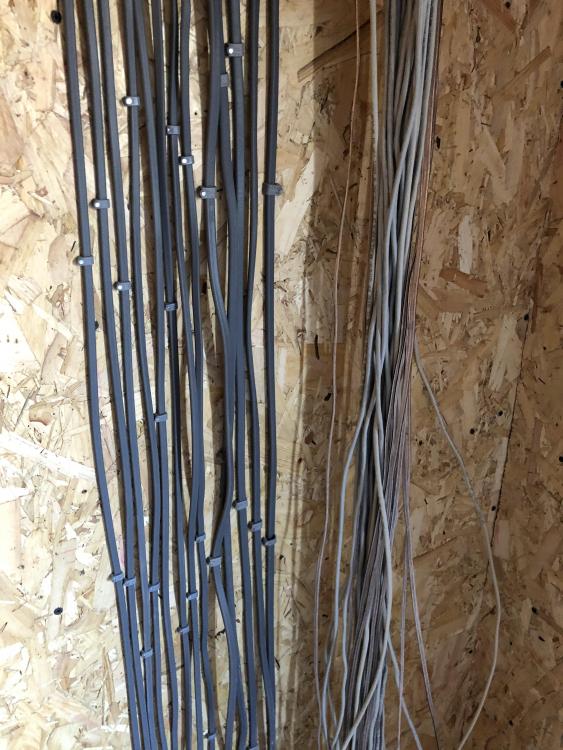

Pocster Posted February 6, 2020 Share Posted February 6, 2020 Think I’ve done all the wiring for the above ground floor . Bit of a nightmare if there’s an issue . Going to start wiring up the 50 or so cat5 cables ? ; boredom will become king ! It is indeed the Devils Corner !! Link to comment Share on other sites More sharing options...

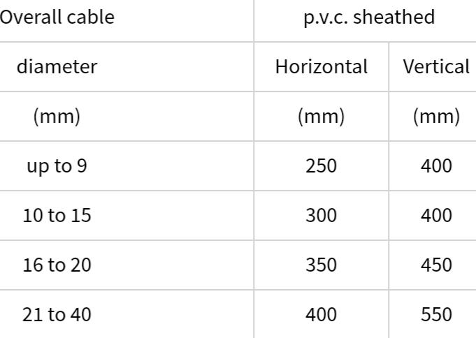

Onoff Posted February 6, 2020 Share Posted February 6, 2020 ? 1 Link to comment Share on other sites More sharing options...
Pocster Posted February 6, 2020 Author Share Posted February 6, 2020 2 hours ago, Onoff said: ? What's this nonsense!!! Link to comment Share on other sites More sharing options...

Jeremy Harris Posted February 6, 2020 Share Posted February 6, 2020 I put in 8 Ethernet cables and really should have doubled every run, as there have been a couple of times I could have done with two connection instead of one. I'm inclined to agree that you can't have too many Ethernet cable runs, especially as the cable is pretty cheap. BTW, I think @Onoffs post about minimum cable clip spacing may have gone "whoosh" overhead. . . (hint: Those cables need to be tidied up and clipped properly, in accordance with Appendix D of the OSG and also, perhaps, Section 522.10 of BS7671:2018) 1 Link to comment Share on other sites More sharing options...

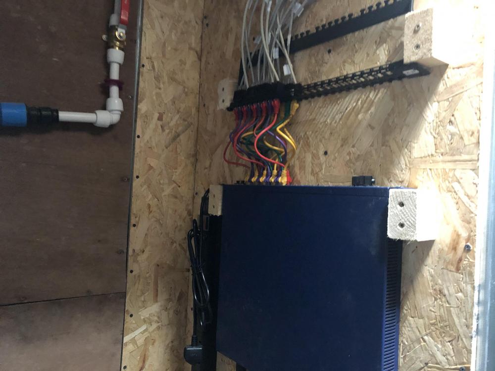

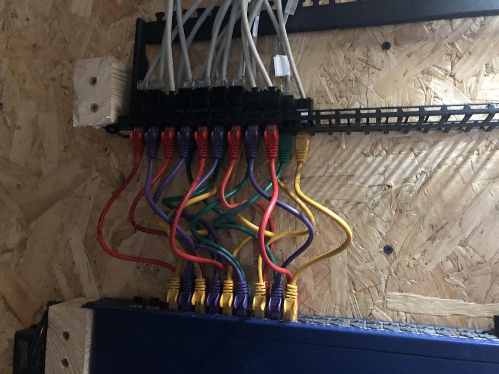

Pocster Posted February 7, 2020 Author Share Posted February 7, 2020 1 done and tested . 49 to go ? 1 Link to comment Share on other sites More sharing options...

Carrerahill Posted February 7, 2020 Share Posted February 7, 2020 19 minutes ago, pocster said: 1 done and tested . 49 to go ? You put me to shame, I wired our place for network about 5 years ago and they are still all just hanging in the comms cupboard! 1 Link to comment Share on other sites More sharing options...
