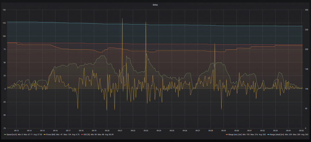

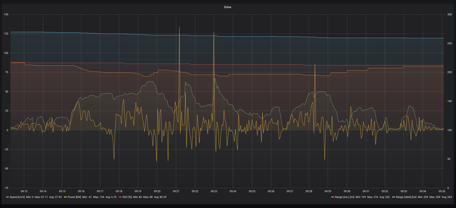

We effectively "sequester" about 0.9 tonnes of CO2 per year, by generating zero carbon power that's exported to the grid, and used by the house in place of power supplied by the grid.  That's about 0.245 tonnes of carbon per year.  I've not worked out the impact of my car yet; need to get a feel for the proportion of energy it uses that will come from self-generated, zero carbon, energy.  Car energy use is interesting, especially at this time of the year when the weather's a bit cool.  This is the data from my ~10 mile trip to the supermarket yesterday:
This data wasn't taken from the car directly, it was retrieved from Tesla's server, and is just a tiny bit of the telemetry between the car and Tesla that is running all the time the car is online.  For the power fanatics, the peak power used on that trip was 134 kW (~179hp), the minimum power was ~ -41 kW (~ -55hp) and the average power for the trip was 6.75 kW (~ 9hp).
Link to comment
Share on other sites
4 minutes ago, SteamyTea said:
Don't they put axis labels on.
The data's been plotted with Grafana running on a Raspberry Pi, and there are axis labels if you look closely.  The legend's at the bottom, and the left Y axis is speed, power and SoC, the X axis is time and the right Y axis is range remaining in miles.
