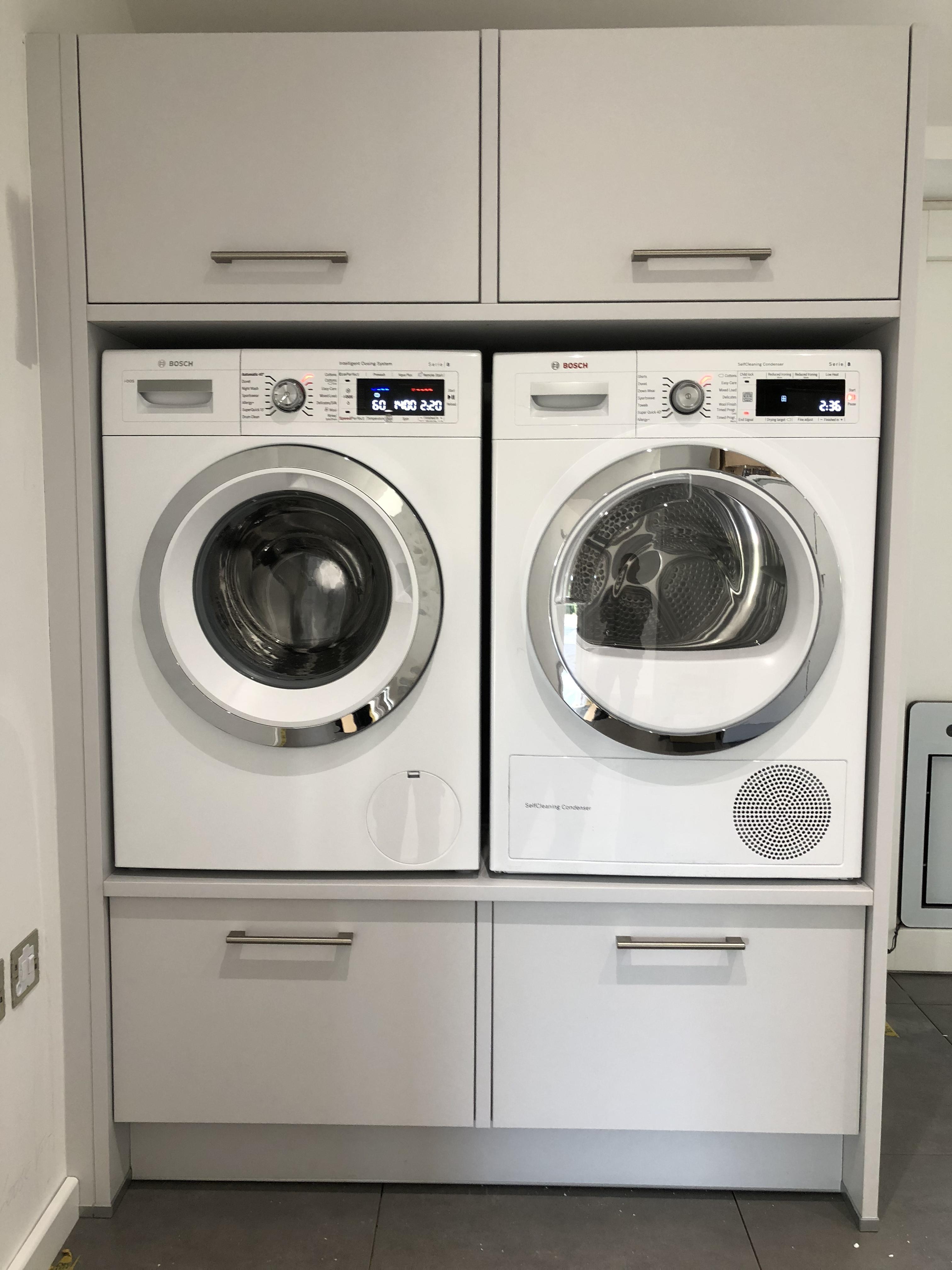

Barney12 Posted January 20, 2020 Share Posted January 20, 2020 55 minutes ago, epsilonGreedy said: After 8 months I have concluded this raised plinth is a good idea because it eases access to the drum and the dryer, now I want to incorporate the same in the new build. Has anyone done this? Yep and it works fantastically. Zero risk of it toppling out with a very simple clamp bar to the feet. 6 Link to comment Share on other sites More sharing options...
Russdl Posted January 20, 2020 Share Posted January 20, 2020 @Barney12 That’s exactly the sort of thing we’re after, where did you get it from? Link to comment Share on other sites More sharing options...
Barney12 Posted January 21, 2020 Share Posted January 21, 2020 8 hours ago, Russdl said: @Barney12 That’s exactly the sort of thing we’re after, where did you get it from? I drew what I wanted and the kitchen fitter made it from standard kitchen drawers/cupboards and panels. My original plan was to make a stud frame/wall, clad with plasterboard and skim which would have been equally effective, 1 Link to comment Share on other sites More sharing options...

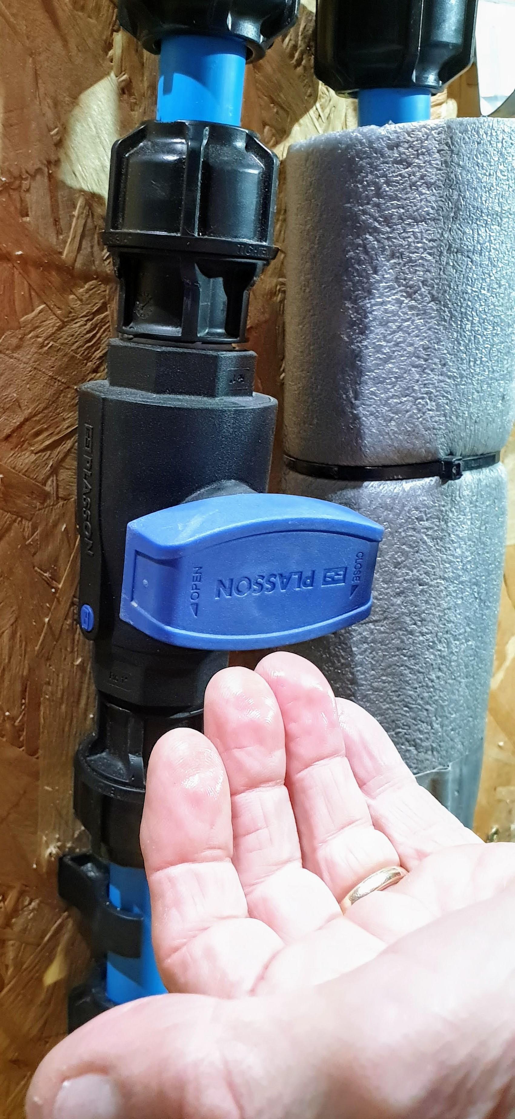

ToughButterCup Posted January 21, 2020 Share Posted January 21, 2020 19 minutes ago, ProDave said: [...] It could just have been a slow leak, not noticed [...] Ahhhh yesss , the slow unnoticed leak, that most annoying of faults - been there got that slightly different T shirt. The Almost Unnoticed Fault T shirt Link to comment Share on other sites More sharing options...
epsilonGreedy Posted January 23, 2020 Author Share Posted January 23, 2020 On 20/01/2020 at 22:04, Jeremy Harris said: A word of caution. We built a raised platform at the end of my mother's kitchen to take the washing machine.. The cause of the problem was the raised platform. When the drum support failed, the machine started vibrating, moved itself forward and fell face down on the floor... As it happens the prompt for me to start this thread was a related incident. Last week I went out to the shed to lock it up for the night and noticed the washing machine had shuffled itself sideways on the raised plinth until one foot was off the edge. The source of the trouble was a single heavy woolen jumper that caused an off balance spin. The plinth in the shed has a minimal footprint. Given your experience and what happened last week in my shed I intend to increase the depth the size of the plinth by 3" and add a 2 x 1 batten to contain the machine if it tries to shuffle itself forwards off the plinth. When the house utility area is fitted out the w/m will be constrained each side by other fitted units. Link to comment Share on other sites More sharing options...
epsilonGreedy Posted January 23, 2020 Author Share Posted January 23, 2020 On 21/01/2020 at 08:48, AnonymousBosch said: Ahhhh yesss , the slow unnoticed leak, that most annoying of faults - been there got that slightly different T shirt. The Almost Unnoticed Fault T shirt Plasson to Philmac, a match made in hell. Link to comment Share on other sites More sharing options...
ToughButterCup Posted January 24, 2020 Share Posted January 24, 2020 A little update: the next TWO Plasson replacement stop valves we fitted BOTH leaked from the valve stem- simple bad luck I think Philmacks fitted no problem Link to comment Share on other sites More sharing options...
epsilonGreedy Posted January 24, 2020 Author Share Posted January 24, 2020 2 hours ago, AnonymousBosch said: A little update: the next TWO Plasson replacement stop valves we fitted BOTH leaked from the valve stem- simple bad luck I think Philmacks fitted no problem Oh I forgot and this is a little embarrassing to confess. Even though I utterly loath and despise the general design of the Philmac connectors I retained the two Philmac stopcocks supplied by Pipestock. So with a hint of Orwellian u-turn, the new mantra is: Philmac stopcock to plasson everything else = happiness. Plasson stopcock to Philmac connectors = dribbling hell. Link to comment Share on other sites More sharing options...

ryder72 Posted February 2, 2020 Share Posted February 2, 2020 Washing machines with front loading can be raised on a plinth but must have a restriction panel or similar above it to prevent forward tipping. Link to comment Share on other sites More sharing options...
