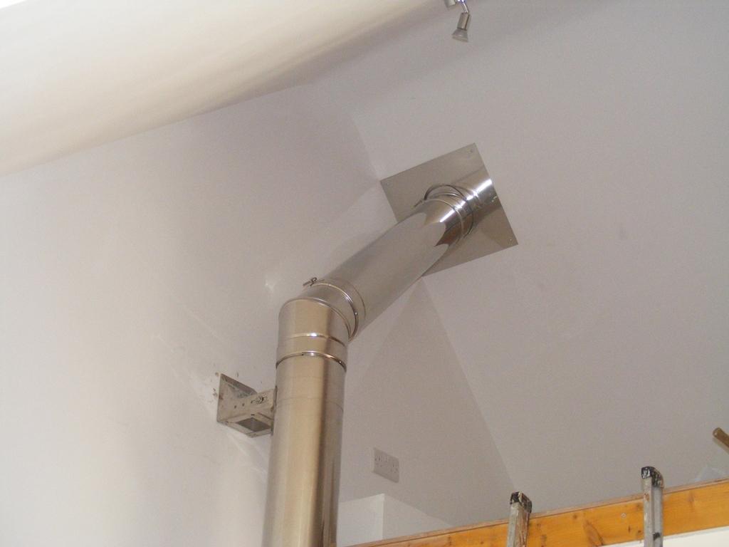

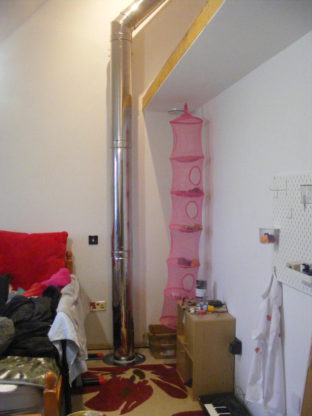

ProDave Posted February 8, 2020 Share Posted February 8, 2020 Nine goes through a bedroom Link to comment Share on other sites More sharing options...
eandg Posted February 8, 2020 Share Posted February 8, 2020 Looks alright - is there much heat from it? We have young kids and that's also a concern. Link to comment Share on other sites More sharing options...
ProDave Posted February 8, 2020 Share Posted February 8, 2020 Just pleasantly warm to the touch at low level and barely warm at all higher up. Manufacturer says you must maintain 50mm gap to flamable material but I reckon you could sit a box of matches on it without problem. Link to comment Share on other sites More sharing options...

Thedreamer Posted February 8, 2020 Share Posted February 8, 2020 39 minutes ago, ProDave said: Nine goes through a bedroom Not 100% clear from the photo, but at the bottom of the stove flue is the bottom plate, ventilated? Link to comment Share on other sites More sharing options...

gc100 Posted February 9, 2020 Share Posted February 9, 2020 10 hours ago, ProDave said: Nine goes through a bedroom how much gap around the flu where it goes through the roof? I presume there is no insulation here and I’m wondering if it creates a cold bridge/area? on the quote: I insulated 2 stoves in my last house and for BC to sign off at about £900 each. However I wouldn’t do it that cheap agin in my build. I’ll be being good money in a top of the line stove as the cheap stoves I got (that looked great) where not effecient and drew too much air/difficult to control well. Plus I don’t think they’ll last 20 years. Stoves are basic things but in my experience there is a difference between the cheap and top ends. Link to comment Share on other sites More sharing options...

ProDave Posted February 9, 2020 Share Posted February 9, 2020 2 hours ago, gc100 said: how much gap around the flu where it goes through the roof? I presume there is no insulation here and I’m wondering if it creates a cold bridge/area? on the quote: I insulated 2 stoves in my last house and for BC to sign off at about £900 each. However I wouldn’t do it that cheap agin in my build. I’ll be being good money in a top of the line stove as the cheap stoves I got (that looked great) where not effecient and drew too much air/difficult to control well. Plus I don’t think they’ll last 20 years. Stoves are basic things but in my experience there is a difference between the cheap and top ends. Where I bought the flue from https://www.flue-pipes.com/ they sell an insulating sleeve. This is clearly made of a non flamable material and / or certified by the manufacturer for this purpose and is 6cm thick, This means that anything, including flamable materials can be in contact with the outside of this sleeve as they are the required distance from the flue. So you can seal up the hole around the sleeve and get an air tight penetration. Our chosen stove was a Medip Stoves Churchill convection model. Rated at 4.5Kw it has a ducted air intake for both primary and secondary air so is room sealed. so no vents needed to let cold air into your room. We are very pleased with it. I can honestly say this is the first stove we have ever had, that genuinely keeps it's glass clear, I have never had to touch the glass or clean it at all. 1 1 Link to comment Share on other sites More sharing options...

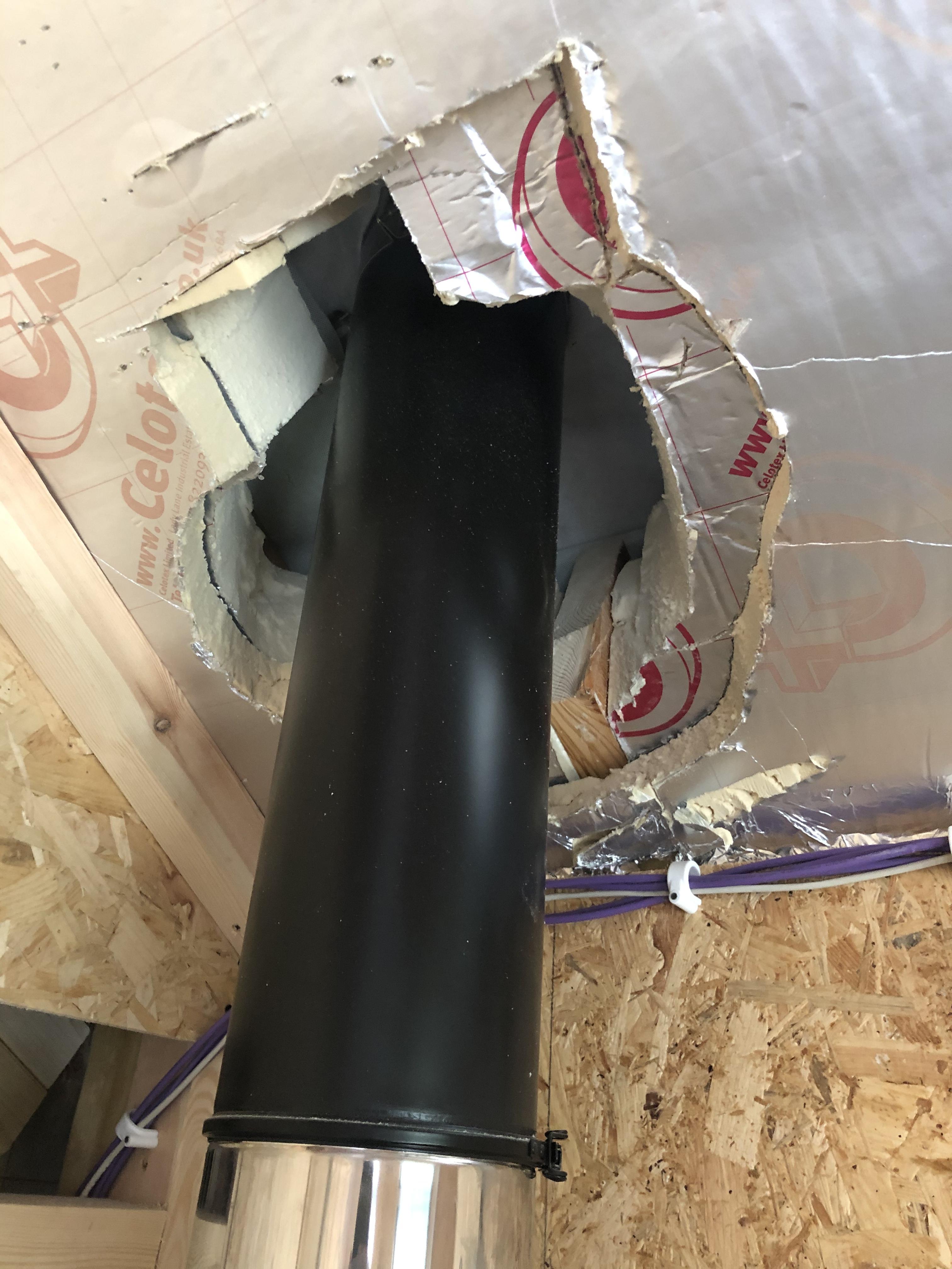

Pocster Posted June 10, 2020 Author Share Posted June 10, 2020 Do I pack the hole through the ceiling with Earth wool ? Link to comment Share on other sites More sharing options...
ProDave Posted June 10, 2020 Share Posted June 10, 2020 If you had bought them from the place I did, you could have bought an "insulating sleeve" made just for that job. Oh look only 1 post up. 2 Link to comment Share on other sites More sharing options...
gc100 Posted June 10, 2020 Share Posted June 10, 2020 40 minutes ago, pocster said: Do I pack the hole through the ceiling with Earth wool ? That won't pass build regs I think. There is a min distance allow to combustible materials. Something like 400 centres between - I can't remember off the top of my head. Link to comment Share on other sites More sharing options...
ProDave Posted June 10, 2020 Share Posted June 10, 2020 Assuming that is TWIN wall then it will be the manufacturers specification, which is usually something like 50mm or 60mm to combustibles. So some more of that celotex will need trimming a bit more. 1 Link to comment Share on other sites More sharing options...
Pocster Posted June 10, 2020 Author Share Posted June 10, 2020 21 minutes ago, ProDave said: Assuming that is TWIN wall then it will be the manufacturers specification, which is usually something like 50mm or 60mm to combustibles. So some more of that celotex will need trimming a bit more. Ok . So I can cut the celotex back to allow 60mm gap . Do I then fill the gap with Earth wool - I assume it’s non combustible Link to comment Share on other sites More sharing options...
Pocster Posted June 10, 2020 Author Share Posted June 10, 2020 1 hour ago, ProDave said: If you had bought them from the place I did, you could have bought an "insulating sleeve" made just for that job. Oh look only 1 post up. Yeah but you posted that on Feb 9th ?. I never read back through a thread ? Link to comment Share on other sites More sharing options...
Pocster Posted June 10, 2020 Author Share Posted June 10, 2020 Boxing it in soon . Yes ! There will be an access hatch . Yes the timber frame etc. will be 60mm away from flue . Be down soon Mom ... Link to comment Share on other sites More sharing options...

ProDave Posted June 10, 2020 Share Posted June 10, 2020 Check the regs for boxing in. I am sure it needs to be ventilated, needs access for inspection, and needs a CO alarm (at least in a recent new build I was tasked with installing a CO alarm in a flue void) Link to comment Share on other sites More sharing options...
