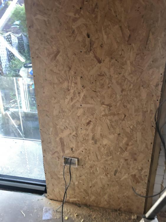

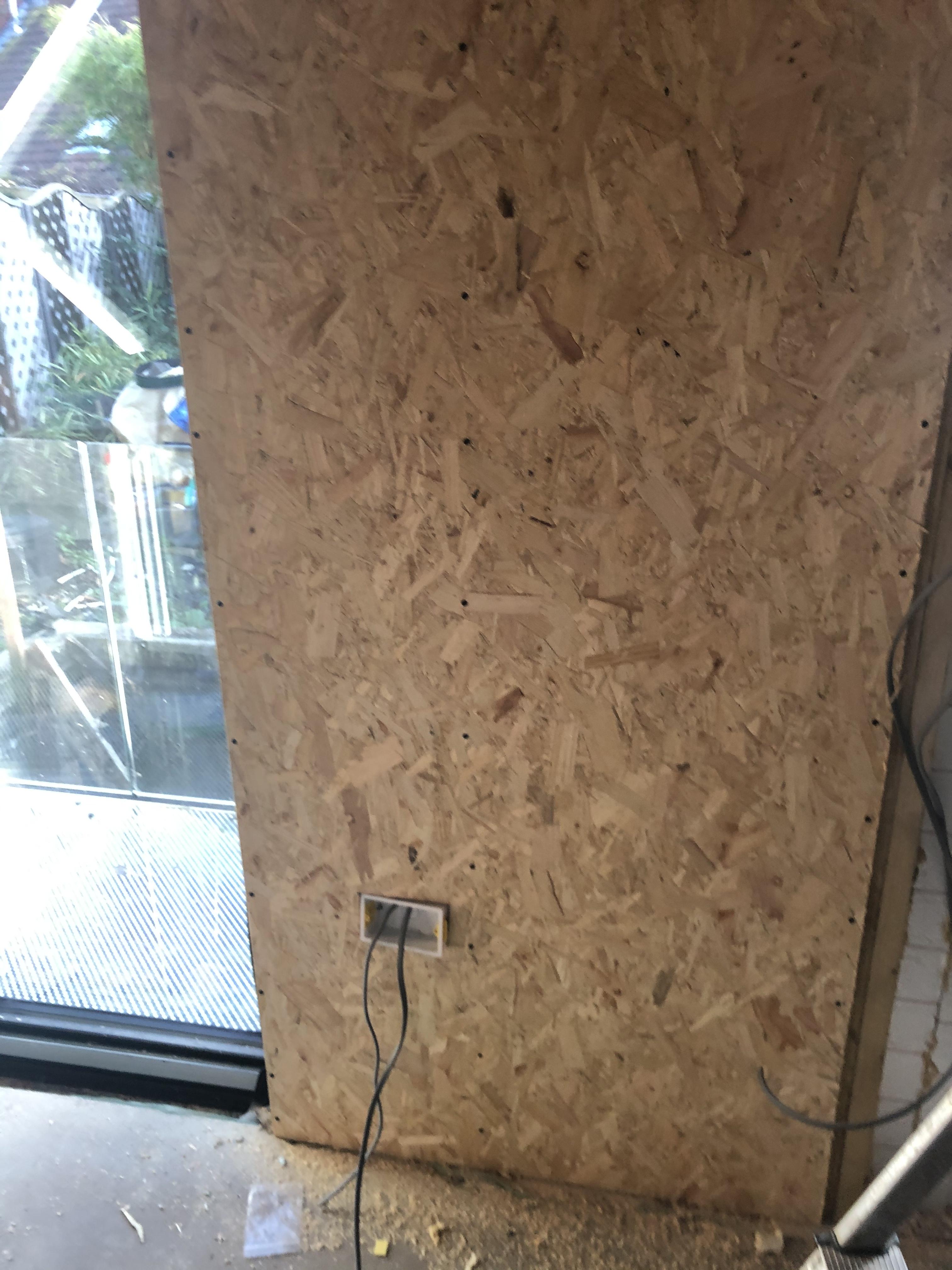

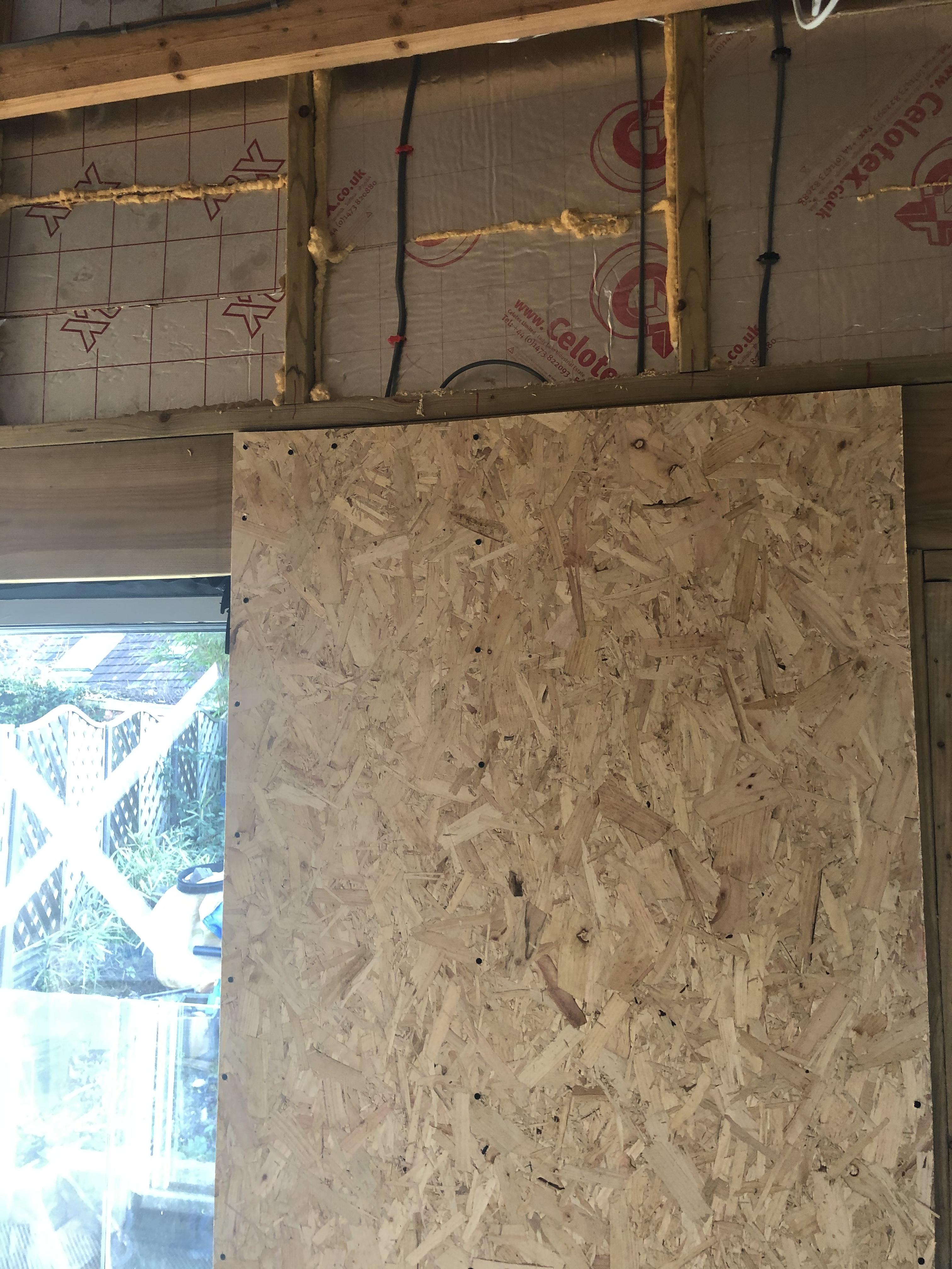

Pocster Posted January 10, 2020 Posted January 10, 2020 (edited) I’ve almost completed the socket wiring install 1st fix for the ground floor . Is there any way I can test each part of the cable ? My concern is that it’s not impossible to imagine that a screw has gone through a cable . Rather than have everything wired up and find the fault it would be much easier to rectify a cable issue now at this stage . So for example in the pics ... Test the cable coming into the socket at ‘this’ end - and where it goes into the next socket . Edited January 10, 2020 by pocster

Pocster Posted January 10, 2020 Author Posted January 10, 2020 44 minutes ago, Carrerahill said: Are you keeping your wires within prescribed areas and immediately horizontal or vertical of any switch or socket? I am not trying to be that annoying twit that just pokes, I only ask as the top image shows a wire but no apparent outlet/device to give someone the indication a wire may be present. Photograph everything before you sheet over (or are we too late for that?). I even wrote on sheets as I installed them the distances from walls, and plotted out danger zones. When it comes to installing the kitchen in particular I will lightly re-plot these out across the whole kitchen double checked with a wire finder so that there is no excuse for hitting a wire! For testing, there are various tests from very basic to more advanced. As a starter do basic continuity test, as said above, Wago the wires together at one end, and bell them out at the other. This can test for breaks and shorts, but not for a nail or screw which has penetrated a single core and no other. Hey! All wires run vertical to all sockets. You spotted that odd one as it's just a pull cord cable so I can pull a tv ariel feed in there later.
