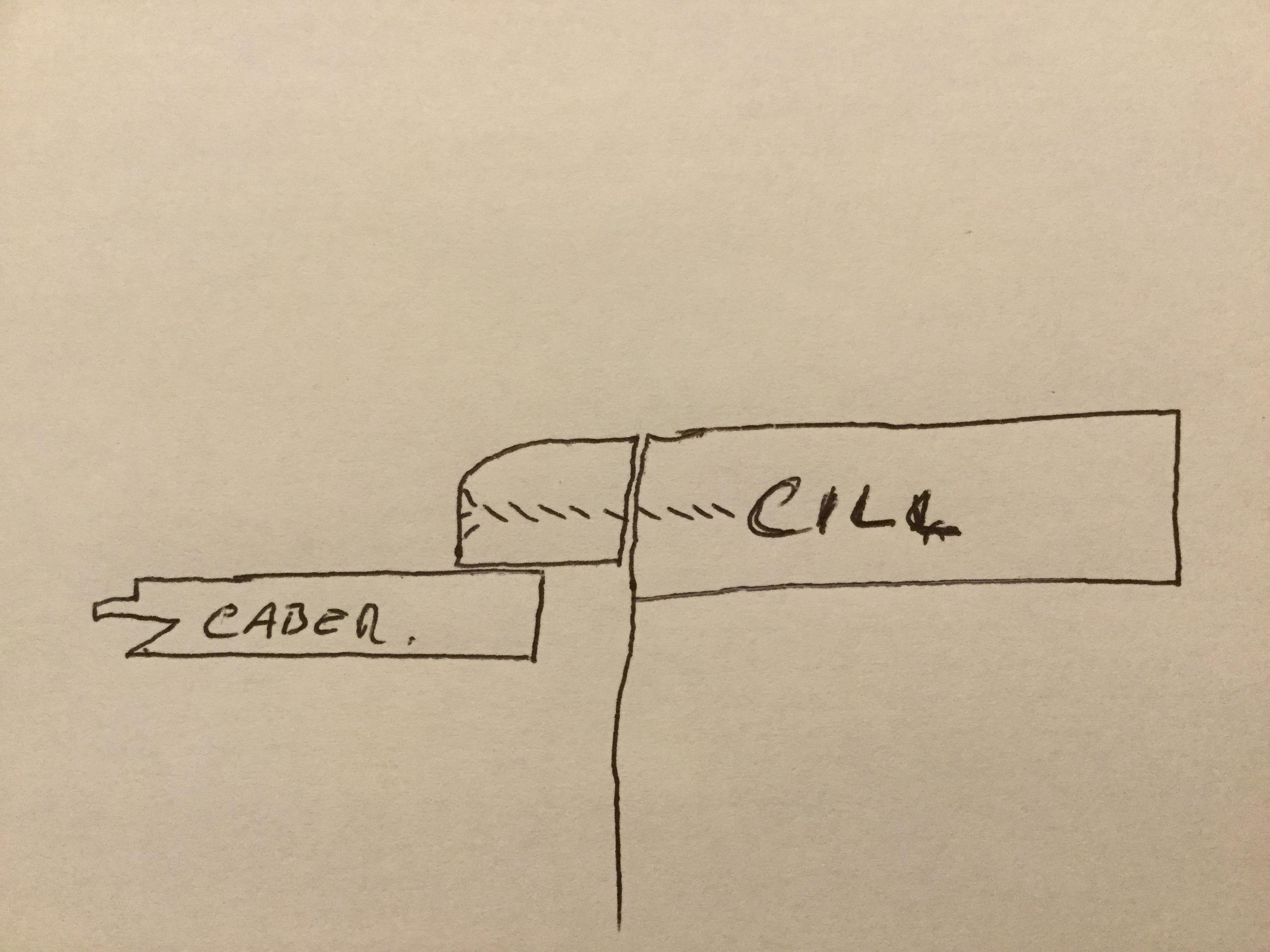

zoothorn Posted April 30, 2020 Author Share Posted April 30, 2020 Yes but the thing is the only hire tool place is closed currently, & small so I'd think unlikely they'd have one. We don't have a Hirestation- I'm wild west wales totally reliant on one town & its not big either. I do need to ask one last thing on the caber boards: I've left the usual 10mm expansion gap @ my threshold, away from the slate sill/ threshold section itself.. & this seems the most susceptible bit to get rained on if not moisture off wet feet etc. What to do here? Link to comment Share on other sites More sharing options...
zoothorn Posted April 30, 2020 Author Share Posted April 30, 2020 (edited) What about stuffing some PIR into here.. being a 22mm x 10mm x 500mm long wee trench. Then the tile squares can ride over > butt up over right up to the slate > silicone bead along. Are you allowed to suggest things yourself on a forum? or just me going mental probably. Edited April 30, 2020 by zoothorn Link to comment Share on other sites More sharing options...
joe90 Posted April 30, 2020 Share Posted April 30, 2020 Is the floor flush with the threshold? Link to comment Share on other sites More sharing options...
zoothorn Posted April 30, 2020 Author Share Posted April 30, 2020 2 minutes ago, joe90 said: Is the floor flush with the threshold? Heightwise, no its 2cm less. But its the extent to which the floor extends to, relative to the threshold, is my Q here. So it stops 10mm short, so you step over this gap (the width of the threshold). Rain will get to the chipboard edge here (around the walls/ everywhere else the gap is n/a of course). Link to comment Share on other sites More sharing options...
PeterW Posted April 30, 2020 Share Posted April 30, 2020 Piece of 10mm x 40mm timber glued to the flooring and sealed to the step edge with CT1 or similar. Covers the gap, job done. Link to comment Share on other sites More sharing options...
joe90 Posted April 30, 2020 Share Posted April 30, 2020 (edited) Your good with a router, 20 x20 oak with rounded over edge screwed to cill . (Lay your vinyl tile first so they sit under the oak. ) This allows the caber floating floor to expand and contract and slide under the new piece. Edited April 30, 2020 by joe90 Link to comment Share on other sites More sharing options...
zoothorn Posted April 30, 2020 Author Share Posted April 30, 2020 4 minutes ago, PeterW said: Piece of 10mm x 40mm timber glued to the flooring and sealed to the step edge with CT1 or similar. Covers the gap, job done. Understood. But why didn't I just butt the floor up to the threshold.. because I had to have an expansion gap (aparantly), so how would this wood addition not negate the whole idea? this is why I thought PIR so it could expand into it, if it had to, in theory. 1 Link to comment Share on other sites More sharing options...
