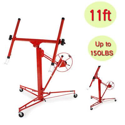

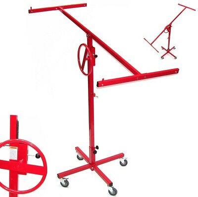

In meantime a Q on plasterboard: can those cheaper pB lifters, lift 15mm Fireboard ok? (i think is it? my BO recommend me to use re. sound)..
it’s sound block you need but I prefer to double board with 12.5mm board, even more sound absorbency (and easier to do). I only used a Pb lifter recently (after years of struggling) bought it second hand and the job was a doddle on my own and sold it again afterwards fir what I paid for it.

Hi joe90.. thing is my BCO has effectively told me to use 15mm pB (& I think he said it was called fireboard? or similar). He's very insistant with materials he's specifying in this room, after I squeezed him to let me go 50mm PIR / 22mm floor.  I don't want to double the cost of 12.5mm pB really, and, double the work of me doing it not having used a lift before. Its a fine idea tho, & ideally I'd take your advice.
That blue Soundbloc board weighs just over 40kg per board.
This sort of cheapo lift has only a 40kg capacity:
The "better"  types have around a 68kg capacity:
You also want a plasterboard carrier to save your back amongst other things!
