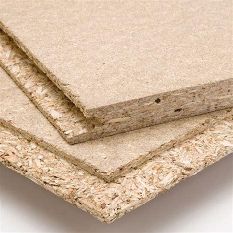

Onoff Posted April 26, 2020 Posted April 26, 2020 9 minutes ago, zoothorn said: Spot the difference? You're a dab hand with a router, can't you modify the tongues? Might be an option if you can't get out or get it delivered etc.

Onoff Posted April 27, 2020 Posted April 27, 2020 (edited) This is going to sound really daft but is is that you are just looking at the tongue from two different sides? I have no experience of Caber but the T&G type chipboard flooring I'm used to has the tongue longer one side to fit the corresponding female. Best pic I could find: Is that you just need to turn those two errant boards through 180deg and they will match the others? Might just have been the way they were loaded at the BM. As for the glued and screwed I'd assumed these boards are going to be screwed onto joists that have pir in between. Also that you will be gluing afvthe T&G joint. No I'm not referring to screwing to the pir. Only a f@ckwit would do that! ? Edited April 27, 2020 by Onoff

zoothorn Posted April 27, 2020 Author Posted April 27, 2020 4 minutes ago, Onoff said: This is going to sound really daft but is is that you are just looking at the tongue from two different sides? I have no experience of Caber but the T&G type chipboard flooring I'm used to has the tongue longer one side to fit the corresponding female. Best pic I could find: Is that you just need to turn those two errant boards through 180deg and they will match the others? Might just have been the way they were loaded at the BM. As for the glued and screwed I'd assumed these boards are going to be screwed onto joists that have pir in between. Also that you will be gluing afvthe T&G joint. No I'm not referring to screwing to the pir. Only a f@ckwit would do that! ? Perfectly reasonable Q Onoff, understandable. But I spent ages twisting it L to R, T to Btm, every which way to try & mate it with a caber+.. until I had to take breaks telling myself it had to fit/ why not etc until my head hurt (not knowing anything other than they are all the same at this point).. but finally I 100% concluded they had to be different. 100% sure. Always 1cm gap, just did not join. If I could find out what make these are.. final proof. Marking on the boards tally with this conclusion (tho un-discernable on the two odd'uns, clear caber+ writing on majority) also two odd'uns have both grey sides, cabers have one brown underside: implying perhaps different, but not conclusively so. Once I'm adamant defo different, I look for t&g differences: cabers seem slightly longer tongues/ grooves/ slightly different in profile: very very tricky job to fettle them.
zoothorn Posted April 27, 2020 Author Posted April 27, 2020 14 minutes ago, Onoff said: This is going to sound really daft but is is that you are just looking at the tongue from two different sides? I have no experience of Caber but the T&G type chipboard flooring I'm used to has the tongue longer one side to fit the corresponding female. Best pic I could find: Is that you just need to turn those two errant boards through 180deg and they will match the others? Might just have been the way they were loaded at the BM. As for the glued and screwed I'd assumed these boards are going to be screwed onto joists that have pir in between. Also that you will be gluing afvthe T&G joint. No I'm not referring to screwing to the pir. Only a f@ckwit would do that! ? No I was just asking if you were suggesting they needed screwing -together- (not into PIR) as well as the glue. No then. I've just set a bed of 50mm PIR, onto my concrete "whatever-its-called-its-not-the-floor" surface. I have 9mm spacers. I have my 1st board down. I have the day to try & fit the cabers. I will have a flaming gap where I'm unable to complete the job due to 2 unuseable boards. Thanks.
ProDave Posted April 27, 2020 Posted April 27, 2020 I'll have a try. Start your floor using the stack of "good" boards. There should be ZERO waste. What you cut off a board when you do the first row, becomes the starting board for row 2 etc, so absolutely zero waste. You say you have more boards than floor. So there is a high chance you will finish the floor and still have the 2 odd ones left over, not needed. Stop worrying about it unless or until you have used up all the "good" boards and the floor is not finished.
zoothorn Posted April 27, 2020 Author Posted April 27, 2020 @Onoff I -think- the proof these are different/ are incompatible is this. But can you concur so I'm 110% sure? I have a caber & rogue board facing me. Like the photo eg above. Landscape format. Tongues along the top on both boards. So I am looking at the bigger area of visible tongue, from this angle. On the caber it is the grey side. So I am looking at the TOPSIDE of both boards. So far, they are similar. Ok I look to the RHS edge. On the caber+ I have the groove edge. On the rogue board I have tongue. This surely is proof enough they are different -and- they are incompatible. Would you agree? (or am I being thick/ am I missing something?)

zoothorn Posted April 27, 2020 Author Posted April 27, 2020 3 minutes ago, PeterW said: @zoothorn can you lay the boards side by side and show the difference of the T&G against each other Honestly I'm so struggling with camera to take even 1 pic, let alone focus in dark room PeterW. Even if t&g the same which I can for certain say they are not: I have a rogue offcut I pushed & prodded up to a caber.. always 1cm gap & do not 'mate' at all: I have differing profiles at the RHS (short) edge. Groove on caber, tongue on rogue.
ProDave Posted April 27, 2020 Posted April 27, 2020 10 minutes ago, zoothorn said: Honestly I'm so struggling with camera to take even 1 pic, let alone focus in dark room PeterW. Even if t&g the same which I can for certain say they are not: I have a rogue offcut I pushed & prodded up to a caber.. always 1cm gap & do not 'mate' at all: I have differing profiles at the RHS (short) edge. Groove on caber, tongue on rogue. You only need the long edge of make A to mate with make B You would then use the two rogue boards just for one row of floor, and in that case their end tongue and grooves would mate. And you would use the pair or rogue boards as either the very first row or the very last row, NOT a row in the middle. If you can't get make A tongue to push unto make B groove, try the other way, make B tongue pushing into make A groove. If one way fits but not the other, that determines if the two rogue boards will become your first or your last row.

zoothorn Posted April 27, 2020 Author Posted April 27, 2020 4 minutes ago, ProDave said: You only need the long edge of make A to mate with make B You would then use the two rogue boards just for one row of floor, and in that case their end tongue and grooves would mate. And you would use the pair or rogue boards as either the very first row or the very last row, NOT a row in the middle. If you can't get make A tongue to push unto make B groove, try the other way, make B tongue pushing into make A groove. If one way fits but not the other, that determines if the two rogue boards will become your first or your last row. That's a clever idea.. understand this negates the edge profile needing to match the caber. But if I start with the two rogues, to make a row together, I still have the loooong tongue edge ready to be joined onto, unable to mate with the caber+ groove to make the 2nd row. This is now gone into nut-frying territory. I was ready to proceed without these damn two, leaving gap at the end.. but now if I can fettle these two sods to join & use as a 1st row, maybe I can figure this out. JesusH. I don't know what to do now.
PeterW Posted April 27, 2020 Posted April 27, 2020 3 minutes ago, zoothorn said: don't know what to do now. Buy two Caber+ boards.
