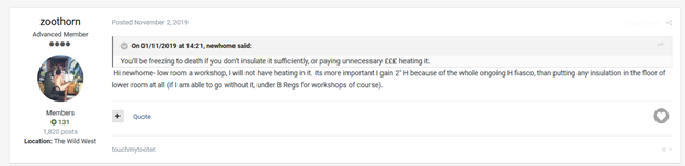

zoothorn Posted January 8, 2020 Author Posted January 8, 2020 Can someone help out here. There's a massive miscommunication, or I cannot understand PeteW's syntax.. or something very odd happening. One question for now. I have a ground floor room with 1x door/ 1x window, a concrete floor slab > 50mm insulation + 22mm chipboard floor, timber-frame walls filled with 140mm of insulation > plasterboarded.. & a ceiling of joists filled with typical orange loft insulation > plasterboarded. The BCO has determined, in u-value terms, the insulation to be as said. Is this room determined to be A) unheated, or B) heated ? Thanks.
