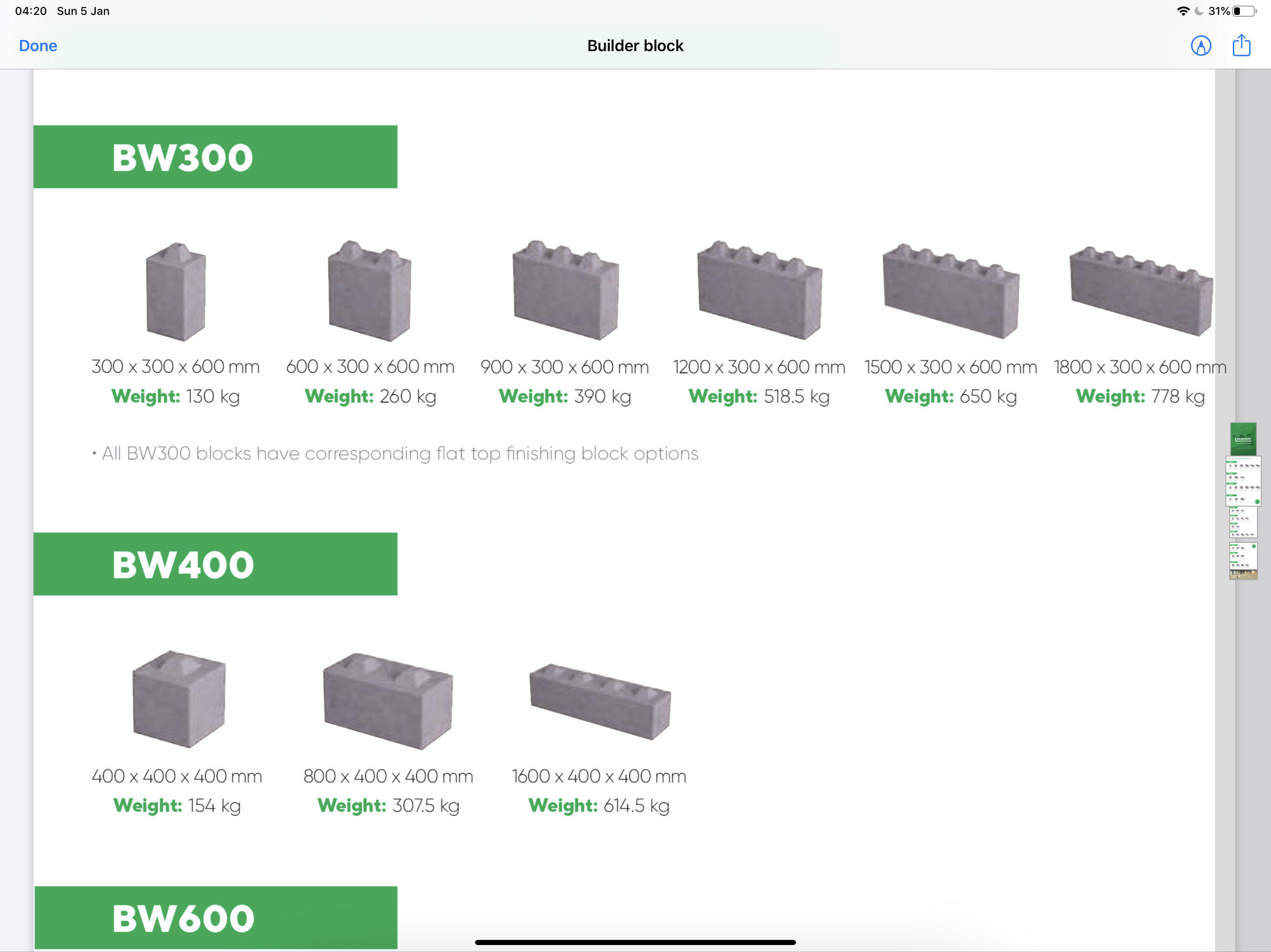

I’m guessing that building control and mortgage companies would view 300mm wide Concrete Lego blocks with ewi as no different than standard concrete block solid wall construction with EWI?
Am I missing something obvious? I know they are usually used for agricultural purposes or retaining walls.
I never considered them for my house due to their 600mm width and 1.5 tonne weight,  but the new 300mm versions really got my thinking.
I know for most they would be expensive and impractical. But labour costs for block laying I’ve had have been astronomical. This would be much cheaper for me personally as I could diy the construction with a mate and have the shell up in 2/3 days.

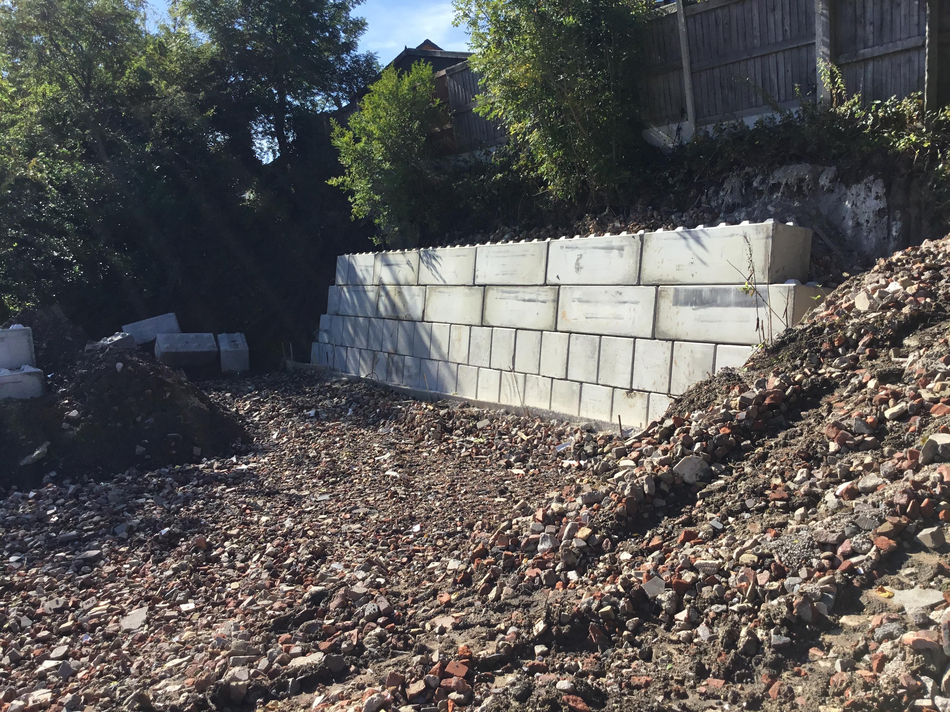

icf is more expensive and doesn’t suit my site unfortunately. The added obvious bonus with icf Is the insulation is included

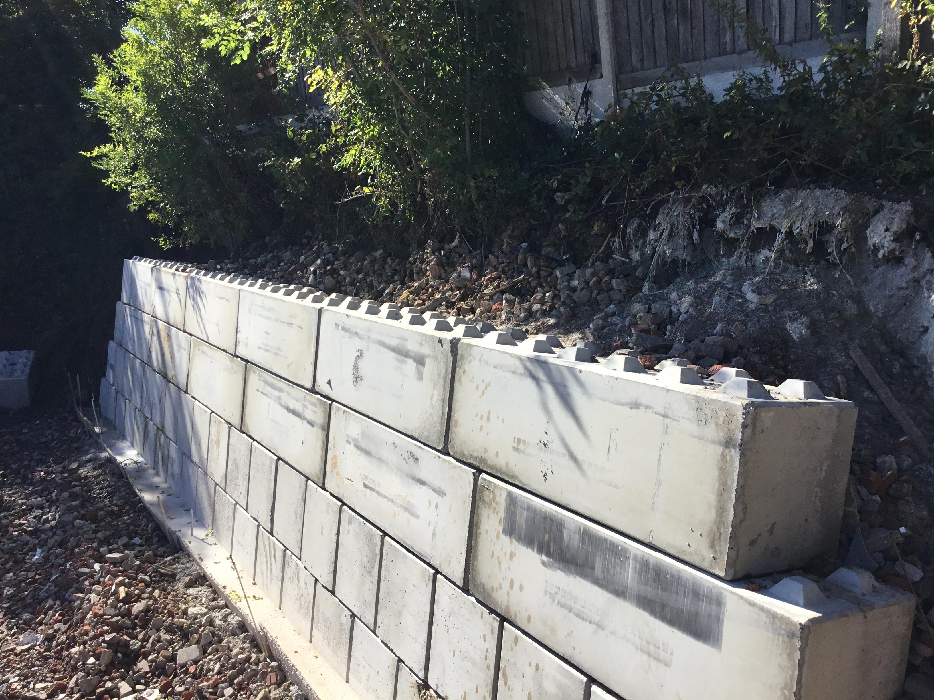

I had a huge retaining wall built with lego blocks in days and it saved me at least £35k (£65 k if you compare to the highest quotes I got)

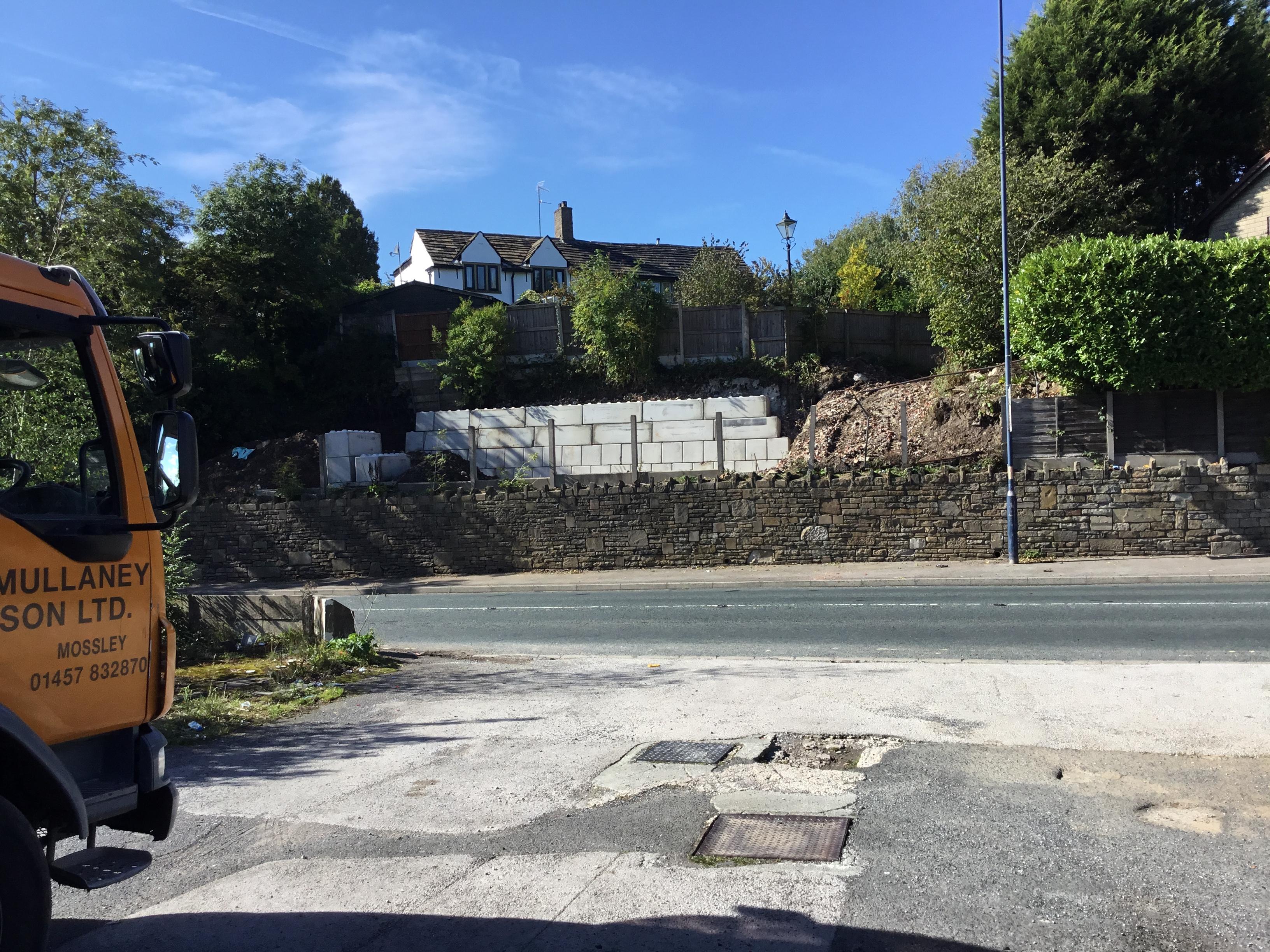

As my site is elevated 2m above a footpath and road. It is not a safe option. A burst could injure someone or cause a road accident.

I had quotes that high for my retaining wall. I built it for around £8-9k all in.
The company who supplies the blocks are 5 mins away and I could have the walls stacked in 2/3 days.

 Cutting isn’t a issue thankfully. They do gable blocks as many industrial/agri  buildings are built using them.
when on a flat foundation they sit prefectly plumb. They slot together like Lego.
My wall took a bit of extra work as the 3 bottom roes are 1.8m 1.5 tonne blocks laid length way to give depth to the base and the upper courses laid width ways and back filled with 20 tonnes of broken brick. All on a 10 degree incline foundation. Stacking a house with 300mm wide, 500 kg blocks would be easy by comparison.
I was thinking of using the longer 1.8m blocks as lintel for smaller windows and doors, but my bigger windows will need a engineered solution I agree.
I would think a waterroof barrier could be achieved using foam and quick set adhesive between the blocks, and pointing them externally and internally?

The 1200 x 300 x 600 blocks weigh 518kg. Im guessing that 0.72m2 of 225mm solid block laid flat would weigh around a third less less?
With the various sizes and shapes available in the 300mm wide size i am thinking doors and windows won’t be a issue?
I know the owner of the company so I am going directly to him tomorrow. He will tell me one way or the other.

using 300mm blocks makes cutting them to fit  realistic possiblity , but of course you would work it out as design stage to limit  the number of cuts

@K78 Looking at your pictures I can understand your concern about possible breakout with ICF and how you could install bracing to counter that. I like your idea of using the lego blocks and hope that you are able to complete your build using them. It's nice to see different construction techniques being used rather than the same old methods. Good luck with the project.
