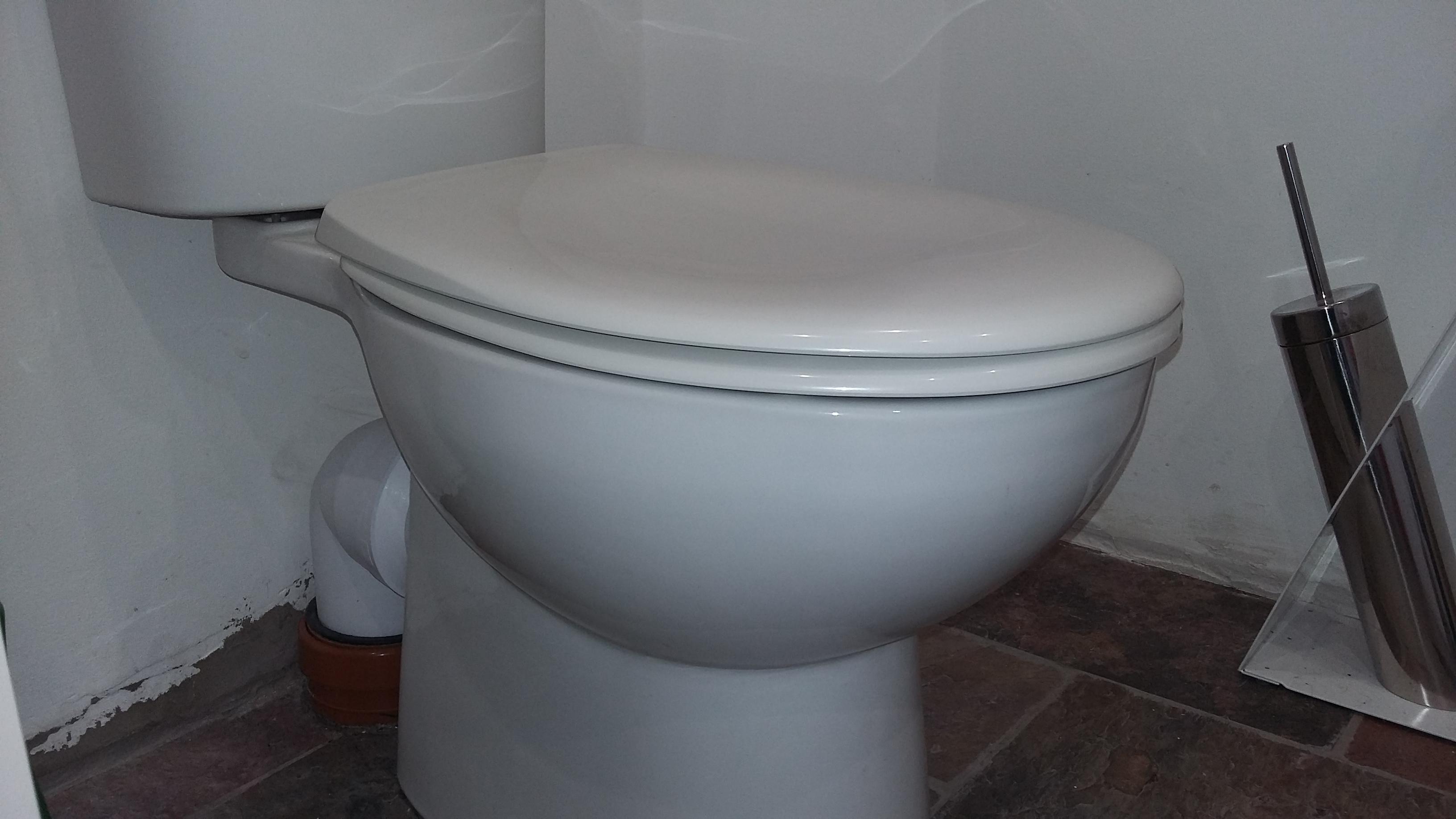

ProDave Posted January 3, 2020 Share Posted January 3, 2020 I have a standard cheap Wickes close coupled pan and cistern downstairs. From the wall, the front of the pan is 66cm. That would leave you 54cm between the front of the pan and the facing wall. Plenty of room to sit down and use it. You might have problems if building control are demanding this is an "accessible " facility. From a standard close coupled pan, the pan connector and soil pipe can exit sideways without adding any extra depth. As I have it, the pan connector goes straight down. Link to comment Share on other sites More sharing options...
Toppers Posted January 3, 2020 Author Share Posted January 3, 2020 9 minutes ago, ProDave said: I have a standard cheap Wickes close coupled pan and cistern downstairs. From the wall, the front of the pan is 66cm. that would leave you 54cm between the front of the pan and the facing wall. Plenty of room to sit down and use it. You might have problems if building control are demanding this is an "accessible " facility. From a standard close coupled pan, the pan connector and soil pipe can exit sideways without adding any extra depth. That sounds like it would do the trick, building control have never made any mention of it being accessible and they have approved the plans. Link to comment Share on other sites More sharing options...
Gone West Posted January 3, 2020 Share Posted January 3, 2020 @Toppers I fitted a corner toilet in our wetroom with the soil pipe stub in the corner like yours. Pan connector and 90 degree bend and it fitted fine. We bought it on Ebay and it is similar to this one. https://www.ebay.co.uk/itm/WC-Ceramic-Toilet-Bathroom-Corner-Toilet-White/283456730805 Link to comment Share on other sites More sharing options...
ProDave Posted January 3, 2020 Share Posted January 3, 2020 3 minutes ago, Toppers said: That sounds like it would do the trick, building control have never made any mention of it being accessible and they have approved the plans. I have added a picture in my post above. 1 Link to comment Share on other sites More sharing options...

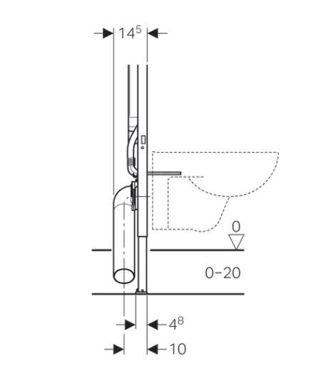

Onoff Posted January 3, 2020 Share Posted January 3, 2020 (edited) 145mm from back of pipe to front of frame with an 8cm Geberit: https://catalog.geberit.co.uk/en-GB/Geberit-Duofix-frame-for-wall-hung-WC,-114-cm,-with-Sigma-concealed-cistern-8-cm/PRO_168879-111.799.00.1.html Edited January 3, 2020 by Onoff Link to comment Share on other sites More sharing options...

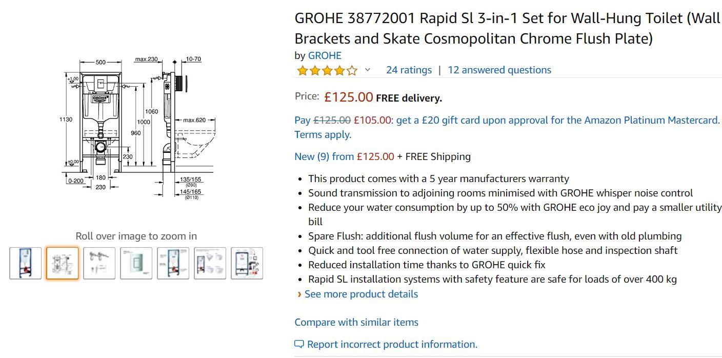

Onoff Posted January 3, 2020 Share Posted January 3, 2020 Grohe; similar install dimns: Link to comment Share on other sites More sharing options...
Temp Posted January 3, 2020 Share Posted January 3, 2020 Think the shortest wall hung is around 480mm so add 145mm and you get 625mm. Link to comment Share on other sites More sharing options...
