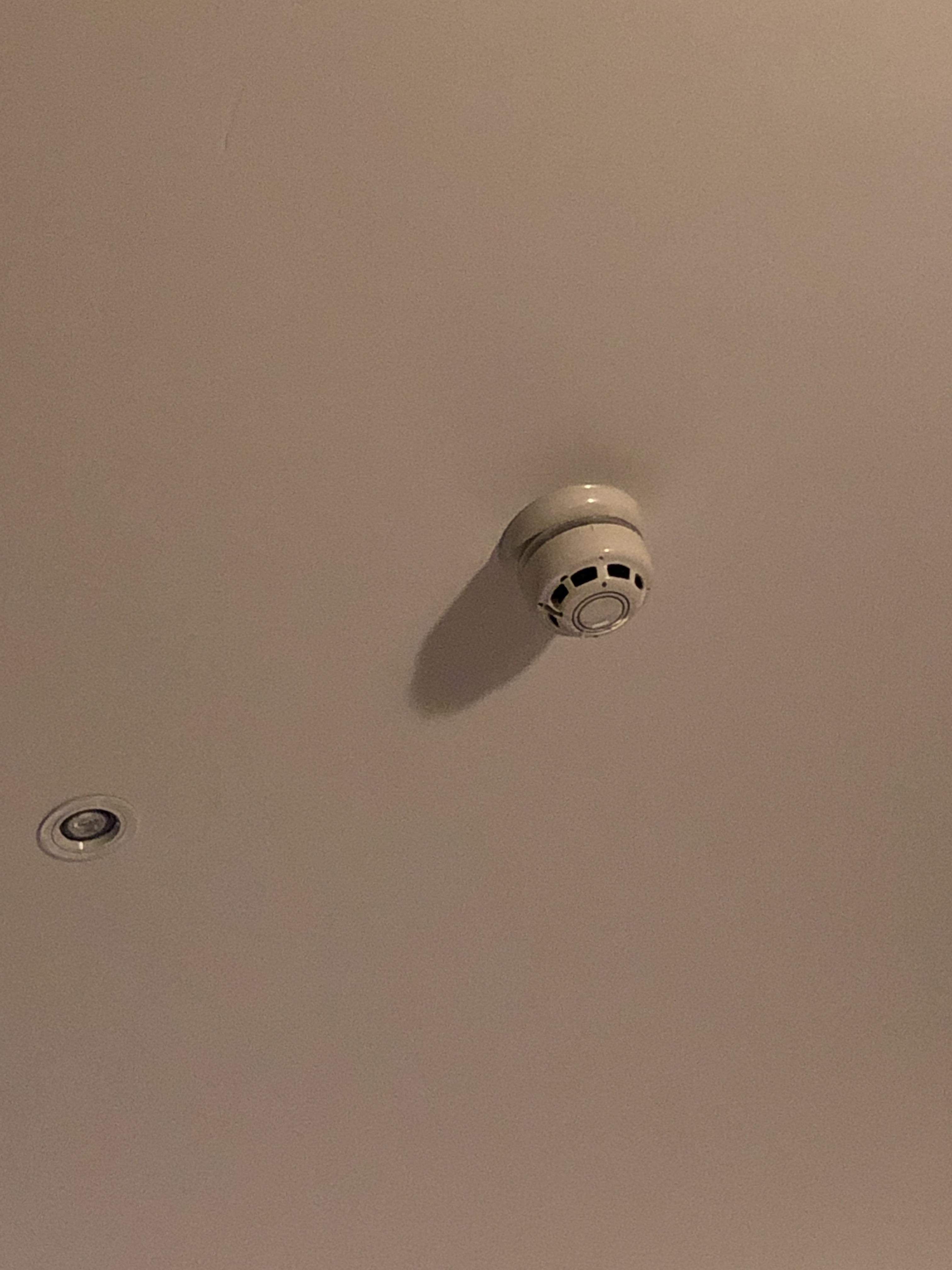

Pocster Posted December 28, 2019 Author Posted December 28, 2019 12 minutes ago, joth said: It's not entirely conclusive (and not actually sure it's the thread I remembered), but... You would of thought some manufacturer would of seen the niche in the market by now . Currently staying at centre Parcs - look at this bloody ‘knob’ ceiling protrusion!!

Onoff Posted December 29, 2019 Posted December 29, 2019 There's probably good reason smoke and CO2 alarms "protrude", to do I imagine with air/smoke flow. Having them "flush" could cost you seconds when it counts. 2

Pocster Posted December 29, 2019 Author Posted December 29, 2019 1 hour ago, Onoff said: There's probably good reason smoke and CO2 alarms "protrude", to do I imagine with air/smoke flow. Having them "flush" could cost you seconds when it counts. I don’t mind a slight protrusion- as also assume they have to ; but some are well chunky !

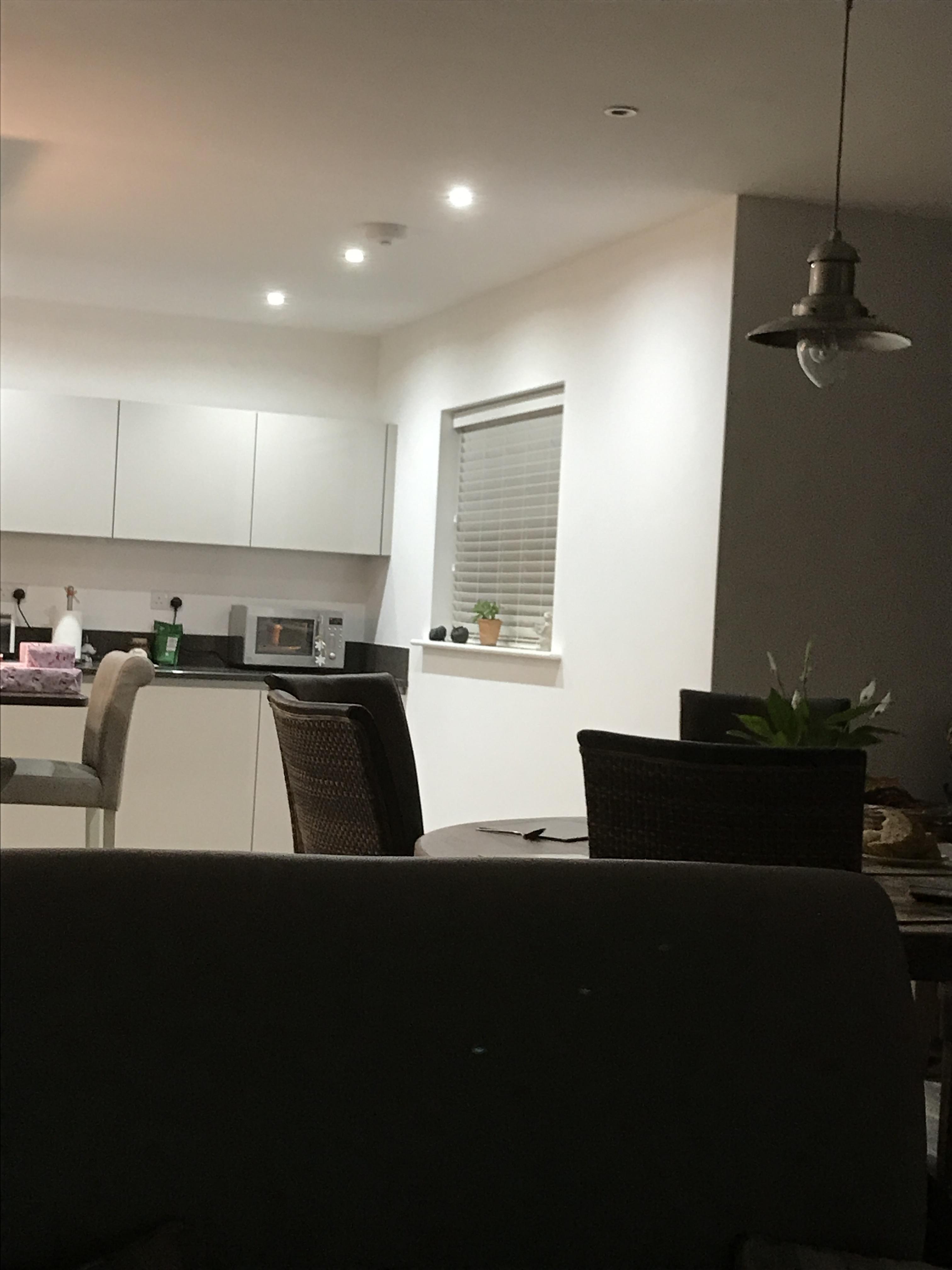

Mr Punter Posted December 29, 2019 Posted December 29, 2019 They need to see the smoke to work and the smoke will not get into a recess easily. I have Aico and they are fine. I guess yours will be more obvious with the mirrored ceilings everywhere? 1
