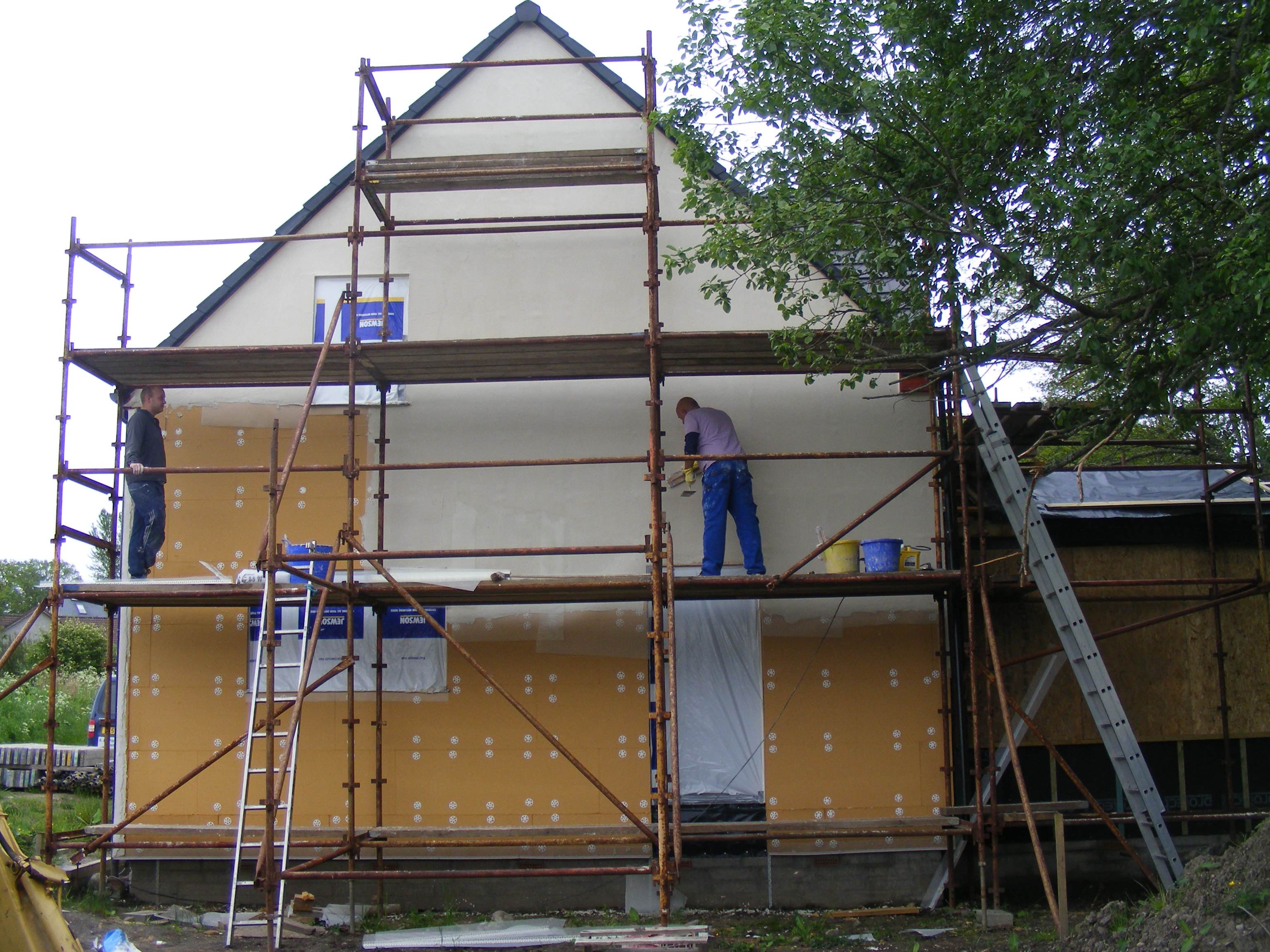

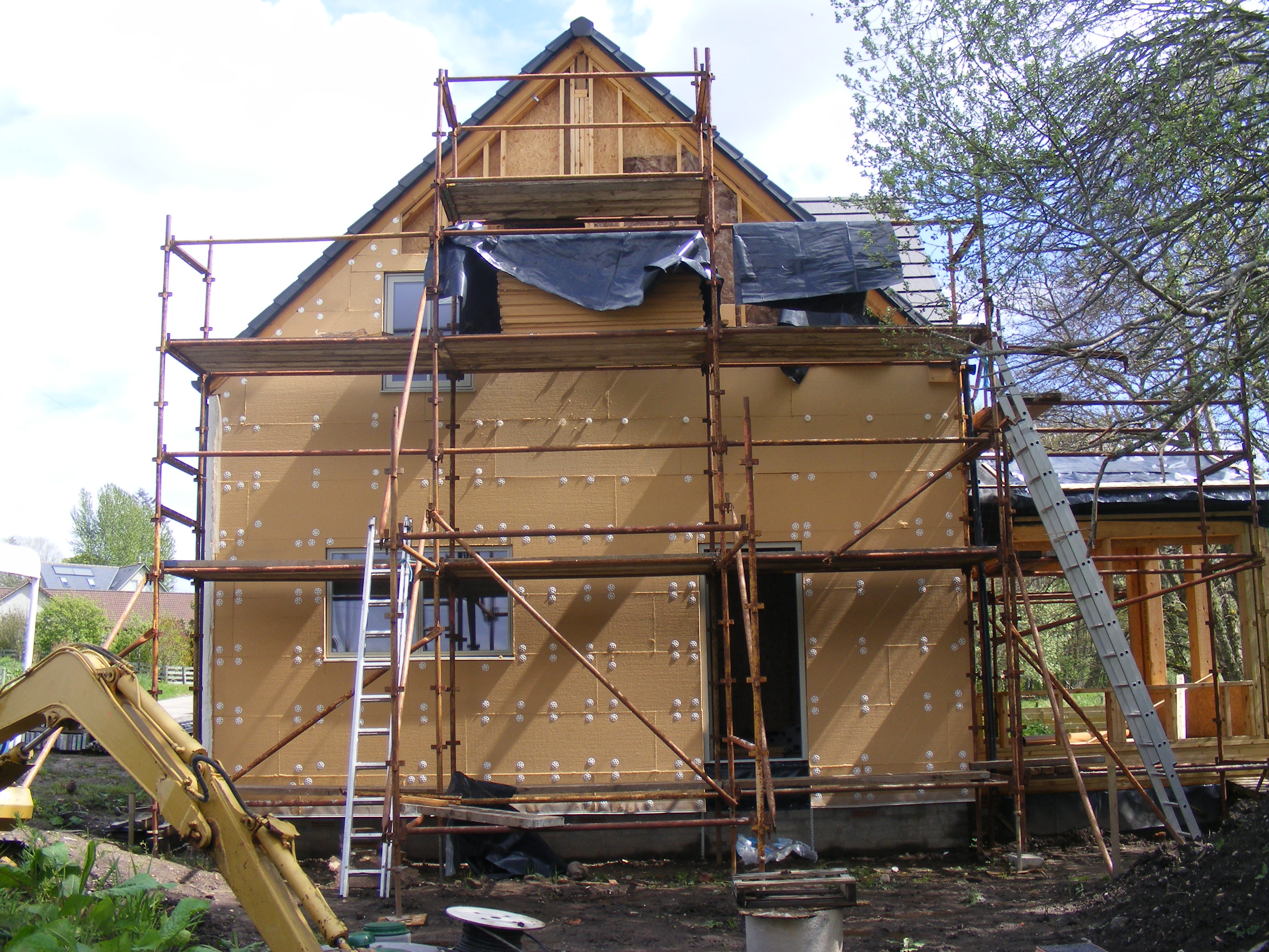

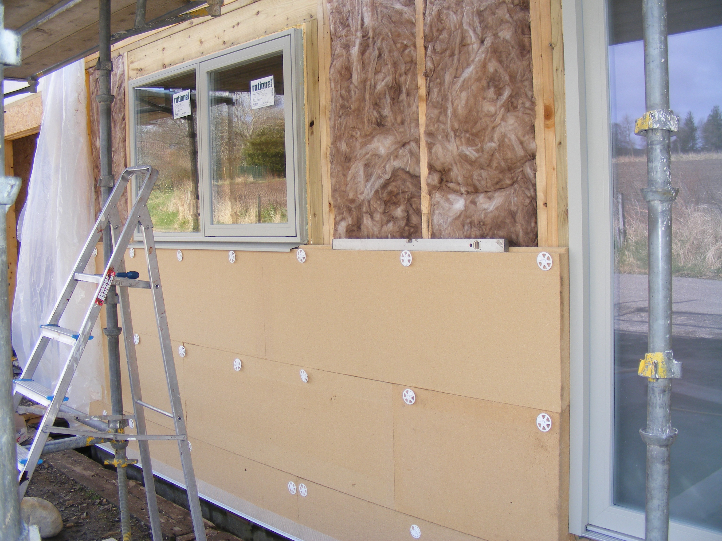

Yes that's me.  100mm thick wood fibre board (Pavatex) over a timber frame, and a lime based render system straight onto it with a silicon top coat.
There's more on my blog, but apologies I have still not copied over the early entries from the old ebuild blog. So a couple of pictures here for you:

Yes the wood fibre board costs money, but in my case that is offset against not having to pay for blockwork and someone to lay the blocks, and simplified foundations. the fact it can be DIY fitted is another saving in labour of you choose.
My argument was a blockwork skin and cavity on a timber frame adds very little insulation.  This wood fibre skin adds insulation, and helps impiove the air tightness of the build on the outside.
