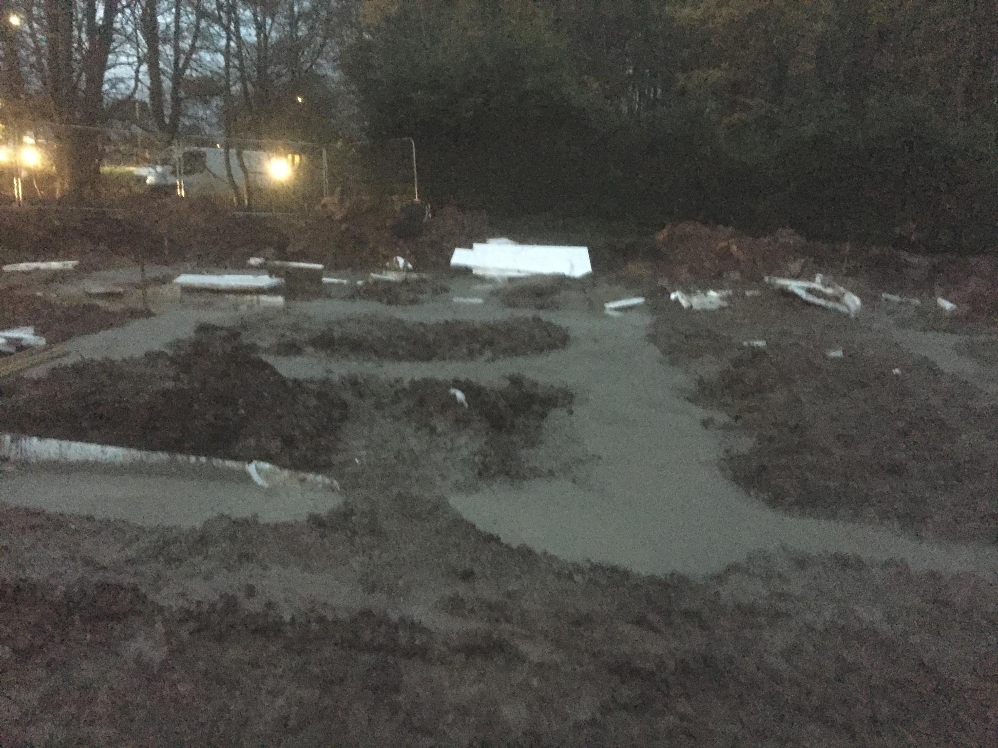

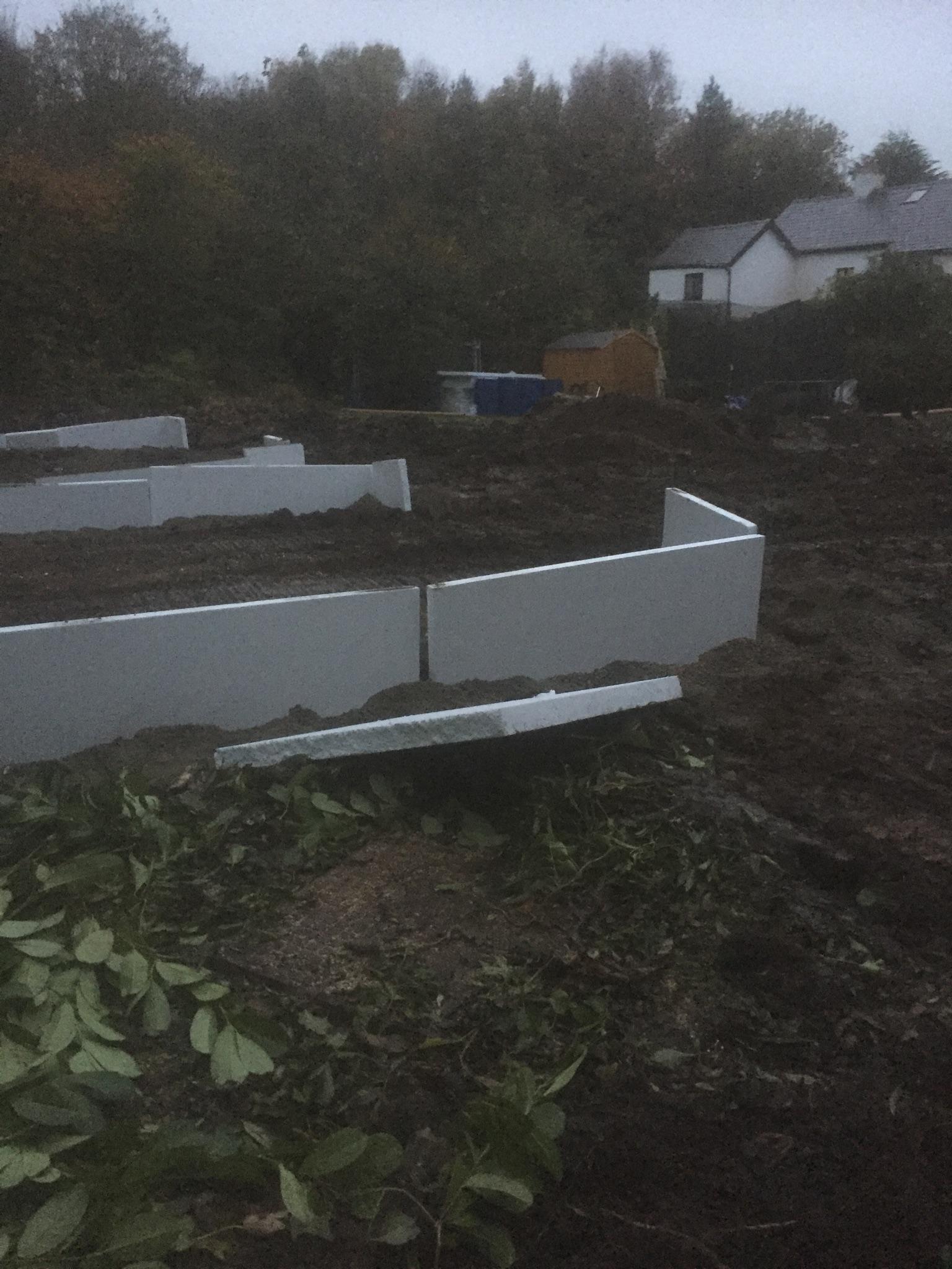

nod Posted December 12, 2019 Share Posted December 12, 2019 Yep did ours Strip foundations I took the decision to full fill 2ntrs including garages We used a 100 cube of concrete Link to comment Share on other sites More sharing options...

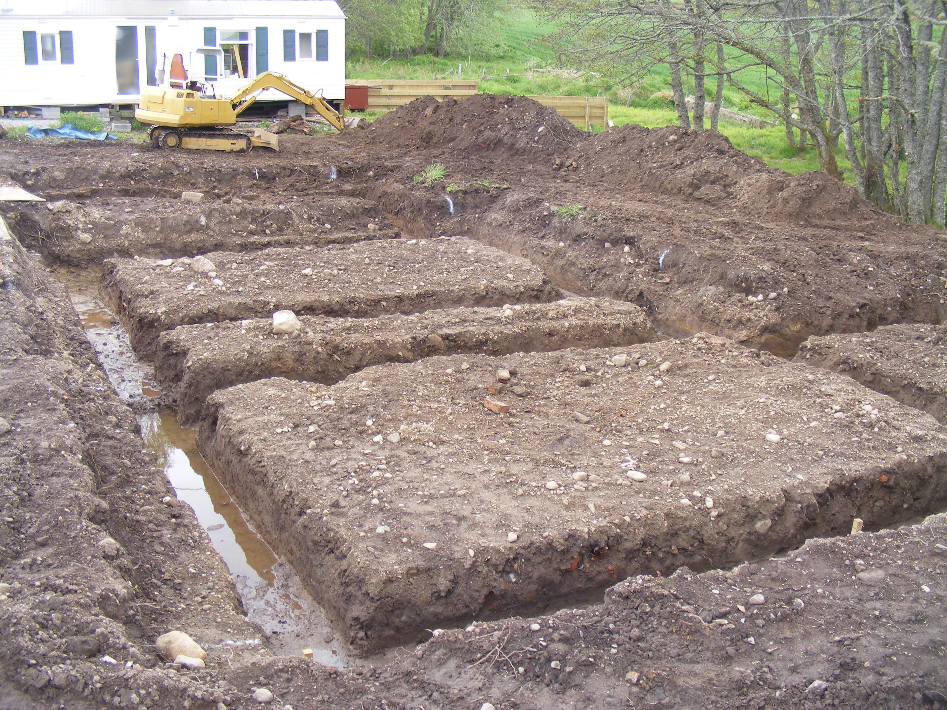

ProDave Posted December 12, 2019 Share Posted December 12, 2019 I did my own foundations, just the digging, the builders did the concrete pour and built up from there. I marked it all out with a long tape and triangulation, and marked the centreline of each trench and dig to that. The builders said I would never get it accurate enough. When they came and surveyed it properly before the pour, they found it to be spot on. 1 1 Link to comment Share on other sites More sharing options...

Coops Posted December 12, 2019 Author Share Posted December 12, 2019 40 minutes ago, ProDave said: I did my own foundations, just the digging, the builders did the concrete pour and built up from there. I marked it all out with a long tape and triangulation, and marked the centreline of each trench and dig to that. The builders said I would never get it accurate enough. When they came and surveyed it properly before the pour, they found it to be spot on. Thanks, pictures are useful. Link to comment Share on other sites More sharing options...
