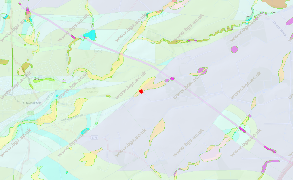

AndrewR Posted March 20, 2020 Posted March 20, 2020 I was going to post a new message, but saw this recent thread: I own a small croft in Caithness. It has a "well" on the plans of the land and on site this is apparent by an isolated area of permanently wet ground. There is no evidence of a "bubbling spring" however. I'd like to tap this water and make it accessible for domestic potable use, which will mean making good the surface access with a wellhead chamber of some sort and, I assume a small borehole with pipe and preferably hand pump. I'd like to do this myself if possible. Can you advise me on how this water source can be tapped, traditionally (i.e. by DIY and at low cost)? All I am looking at is to have something like a hand pump above the well head which I can visit to gather water. Thanks, Andrew
jamieled Posted March 20, 2020 Posted March 20, 2020 I can't link to anything directly, but it's definitely DIY able. It will be tricky if.you need.to go down.to.any depth, but it sounds like that isn't necessary. A screw auger or similar would allow you to create a hole. Sealing the well head can be simple - modify a manhole cover or something more basic - plenty of web diagrams. Preventing surface water ingress is key to minimise the treatment you need to do. Lining could use cheap perforated pipe. There are a few hand pumps around that should do down to 8m or so.

scottishjohn Posted March 27, 2020 Posted March 27, 2020 I have been studing some old OS maps for my build i have found that things marked as wells are not always wells ,maybe just "issues" for a water suppy if you have the option of a mains supply --take it drilling bore holes and then all the treatment the water might need to be drinkable --its not just UV -One man here has had to put expensive chemical filters to get rid of arsenic in the water I am pretty brave at tackiling jobs i have not done before --but a well If ground is easy to dig then it will need stone liner so it does not collapse in If it rock then you going to have to drill and ideally you want water that is not just coming from top soil ,but water that has taken time to filter down through the layers ,which help clean out the biologicals
Jeremy Harris Posted March 27, 2020 Posted March 27, 2020 11 minutes ago, scottishjohn said: I have been studing some old OS maps for my build i have found that things marked as wells are not always wells ,maybe just "issues" for a water suppy if you have the option of a mains supply --take it drilling bore holes and then all the treatment the water might need to be drinkable --its not just UV -One man here has had to put expensive chemical filters to get rid of arsenic in the water I am pretty brave at tackiling jobs i have not done before --but a well If ground is easy to dig then it will need stone liner so it does not collapse in If it rock then you going to have to drill and ideally you want water that is not just coming from top soil ,but water that has taken time to filter down through the layers ,which help clean out the biologicals The BGS website is the most reliable way to find wells/boreholes: http://mapapps.bgs.ac.uk/geologyofbritain/home.html Select the "Borehole Scans" option in the top left and then zoom right in on the map and any that are recorded will show as dots. Clicking on them will give whatever data the BGS holds.
SteamyTea Posted March 27, 2020 Posted March 27, 2020 @Jeremy Harris Is the high number of shallow wells/boreholes (0 - 10m) what farmers use for irrigation, rather than for filling toughs?
