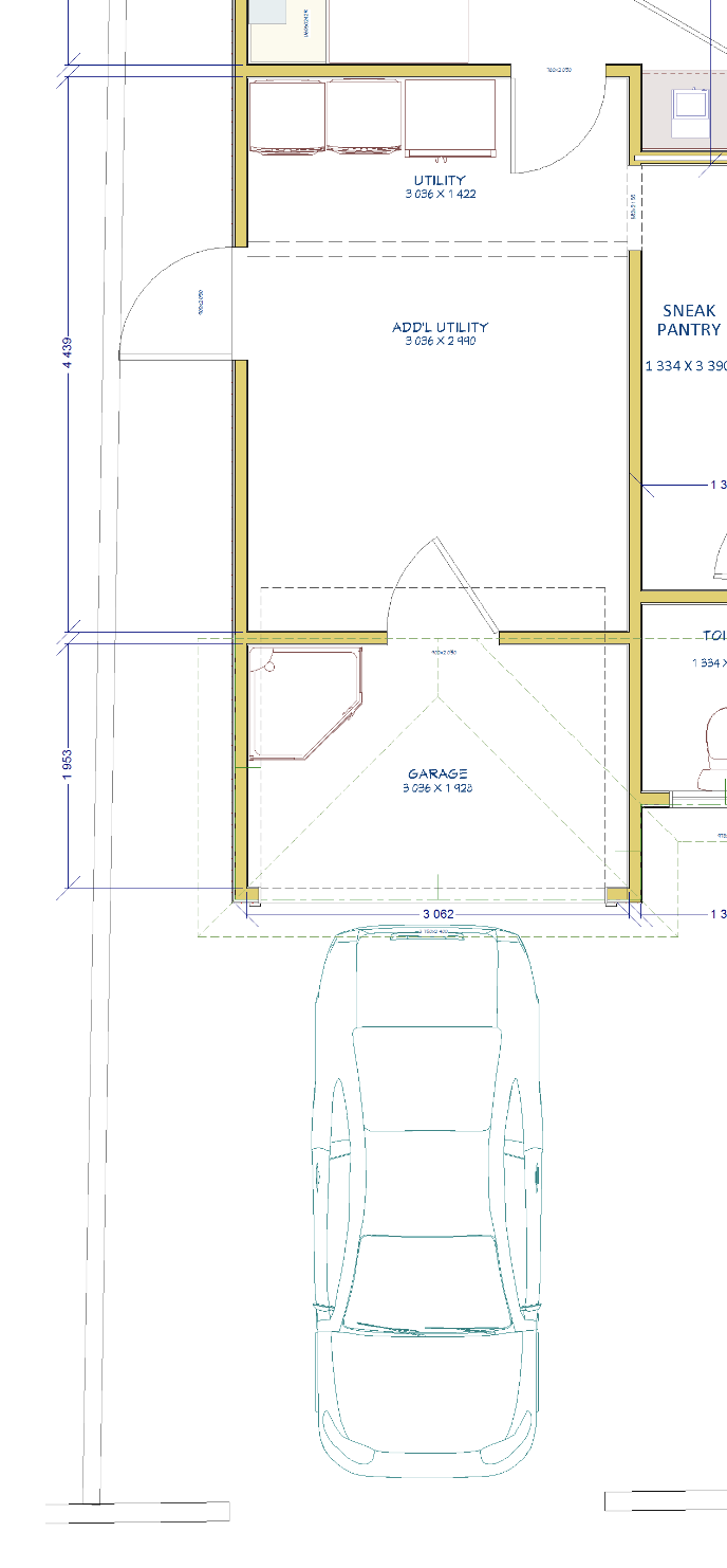

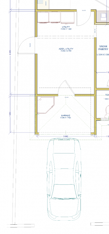

puntloos Posted November 24, 2019 Share Posted November 24, 2019 So.. the UK is weird about garages. But please challenge my claims if you disagree: First of all, for detached houses, not having a garage is a major downside, especially above a certain price (or perhaps size, fanciness level.. all intertwined). But, nobody actually uses garages for storing cars! Now I kind of get it - space is at a premium, cars are more rustproof than previously What I've done is create a garage + utility area that is specifically designed to: 1/ Fit a car outside the garage. 2/ Have a 'fake' garage - looks like one from the outside, but only 2m deep, where we can store smelly bins and bikes, but no (normal) car. 3/ Have a large utility room. But - if one wants an *actual* garage, you can move the internal (2m deep) wall all the way to the back, leaving a teensy but serviceable utility room, and space for a decent car. (5x3.2m). See here: The main compromise is that I have left only 20cm space in front of the garage to the edge of the plot for a normal midsize car (4.5m). Is that too little? 30cm? What do you think ? Link to comment Share on other sites More sharing options...

willbish Posted November 25, 2019 Share Posted November 25, 2019 My initial thought was that you'd be deceiving potential buyers if you advertised the house as with a garage. If it suits your needs and you're not planning to sell then why not. But 2 metres deep is not a garage in my eyes, maybe workshop? Is that a shower tray in the corner of the garage? Link to comment Share on other sites More sharing options...
ProDave Posted November 25, 2019 Share Posted November 25, 2019 My garage has my Landrover in it. I tell SWMBO that by doing so it reserves the space, so I can get either of the other 2 cars over the pit for an oil change whenever I want to. If it suits you to use the garage for something else, then do so, but I would make provision for another room for the "something else" instead. People do like garages even if mostly they would be better described as workshops. Link to comment Share on other sites More sharing options...
scottishjohn Posted November 25, 2019 Share Posted November 25, 2019 If you really want a transformer garage then dig a basement under it as your junk/service room I am suprised with the space premium in modern house plots these days that more do not have a basement for junk+services Link to comment Share on other sites More sharing options...
Ferdinand Posted November 25, 2019 Share Posted November 25, 2019 Certainly something I have seen; one was called a half-garage. Particularly in newish houses, where built-in store cupboards are missing as they can reduce measured room size. @SteamyTea could call it a "Smart Car" Garage. You need to decide what you call it in planning / building regs, and how you handle the conversion and future potential uses - which may require PP or Regs sometimes. Or you may choose to ignore that. Obviously you need to do things like consider ufh if required, and putting your joists along the top of potential stud walls etc. Also, calling it a garage may count against your required Planning Policy parking space quota if it is large enough - think it needs to be 6m x 3m, but check. For this plan, would need to be slightly wider and be called a "garage" in its entirety. You then need to be aware is required spaces minus one will be enough for you. I think the current dimensions commit you to chucking out the passengers in the rain, and reversing in only for a RH Drive car. So, really just map out your possible future plans carefully, and do not put stuff on the plans you do not want to have known. Dirty bikes? Unconscionable :-). Wash them ?. Ferdinand Link to comment Share on other sites More sharing options...
Ferdinand Posted November 25, 2019 Share Posted November 25, 2019 14 minutes ago, Sensus said: What are you going to do about the mandatory 100mm (minimum) step down from the connecting door to the dwelling? I think a fall away from the house door is an acceptable alternative. Make a flat section by the door so that wheelchair users have no risk of rolling away whilst opening the door. 1 Link to comment Share on other sites More sharing options...
Bitpipe Posted November 25, 2019 Share Posted November 25, 2019 21 minutes ago, scottishjohn said: If you really want a transformer garage then dig a basement under it as your junk/service room I am suprised with the space premium in modern house plots these days that more do not have a basement for junk+services Agree - I have a full footprint basement including plant room. Plenty of junk (that i'm trying to get rid off) and two teenagers (they will go once the junk is sorted). Link to comment Share on other sites More sharing options...
Jeremy Harris Posted November 25, 2019 Share Posted November 25, 2019 I'd guess that it should be possible to build a solid garage floor that's a fair bit lower than the house floor, then cover that with an insulated floor to bring it up level with the other habitable areas when it's part of the utility room. If there's a need to convert that space back to a garage, then remove the raised flooring along with the partition wall. 2 Link to comment Share on other sites More sharing options...

puntloos Posted November 26, 2019 Author Share Posted November 26, 2019 (edited) On 25/11/2019 at 06:49, dpmiller said: what car do you have now and what will the next one be? Every generation gets bigger... My current car is a Nissan Leaf, exactly the size I made the car in the picture. Cars getting bigger.. mm.. I see two trends 1/ People wanting larger cars for bad reasons ("I am such a crap driver I need a tank so if I hit someone at least me and my little angel will be safe".. surely nobody else will ever think of this upon which this will be tank wars) 2/ Large cars being penalised for carbon footprint reasons. The more weight you need to pull around the more expensive. People needing larger cars for good reasons I figure will stay the same since those reasons (I need space to transport my X) also don't change too much, if anything families are getting smaller and smaller. On 25/11/2019 at 08:23, scottishjohn said: If you really want a transformer garage then dig a basement under it as your junk/service room I am suprised with the space premium in modern house plots these days that more do not have a basement for junk+services Basements, even 'unused' ones are really expensive though, no? I have the impression that a 'garage sized' basement is 50,000? On 25/11/2019 at 07:55, willbish said: My initial thought was that you'd be deceiving potential buyers if you advertised the house as with a garage. If it suits your needs and you're not planning to sell then why not. But 2 metres deep is not a garage in my eyes, maybe workshop? To be clear it wouldn't be a garage with the 2m wall depth, but if the wall is movable (perhaps even moved by us..) the new size would be 5.0x3.2m Quote Is that a shower tray in the corner of the garage? Yes, to scrub the dog/kid/gimp Edited November 26, 2019 by puntloos Link to comment Share on other sites More sharing options...
puntloos Posted November 26, 2019 Author Share Posted November 26, 2019 On 25/11/2019 at 08:16, ProDave said: My garage has my Landrover in it. I tell SWMBO that by doing so it reserves the space, so I can get either of the other 2 cars over the pit for an oil change whenever I want to. If it suits you to use the garage for something else, then do so, but I would make provision for another room for the "something else" instead. Sadly my main constraint is space. My plot is tiny, and any new room will eat into the garden.. On 25/11/2019 at 08:16, ProDave said: People do like garages even if mostly they would be better described as workshops. Exactly, I think a garage is probably a good idea On 25/11/2019 at 08:23, Sensus said: What are you going to do about the mandatory 100mm (minimum) step down from the connecting door to the dwelling? I'm not quite sure what this means. I assume you mean that the garage has to be 100m lower than the main dwelling? I guess implement it as if it were a full garage, but fill it with some fake floor if not using it for that purpose? On 25/11/2019 at 08:34, Ferdinand said: Certainly something I have seen; one was called a half-garage. Particularly in newish houses, where built-in store cupboards are missing as they can reduce measured room size. @SteamyTea could call it a "Smart Car" Garage. You need to decide what you call it in planning / building regs, and how you handle the conversion and future potential uses - which may require PP or Regs sometimes. Or you may choose to ignore that. My current idea is to apply for planning permission for a full garage but just mess around with the internals e.g. leave out the main garage door and have a carport. On 25/11/2019 at 08:34, Ferdinand said: Obviously you need to do things like consider ufh if required, and putting your joists along the top of potential stud walls etc. Fair point thx. On 25/11/2019 at 08:34, Ferdinand said: Also, calling it a garage may count against your required Planning Policy parking space quota if it is large enough - think it needs to be 6m x 3m, but check. For this plan, would need to be slightly wider Are you sure? Current design width is 3.2m.. I guess it depends on the council too? On 25/11/2019 at 08:34, Ferdinand said: and be called a "garage" in its entirety. You then need to be aware is required spaces minus one will be enough for you. I think the current dimensions commit you to chucking out the passengers in the rain, and reversing in only for a RH Drive car. Mostly, yes. On 25/11/2019 at 08:34, Ferdinand said: So, really just map out your possible future plans carefully, and do not put stuff on the plans you do not want to have known. Dirty bikes? Unconscionable :-). Wash them ?. Ferdinand Fair point, and indeed, the 'resale value' is quite secondary for me.. of course I don't want to do something that absolutely ruins it but .. Link to comment Share on other sites More sharing options...
