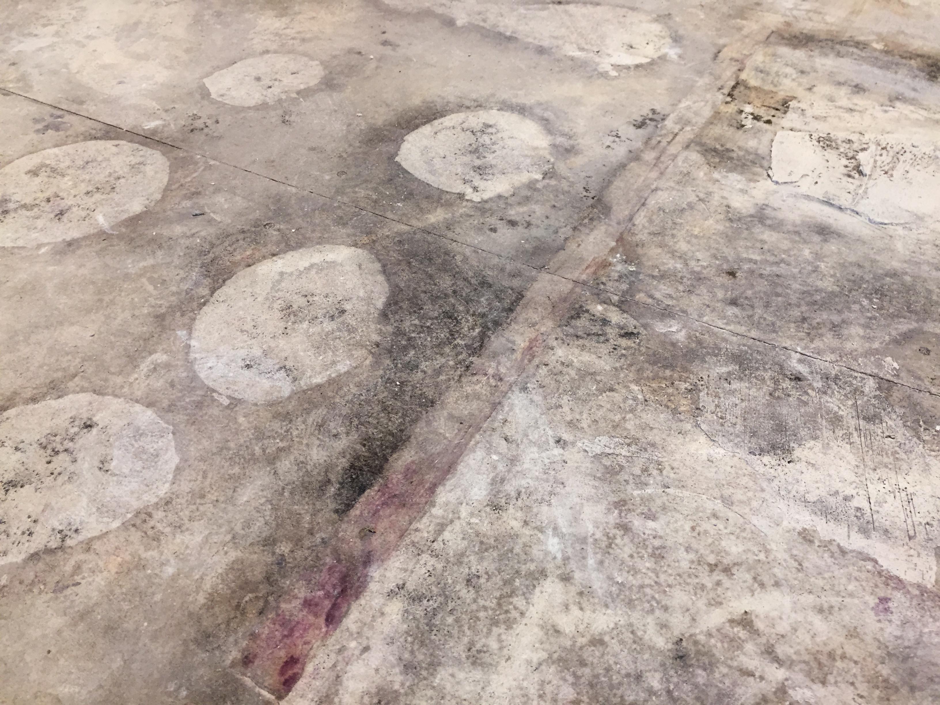

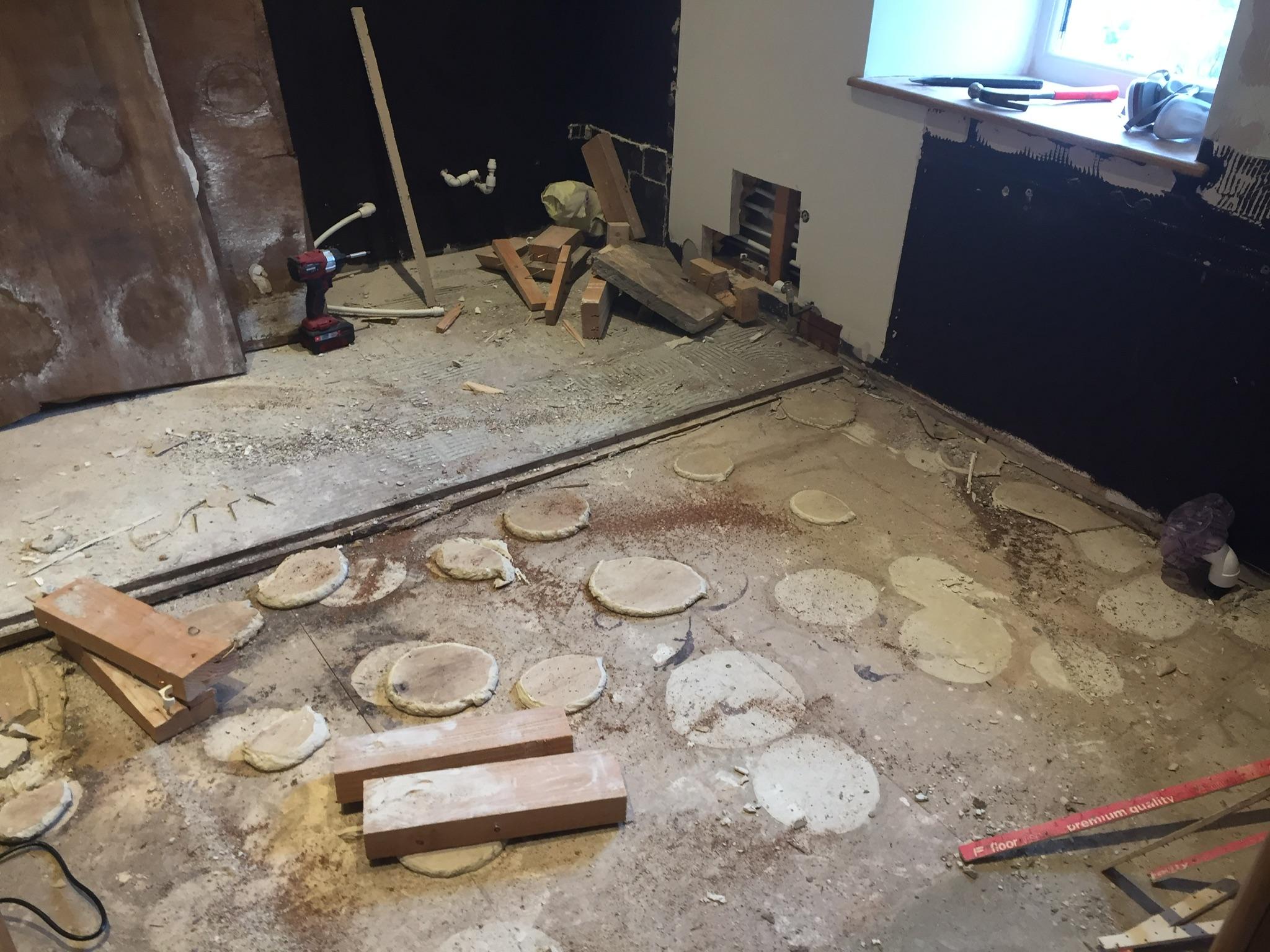

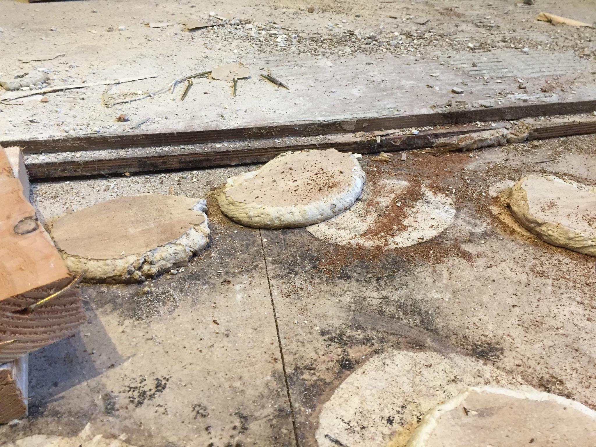

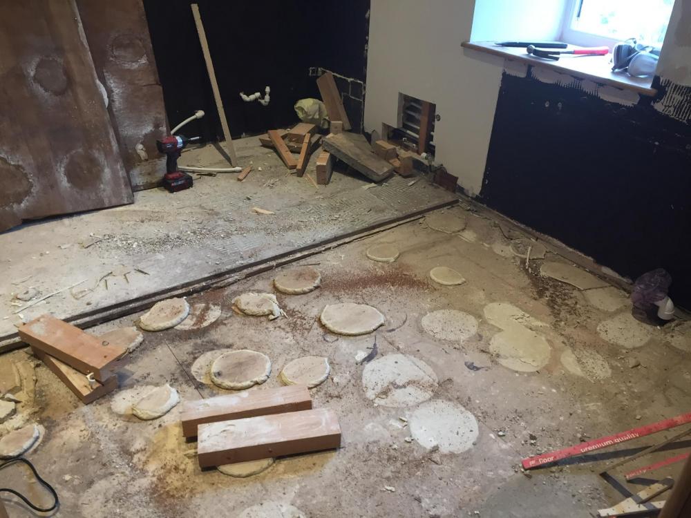

H F Posted November 20, 2019 Share Posted November 20, 2019 I have completed gutting our master bathroom and built our stud wall in a new recessed area for our shower. i have some initial questions and will no doubt have more. I removed the old ply that the tiles were stuck to. It was laid on pats (see photo) that were made from grout. Is that normal? What’s the advised method to lay even ply on the existing uneven floor? There’s also black stuff in one area that look like mould. Should I treat this somehow? Link to comment Share on other sites More sharing options...

Tennentslager Posted November 20, 2019 Share Posted November 20, 2019 Ooft goodness me... I thought that was a picture of the mould and thought by f¥ck that’s serious! mega big mushrooms under your floor 1 Link to comment Share on other sites More sharing options...
PeterW Posted November 20, 2019 Share Posted November 20, 2019 So that’s a whole new one on me ..... board on tile adhesive ..??! get that lot up, use a floor scraper and then mop over it with a 20% cheap bleach solution and let it dry. Then glue and screw down 9mm ply as a minimum and use latex based self leveling compound to finish it off. Link to comment Share on other sites More sharing options...

H F Posted November 20, 2019 Author Share Posted November 20, 2019 32 minutes ago, PeterW said: So that’s a whole new one on me ..... board on tile adhesive ..??! get that lot up, use a floor scraper and then mop over it with a 20% cheap bleach solution and let it dry. Then glue and screw down 9mm ply as a minimum and use latex based self leveling compound to finish it off. Thanks. I’ll do that. When the ply is on, we are going to out down an underlay and out a click system on top that. That should make it feel good and solid. Link to comment Share on other sites More sharing options...
