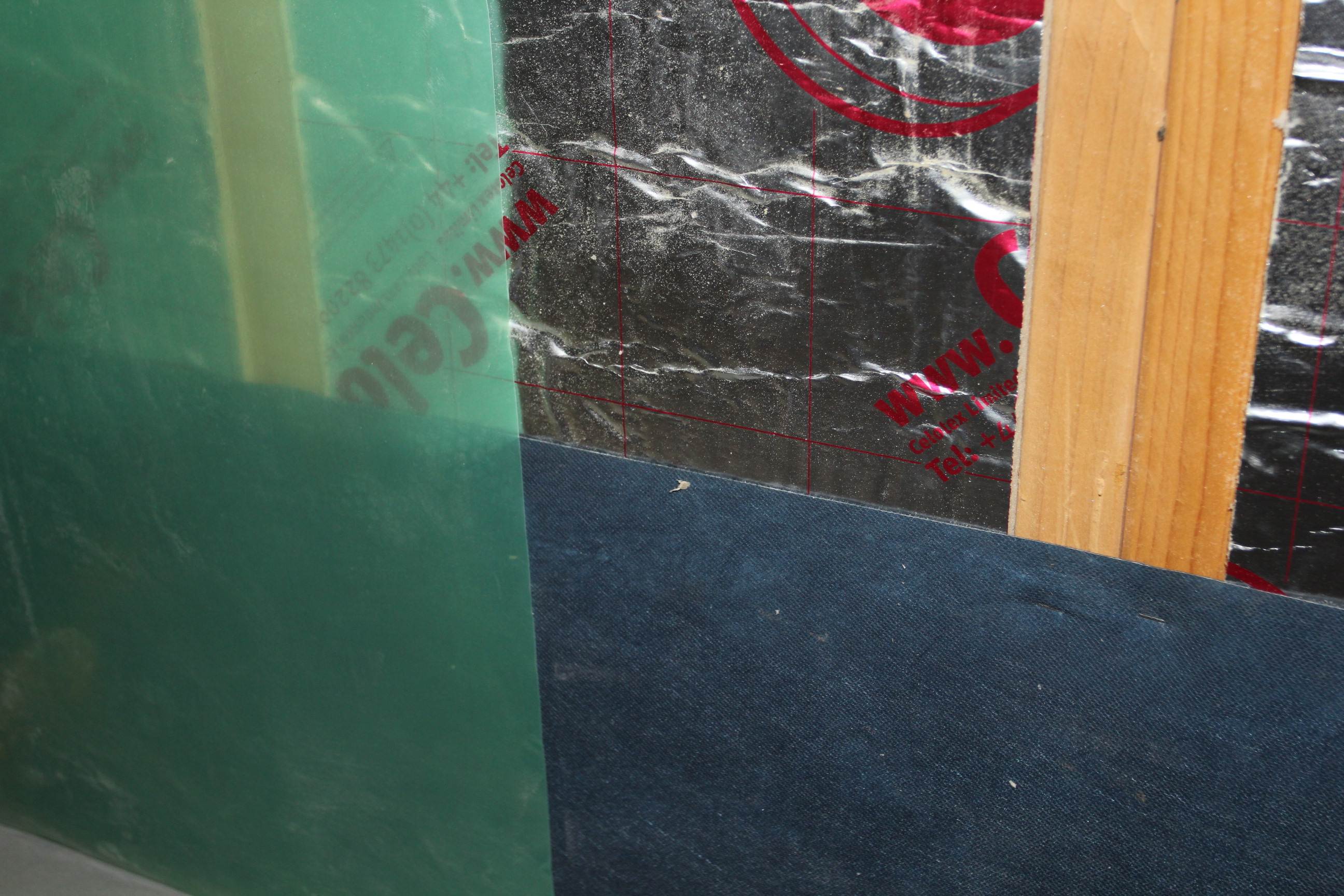

CC45 Posted January 22, 2017 Author Share Posted January 22, 2017 Resurrecting this post due to wanting some advice on my VCL. The attached picture shows upstairs - celotex as insulation, green VCL & the 'Tony tray' from the room below. I'm taping all the joins when two strips of plastic overlap; horizontal battens to go on top yet - to give a services cavity. My query is this - should I also tape the 'Tony tray' to the insulation? I intend to tape the plastic to the floor (Siga tape used throughout) - so I'm not too sure taping the 'Tony tray' is necessary but I'd welcome you thoughts. Cheers CC Link to comment Share on other sites More sharing options...
ProDave Posted January 22, 2017 Share Posted January 22, 2017 I am doing much the same, but do not tape the VCL to the floor, cut it a bit shorter, and tape the VCL to the tony tray. You can save quite a bit of material, the VCL only needs to come just below the top of the tony tray, say 100mm overlap. Why horizontal battens for the service void? that will make fitting the PB a bit harder won't it? I am having vertical service void battens following each wall stud. Link to comment Share on other sites More sharing options...
CC45 Posted January 22, 2017 Author Share Posted January 22, 2017 Hi Dave, Going to bring green vcl down to virtually the floor (timber frame errectors were a but careless in a few places and put holes in the tony tray material, I'm happy to use a bit more vcl to get peace of mind. Horizontal battens to minimise cold bridging, no other reason. Like you I'm doing the lot on our build so I'm willing to spend a bit more time on the boarding. Cant wait for that day to arrive to be honest, progress is slow when you're on your own and have a full time job as well. Cheers for replying. Link to comment Share on other sites More sharing options...
Declan52 Posted January 22, 2017 Share Posted January 22, 2017 Don't forget to put a fold in it before you attach it to the floor. It will allow the floor and roof to shrink and expand and not rip the vcl. 1 Link to comment Share on other sites More sharing options...

TerryE Posted January 22, 2017 Share Posted January 22, 2017 8 minutes ago, Nickfromwales said: A, er, friend of mine wanted to know what a Tony Tray is? Thought id ask, being a good mate and that Gotcha!!! Not paying attention! http://www.tonyshouse.readinguk.org/tony.htm Not sure Tony invented it, because this sort of wrap is pretty standard on timber constructions, though most block-built houses are just allowed to leak from what I see 1 Link to comment Share on other sites More sharing options...
