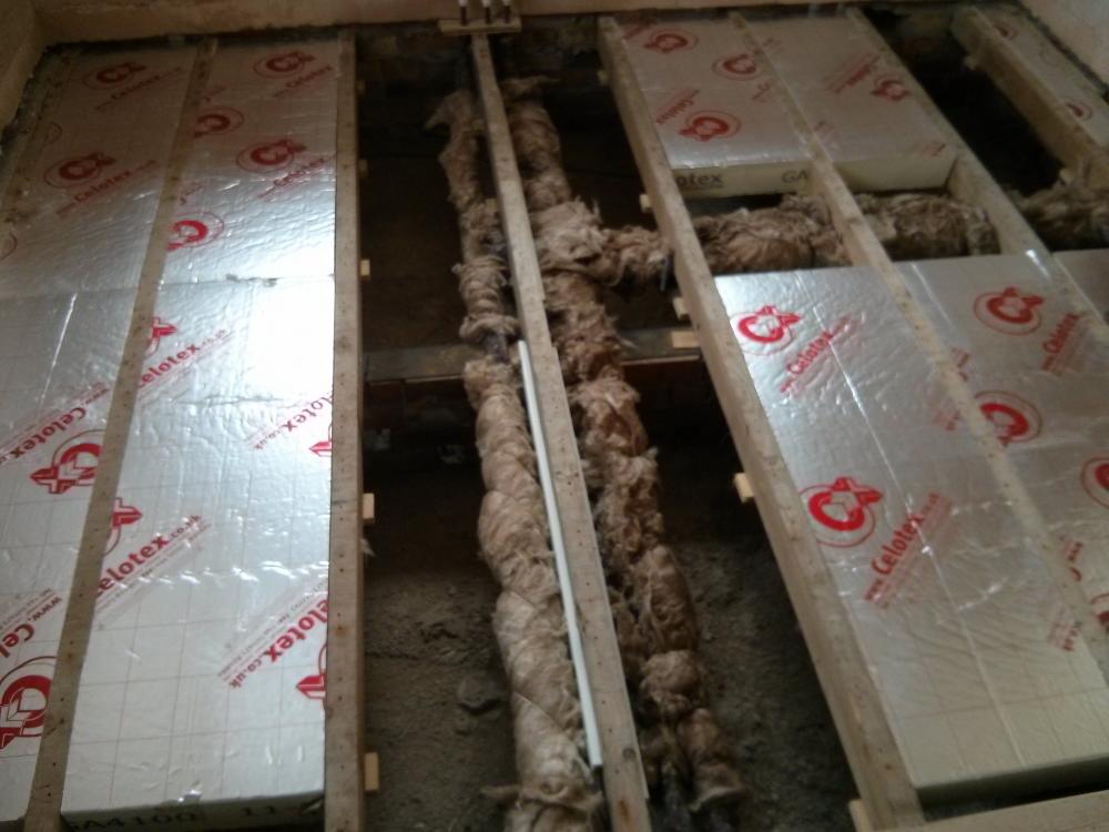

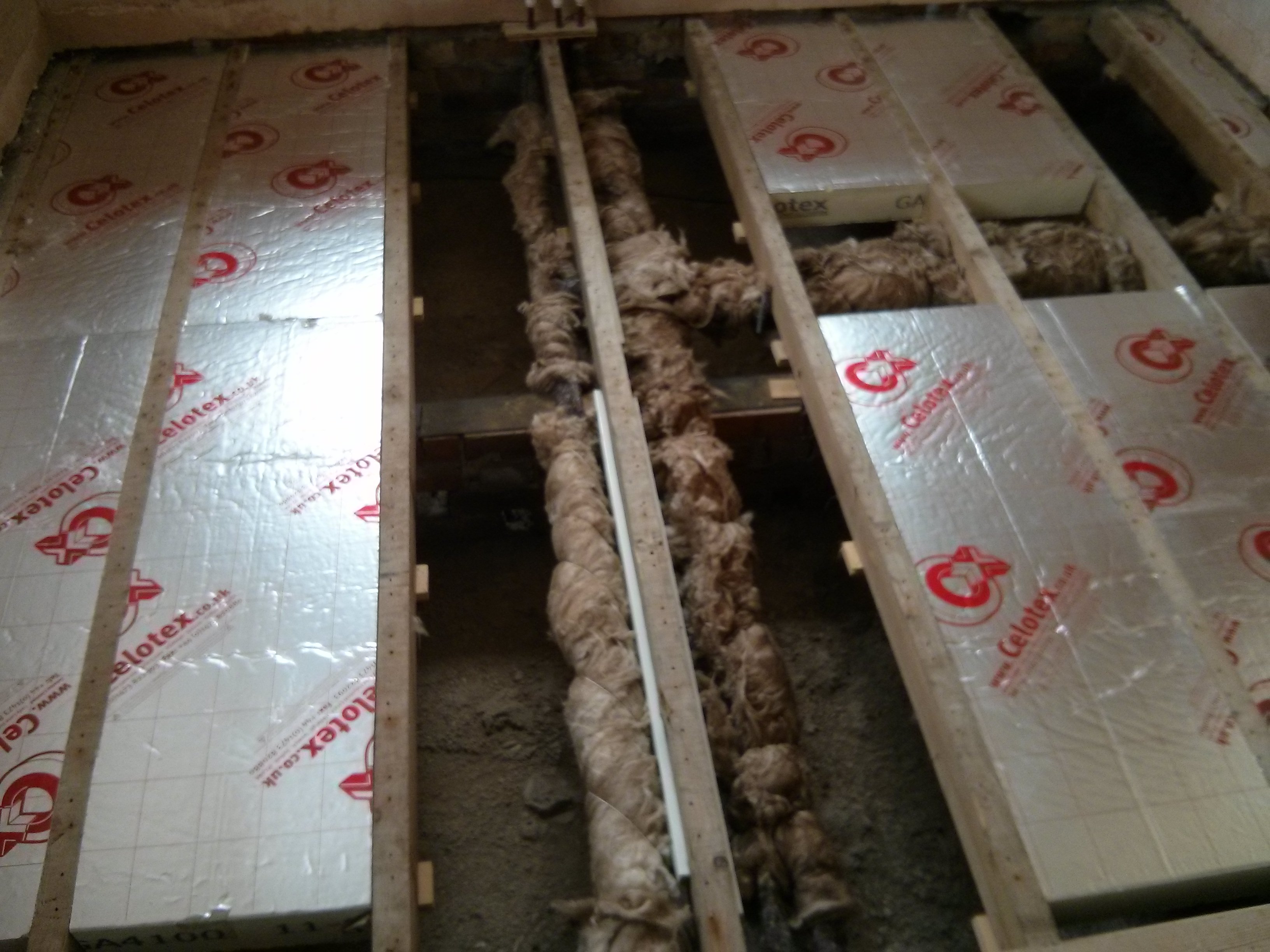

  8. 1977 bungalow, suspended timber floor over site concrete 75mm below joists (plumbers just love crawling about in there). Okay, so we've pulled up the floorboards, cleaned up underneath (yes, really!), lagged the plumbing with extra glass fibre, and put in 100mm Celotex GA4100 between the joists with more glass fibre stuffed into any gaps around the perimeter. Original idea was to tape across joists and all Celotex joins but when we looked at that we thought a vapour barrier would be easier. (Ha, if only.....) Anyway, our friendly local BCO was out to have a look and I posed the question do we really need a vapour barrier. A certain amount of discussion ensued involving possible condensation (would be under the Celotex and just drip onto the subfloor) and any above floor leakages. The eventual conclusion was not to fit the vapour barrier because potentially that could just act as a pond collecting water which would rot flooring, kitchen cabinets and the like because the water would have nowhere to run. I think I am okay with that but I just wondered what you may think? It seems this goes against much of the advice I have come across.
