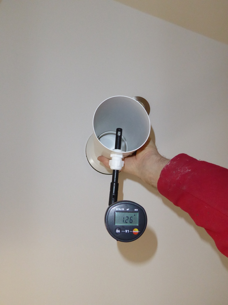

Jeremy Harris Posted April 23, 2017 Posted April 23, 2017 Mine is currently on loan, but you're welcome to be the next on the list to borrow it if you wish. @DH202020 has it at the moment, but it may be that he will have finished with it by the time you need to do some measurements. It's a Testo hot wire anemometer, fitted to a short duct that can be held over the terminals, one by one, like this: 1
ProDave Posted April 23, 2017 Posted April 23, 2017 I was watching a "professional" ballance an mvhr system just last week. The device he was using was a wind vane anemometer, the sort with a small fan blade to measure the wind speed remote from the instrument (on a short curly cord). This was attached to a large square "funnel" large enough to go over the external intake and exhaust vents (the flower pot idea should work just as well). He used the same attachment for all the measurements including from the internal vents.

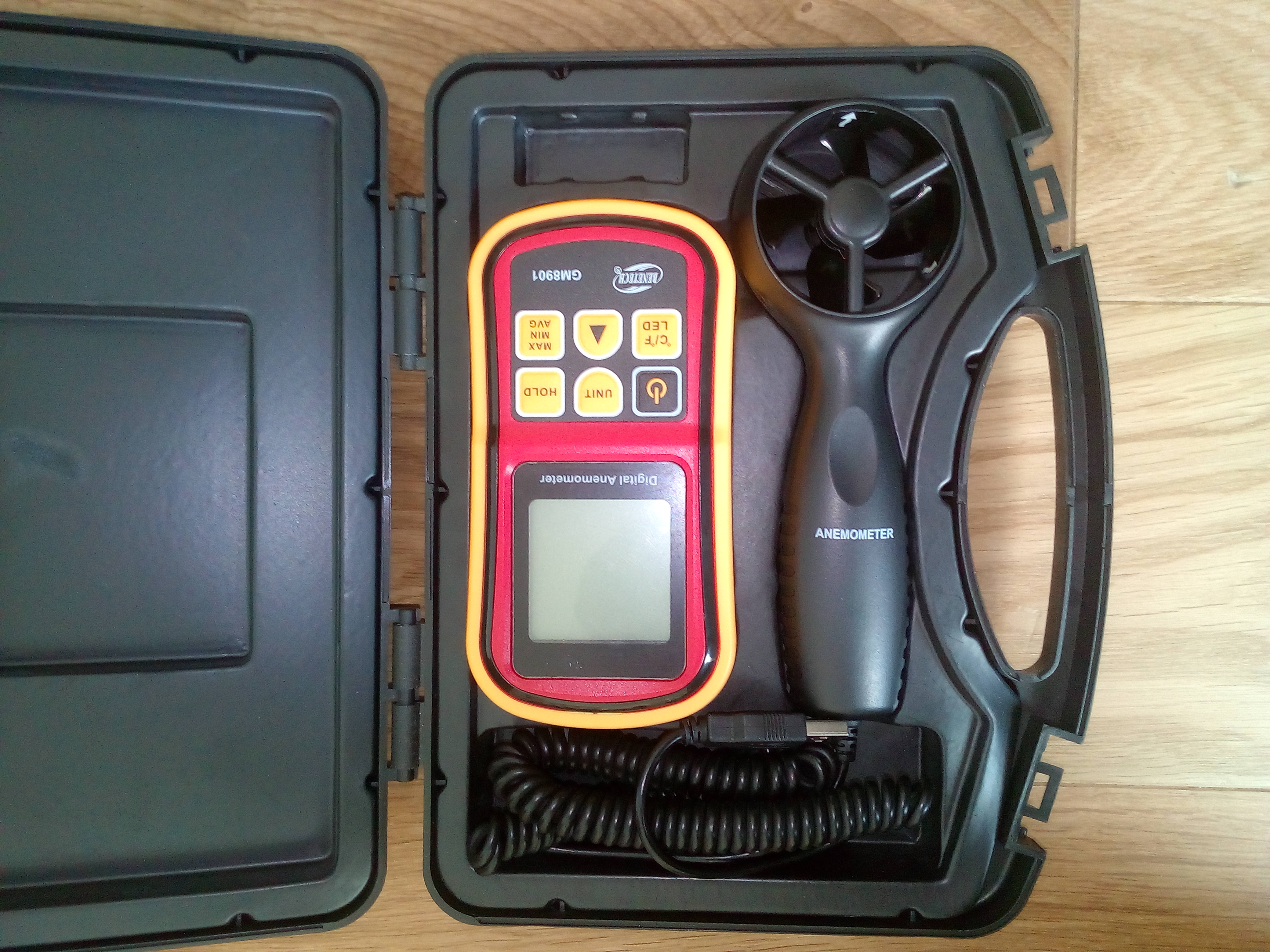

Auchlossen Posted August 1, 2017 Posted August 1, 2017 My supplier BPC has not been able to deliver on hire of test kit, and i have not found ready hire source. So... I am planning to buy a hot wire anemometer like this for £59 http://www.ebay.co.uk/itm/Digital-LCD-Hot-Wire-Thermal-Anemometer-Thermometer-Air-Wind-Speed-Meter-Tester-/381970124376?epid=1640633187&hash=item58ef318e58:g:9jsAAOSwx6pYplFP and using a length of tube or flower pot and gaffer tape to do something similar to the @JSHarris system as above. It seems that the hot wire anemometer is more accurate than the wind vane types. Do others find this method works ok for an amateur. Would anyone else like to share in the investment or buy it on from me? I was hoping to get this sorted before exiting on a recovery holiday, but it now looks likely to be implemented in mid september, since I am focused on other more pressing tasks meantime. 1

Auchlossen Posted August 2, 2017 Posted August 2, 2017 Thanks everyone. My preference is for hot wire anemometer, which I believe to be more accurate and simpler to use in a flower pot than a whirly one. and to follow the @JSHarris mode of operation. I see the one that I have specified above comes from China direct so it may take a few weeks. So thanks @Stones and @OnOff for your kind offers, but not the type that I wanted. I think I shall order it now and let Royal Mail look after it whilst I am away cycling. I will contact @Jack @RecoveringAcademic @PeterW in mid Sept and organise terms and arrange handover, if they are still interested. That's 32 tons of topsoil spread in 2 days...the shoulders are getting quite used to raking claggy soil all day.
