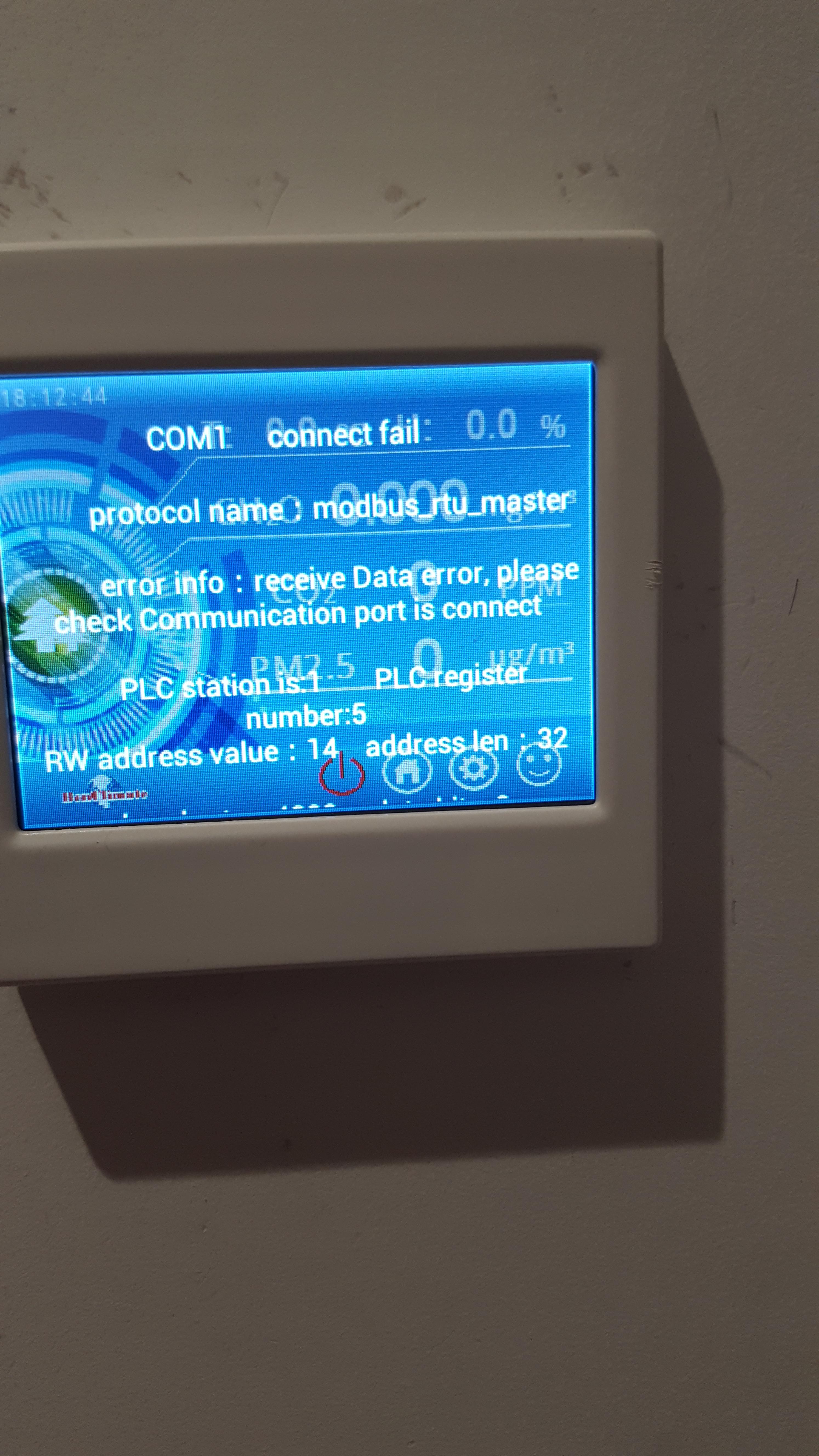

vivienz Posted November 14, 2019 Share Posted November 14, 2019 We had a brief power cut this evening with everything shutting down for about 5 minutes. Most things are fine but the MVHR won't come back on and appears to have dropped its link with the control pad. I've attached a photo of the messages on the pad. I have no idea how to re-establish this and the house is rather uncomfortable without it running. Can anyone help, please? Link to comment Share on other sites More sharing options...

MikeSharp01 Posted November 14, 2019 Share Posted November 14, 2019 Has the main unit got a reset button / switch hidden behind a tiny hole somewhere. Although looking at the message it implies that some communication blockage has occured there are no switches (network) anywhere in the system - is the panel wired direct to the main unit? Link to comment Share on other sites More sharing options...
vivienz Posted November 14, 2019 Author Share Posted November 14, 2019 Yes, the control pad is hardwired to the unit. Without taking off the internal panel covering the electronics of the main unit, I can't say whether there is a reset button. I don't want to mess with anything inside it as I have no idea what I would be doing. Link to comment Share on other sites More sharing options...
vivienz Posted November 14, 2019 Author Share Posted November 14, 2019 The control pad has a user and maintenance interface but I can'tdo anything with these as i have never been given the logins. Link to comment Share on other sites More sharing options...

vivienz Posted November 14, 2019 Author Share Posted November 14, 2019 I've switched back on but there's still no change with the control pad display and it's not talking to the main unit. I will call the manufacturer tomorrow and see if they can help. 1 Link to comment Share on other sites More sharing options...
PeterW Posted November 14, 2019 Share Posted November 14, 2019 Looks like the power trip has spiked the main board - was this weather related (power outage)..? Link to comment Share on other sites More sharing options...
