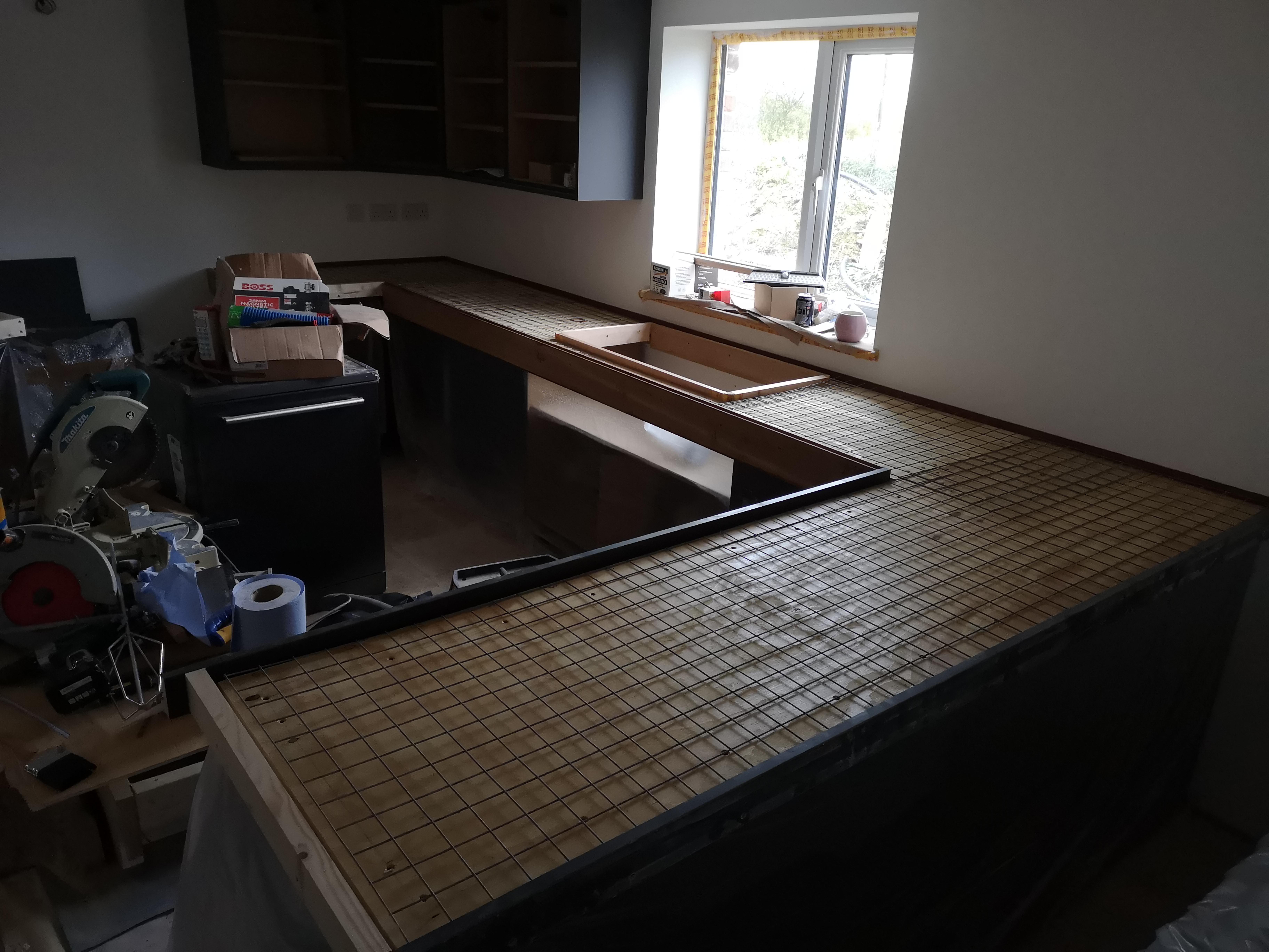

ToughButterCup Posted November 14, 2019 Author Share Posted November 14, 2019 9 hours ago, Onoff said: The vids I've watch they cast the slab upside down in a shallow box with smooth faces. All internal corners are caulked to give radiussed edges. Mesh laid in halfway thru the pour. Yes. Going skip wombling today on the way back from the gym - for waste melamine surfaces ... Link to comment Share on other sites More sharing options...

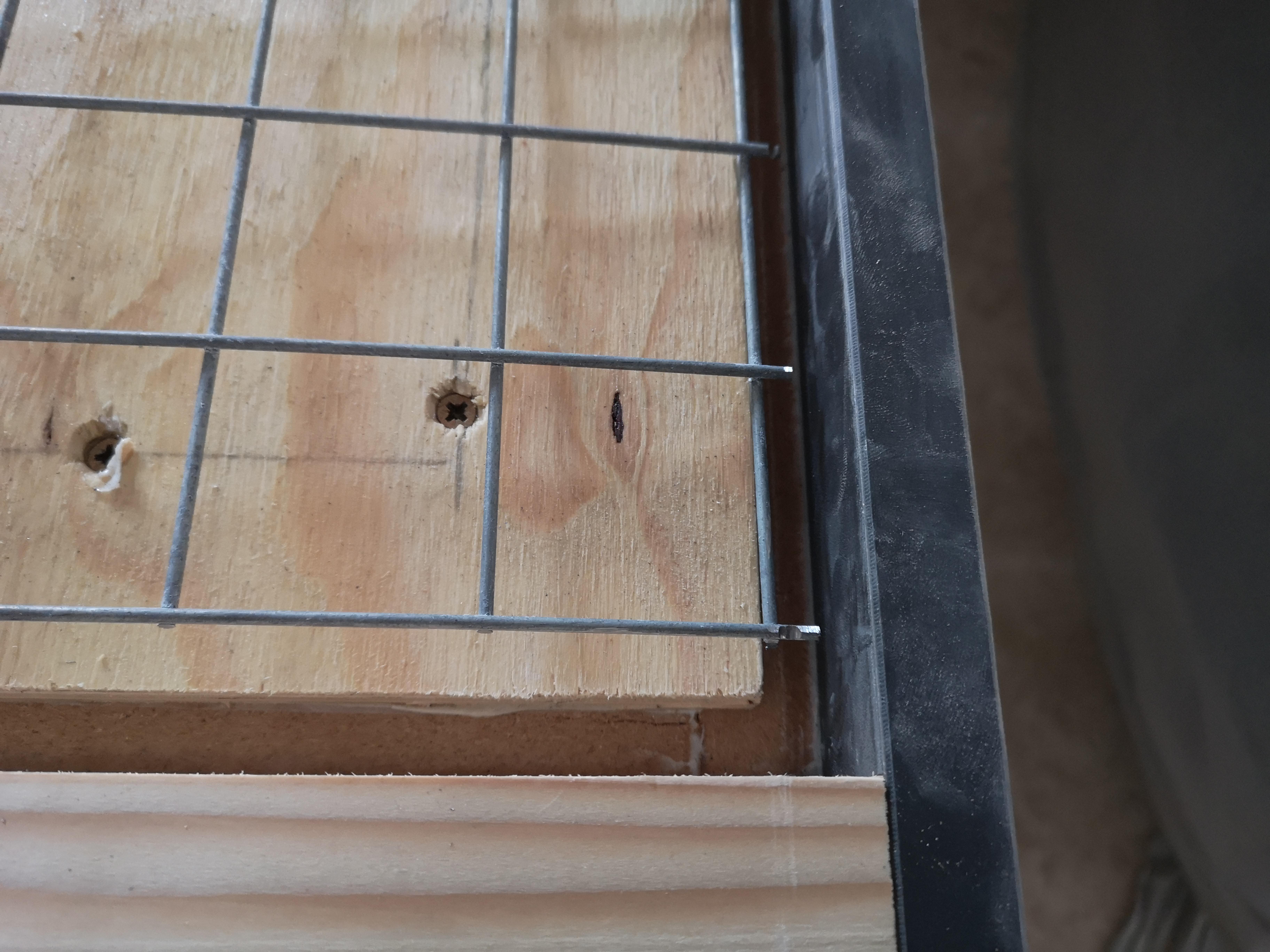

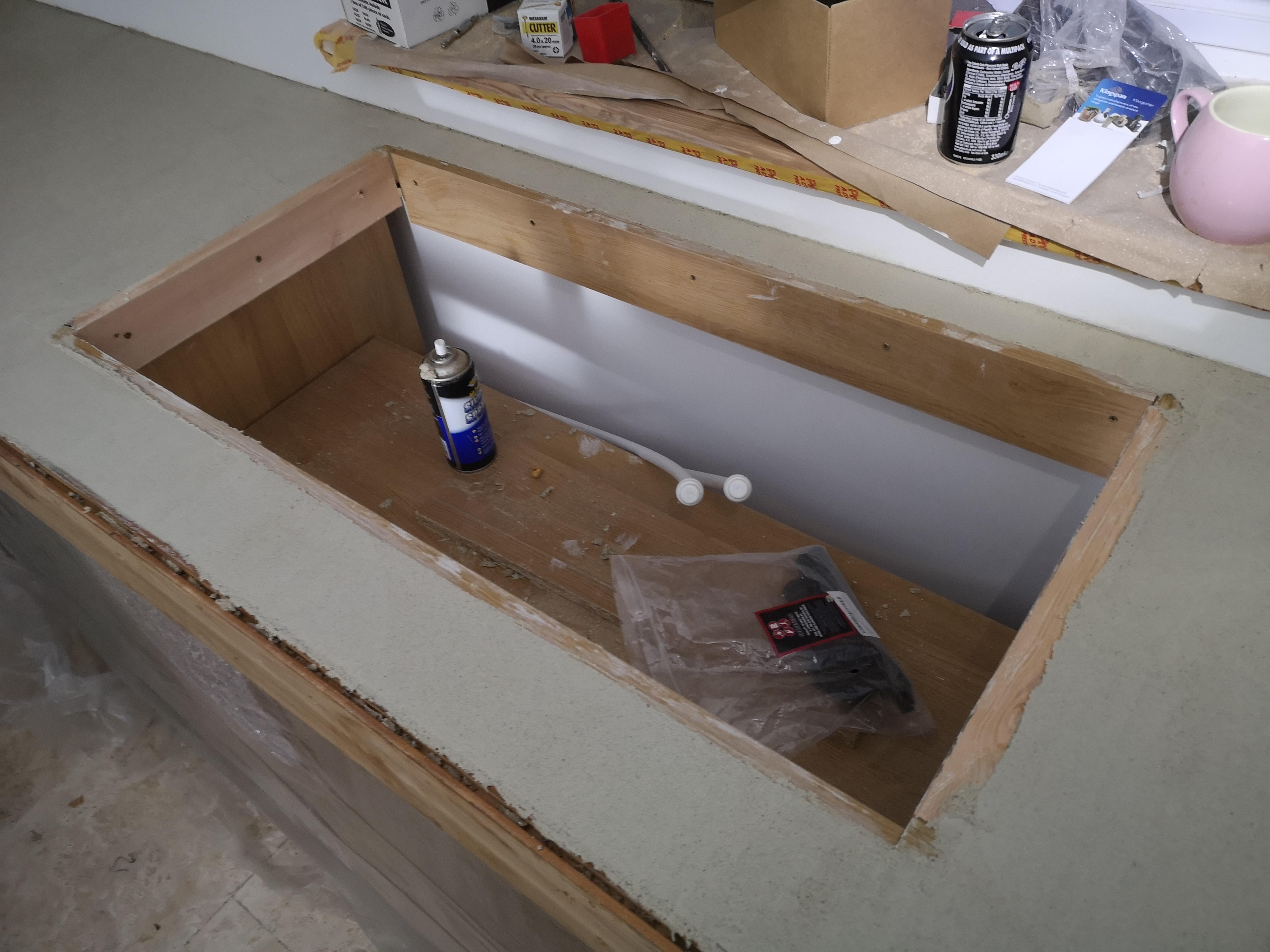

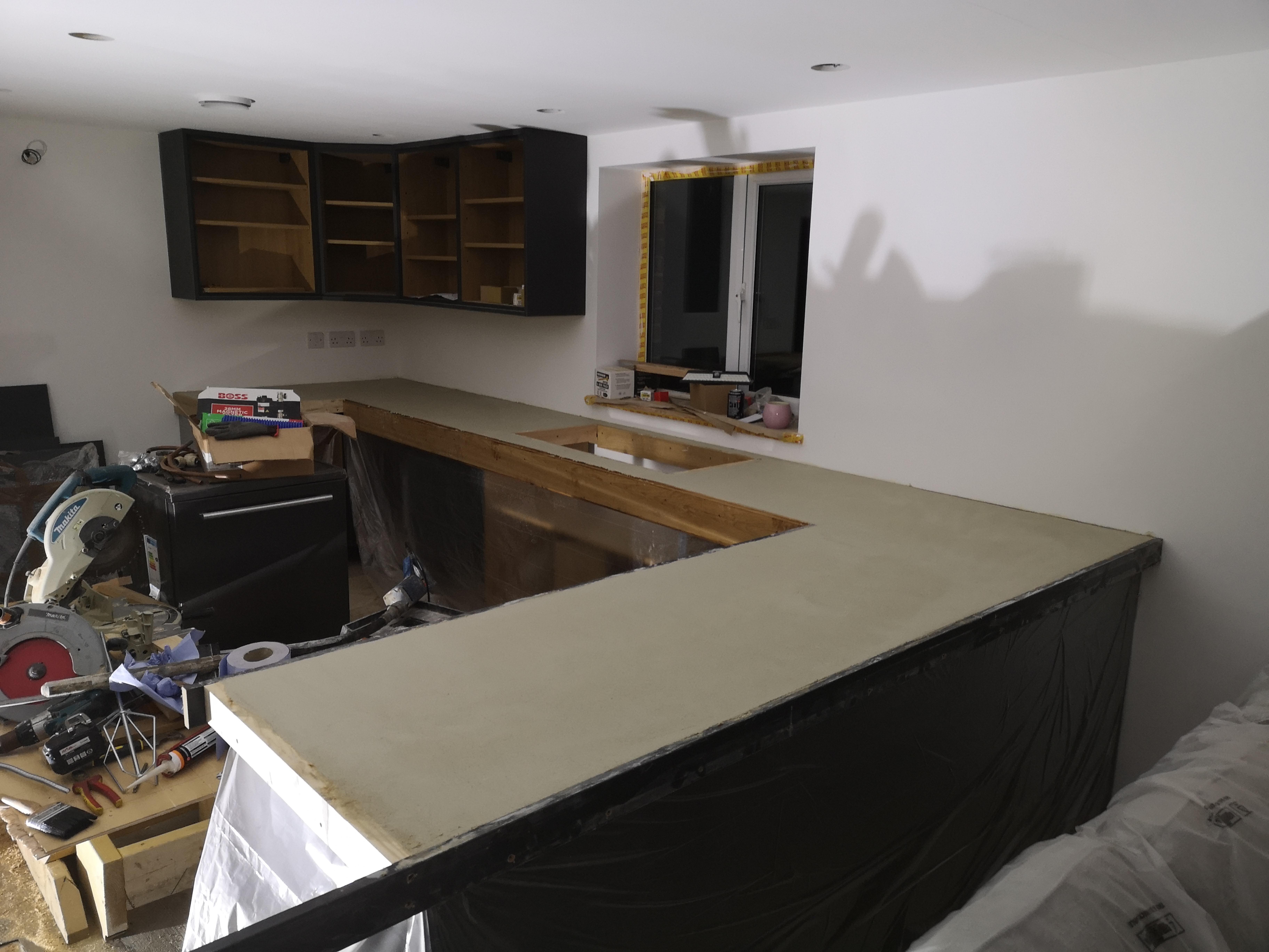

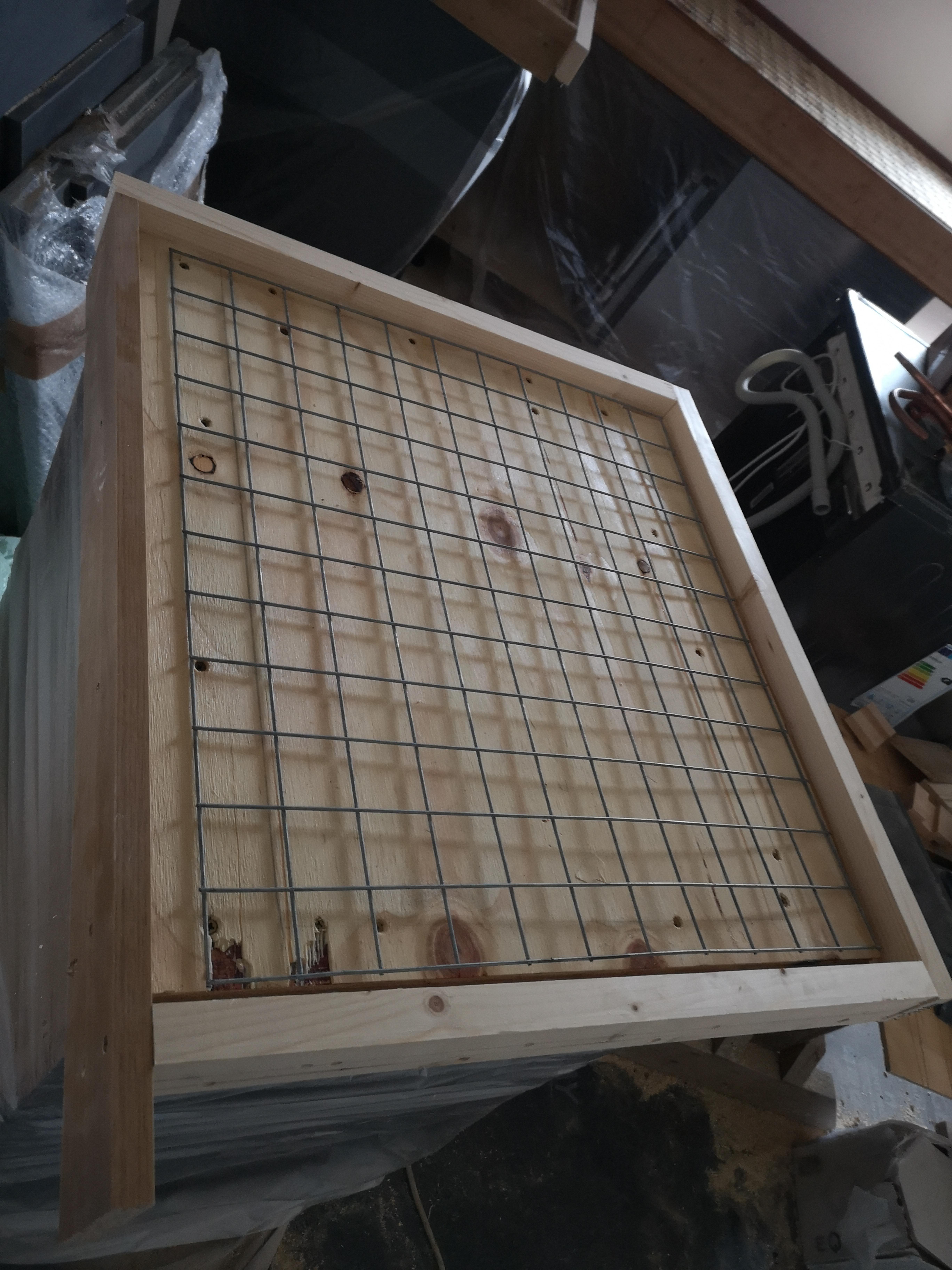

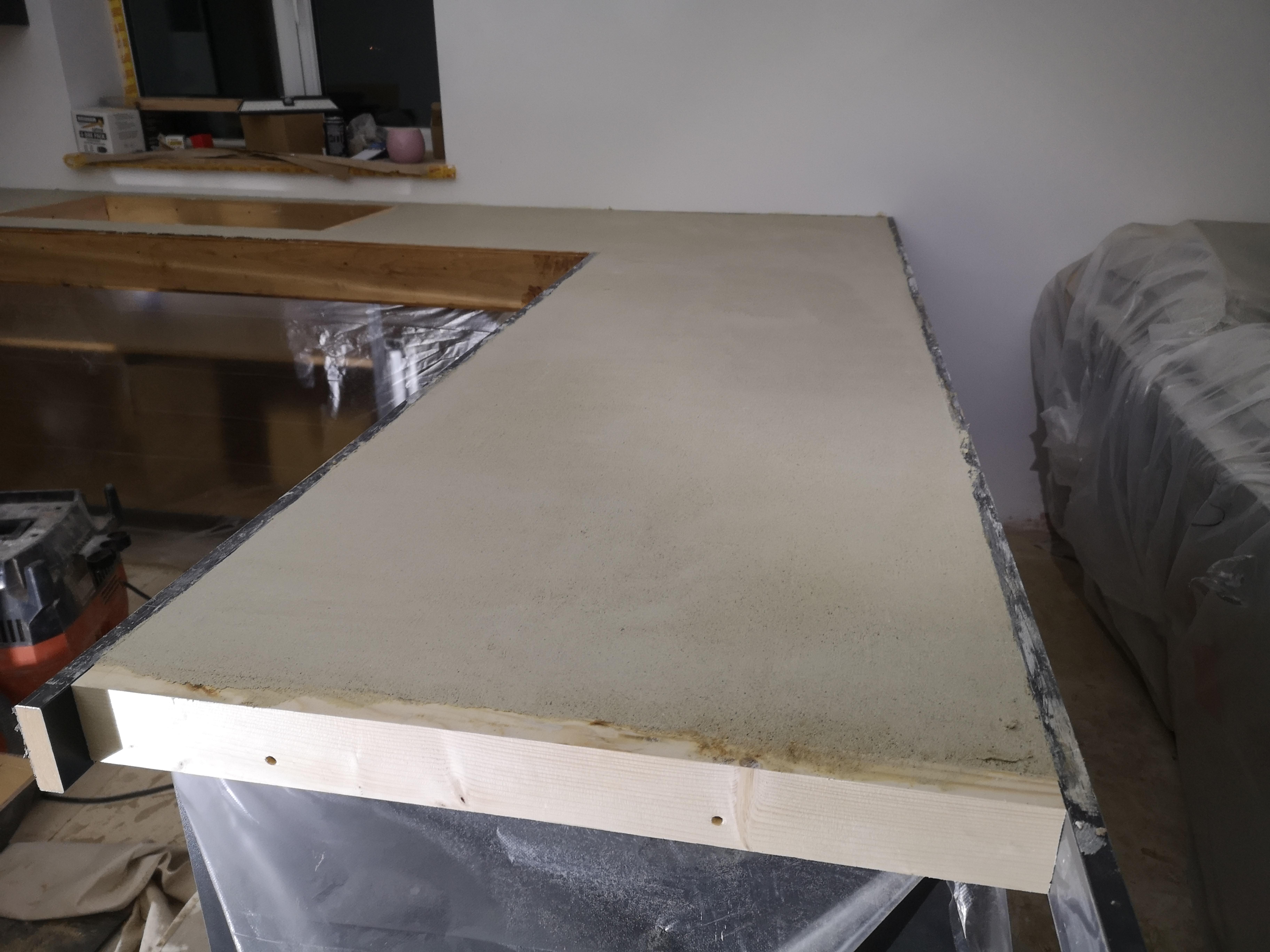

Construction Channel Posted November 16, 2019 Share Posted November 16, 2019 Just waiting for the silicone to go off..... The big pour will commence shortly. The base ply has been sbr'd as I want it to stick to the mortar. The outside formwork had been silicone release sprayed because I want it to release..... Wish me luck ?? 3 Link to comment Share on other sites More sharing options...
SteamyTea Posted November 16, 2019 Share Posted November 16, 2019 Would look good cast in clear resin. Link to comment Share on other sites More sharing options...
Construction Channel Posted November 16, 2019 Share Posted November 16, 2019 Just now, SteamyTea said: Would look good cast in clear resin. Sand and cement is cheaper ? But I'll always have resin as a backup it it all cracks up Link to comment Share on other sites More sharing options...
PeterW Posted November 16, 2019 Share Posted November 16, 2019 @Construction Channel is the plan to fill and level and allow to set then polish ..?? Link to comment Share on other sites More sharing options...
Construction Channel Posted November 16, 2019 Share Posted November 16, 2019 2 minutes ago, PeterW said: @Construction Channel is the plan to fill and level and allow to set then polish ..?? That's the plan. I thought about casting them upside down to get a better finish but I didn't like the idea of moving and jointing it. 1 Link to comment Share on other sites More sharing options...
Onoff Posted November 16, 2019 Share Posted November 16, 2019 24 minutes ago, Construction Channel said: Sand and cement is cheaper ? But I'll always have resin as a backup it it all cracks up Sand? Sharp? Link to comment Share on other sites More sharing options...
Construction Channel Posted November 16, 2019 Share Posted November 16, 2019 7 minutes ago, Onoff said: Sand? Sharp? Yup. White cement, lime and sharp, same mix as my cills 1 Link to comment Share on other sites More sharing options...

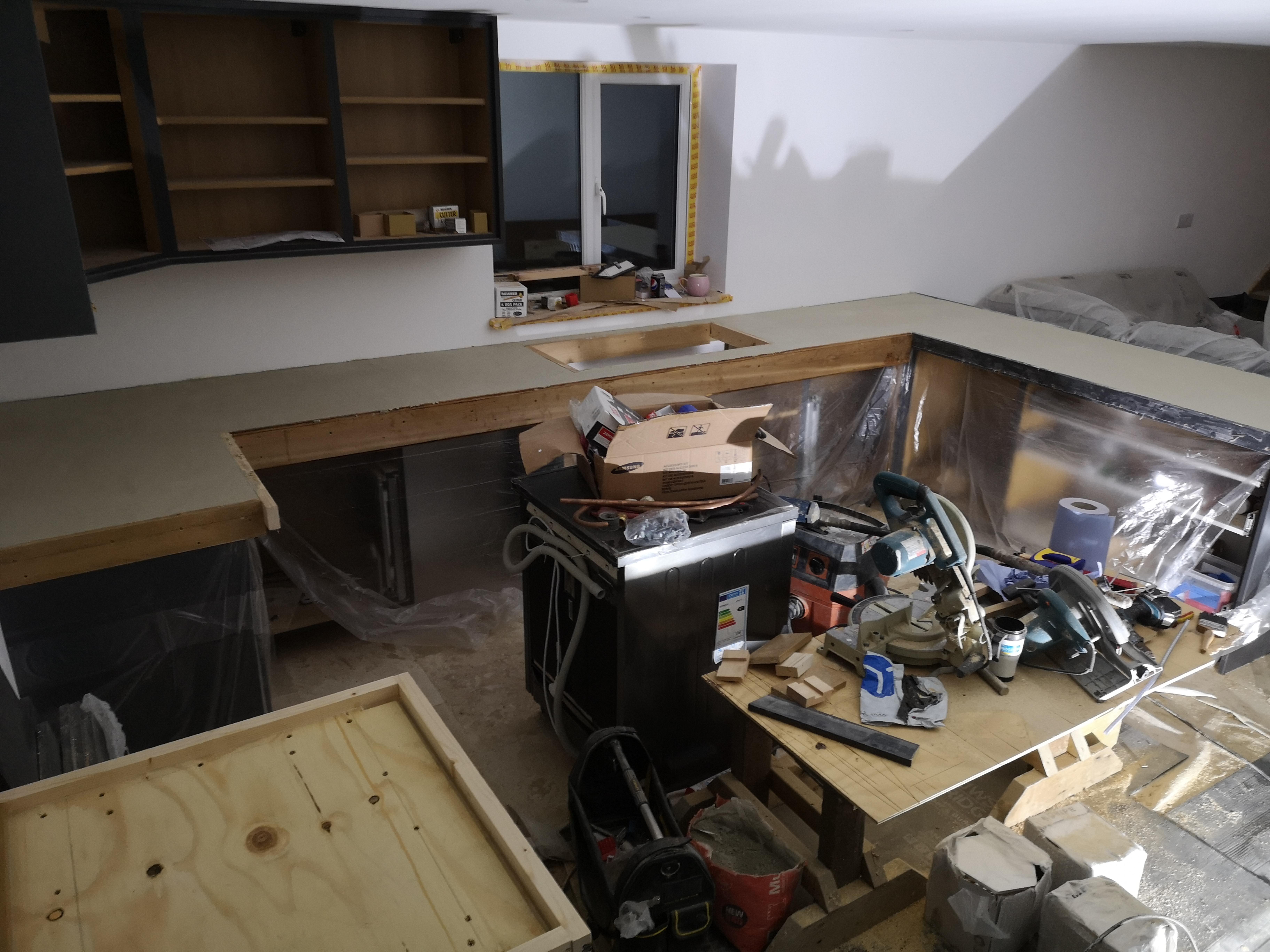

Construction Channel Posted November 16, 2019 Share Posted November 16, 2019 Well tip of the day is to buy more cement than you think you need. ? Only just had enough for the big section so the little one will be done another day 3 Link to comment Share on other sites More sharing options...

Onoff Posted November 16, 2019 Share Posted November 16, 2019 I think one main reason for doing them upside down is so you can do a silicone filet around the base and end up with a well consolidated, rounded front edge. Link to comment Share on other sites More sharing options...
