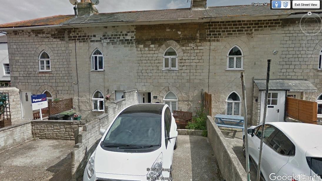

SteamyTea Posted November 13, 2019 Share Posted November 13, 2019 Portland cement is named after Portland stone, because it looks similar. I had a Portland stone house in Weymouth. Was well stained and grubby. Still is by the looks of it. Link to comment Share on other sites More sharing options...

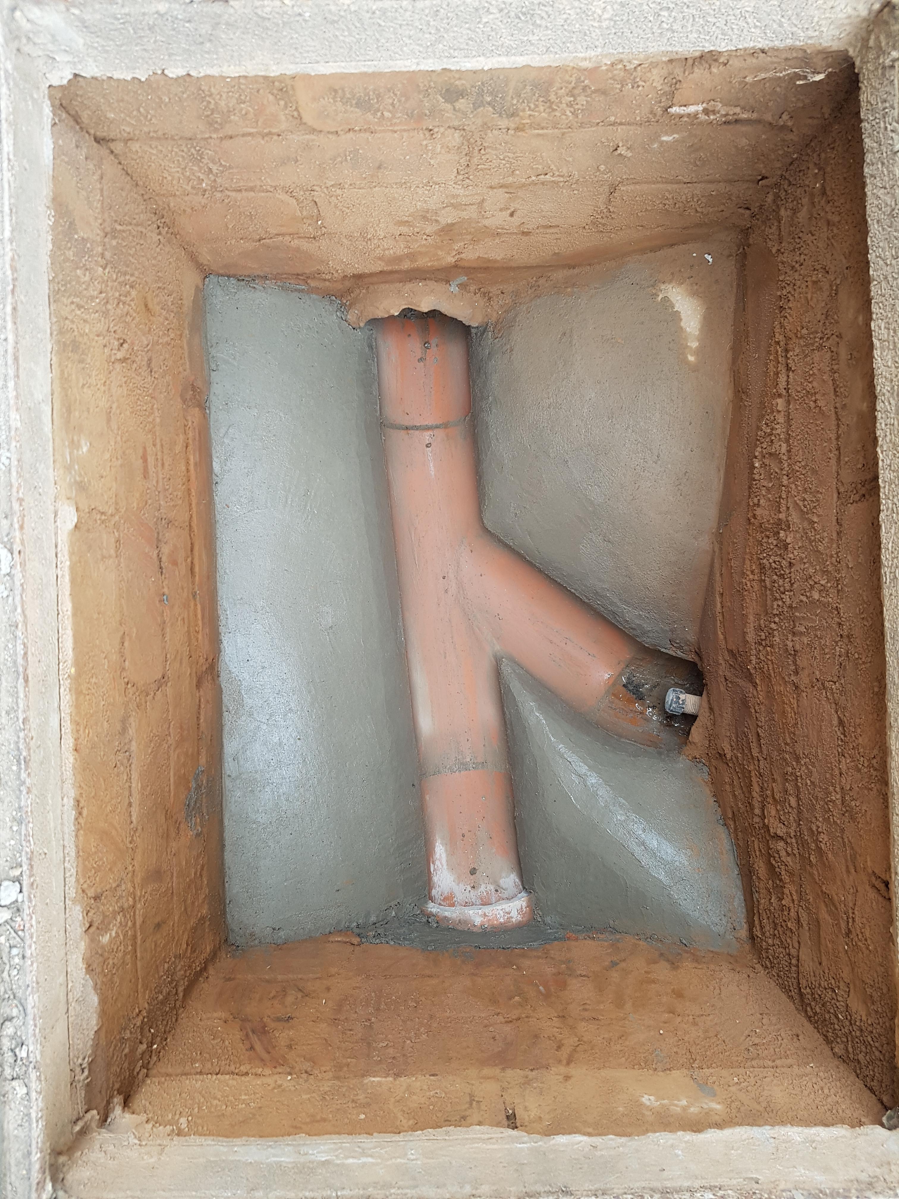

Oz07 Posted November 13, 2019 Share Posted November 13, 2019 Maybe more a grano mix would be suitable. Bit of dusty granite chippings and sand with cement. Same as a drainage benching mix. Then some additives to help finish sbr or waterproofs. Link to comment Share on other sites More sharing options...
Oz07 Posted November 13, 2019 Share Posted November 13, 2019 Link to comment Share on other sites More sharing options...
Onoff Posted November 13, 2019 Share Posted November 13, 2019 11 minutes ago, Oz07 said: +1 Did similar with the wet room corner mix. 10mm pea shingle and heavy on the sbr PLUS added fibres. Link to comment Share on other sites More sharing options...
