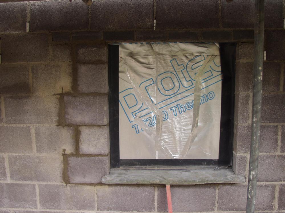

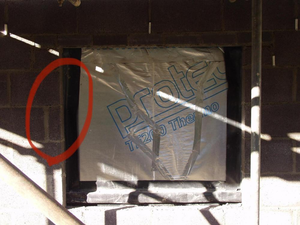

zoothorn Posted November 15, 2019 Author Posted November 15, 2019 1 minute ago, PeterStarck said: I can't see the problem. It's a total of 2150-920=1230mm difference. 600mm each side or the whole 1230mm on one side. It can still be blocked up without ties or put some noggins in the frame and tie onto those if necessary. Bugger sorry. 1150mm. (Did I say 2150?? I HATE mm's.. I'm a cabinet maker using inches 365 days/ year you see). Block window opening 1150mm. This is made. Lintel is on. All blockwork is completed now. Its has dpc behind (in the cavity) corresponding with the 1150mm W x 950mm H opening. Behind this is the Timber Frame wall.. like a blank/ as its opening not been made yet. 1150 opening. I want 920mm = 230mm difference to make up.. on one side only.

PeterW Posted November 15, 2019 Posted November 15, 2019 Go with the 1150 as tbh slimming it down by 230mm is just causing too much grief. my previous solution was based on you wanting to reduce from 2150 so ignore that

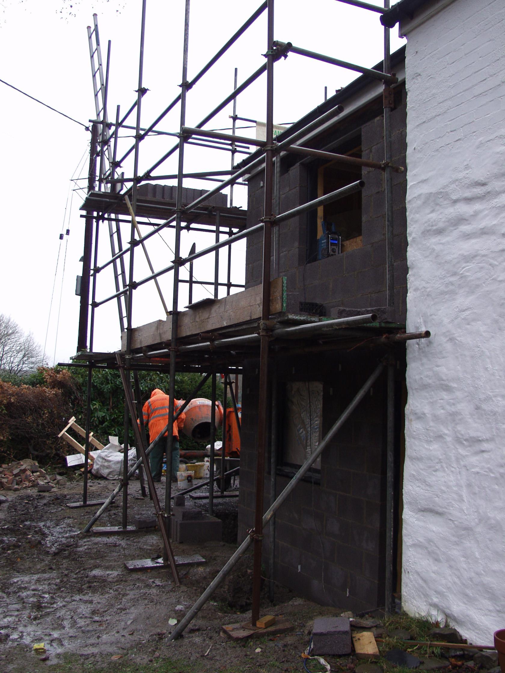

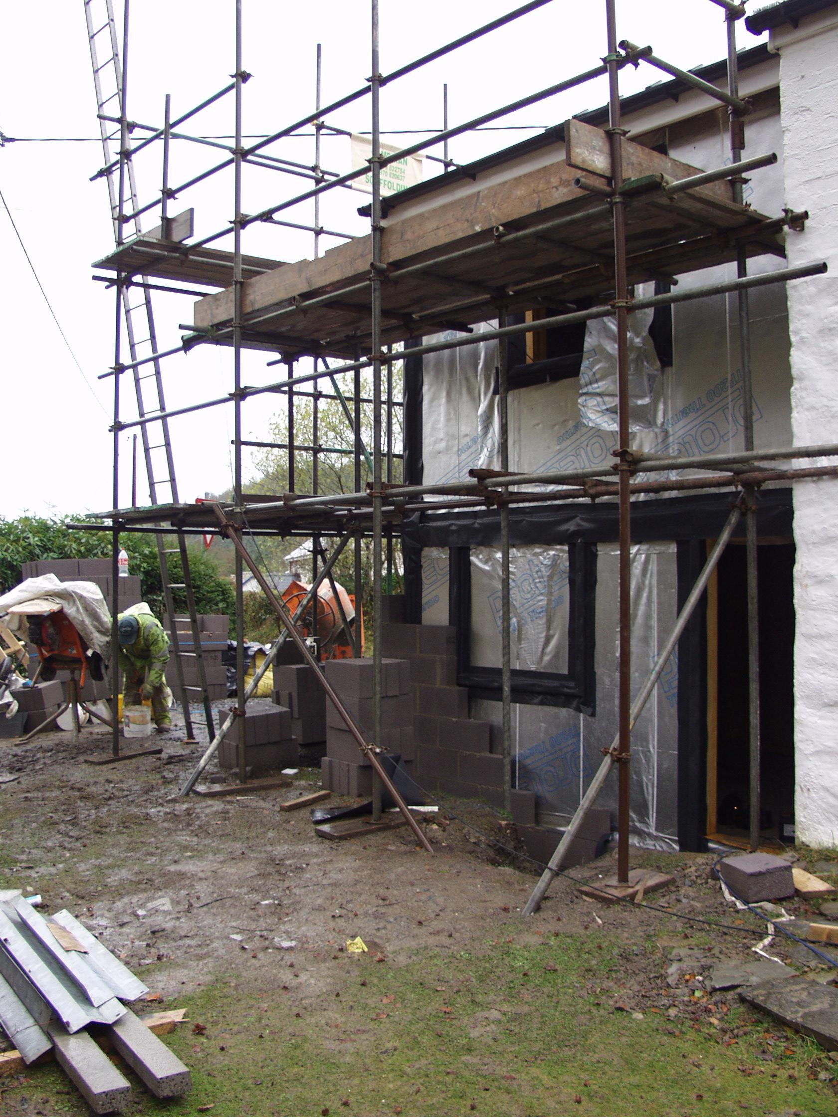

zoothorn Posted November 15, 2019 Author Posted November 15, 2019 The lower window. You can see its made, plus, there's a corresponding dpc frame behind: now I just remember 1st a 3x2 tannalised frame attatched to the silver face of the inner course, where the dpc 'frame' is: the 3x2 placement was determined by (& therefore now I know why the opening is this wide) the vertical studs behind/ in the room/ of the inner course T Frame. If I could take more pics I would- my slr cam now tho is effectively broken, & I do not do phone camera things. So I can only describe.

zoothorn Posted November 15, 2019 Author Posted November 15, 2019 (edited) 1 hour ago, PeterW said: Don’t change the window - you don’t need to as you’re creating problems you don’t need Ask the builder where the insulation is - he’s the only one who knows, so if he can’t tell you then no-one can. Both problems answered. I've already changed the window/ told builder. Its WAY too big Peter the glass would be 950mm wide. The whole design's meant to blend in with the old orig house: this has two small downstairs windows next to it: so Ive decided 920mm gap (meaning 620mm glass). I'm not asking where the insulation is. I know where it is, its in Jewsons shed. Its not put in yet. It was only given the green light 24hrs ago by the BCO @ 50mm. What I'm asking is about my itemised list for 'groundwork'. Specifically, I'm asking about the "100mm concrete base": if its a typical modern groundwork & you can see as much by the list I've given, then you would know what this "100mm concrete base" is likely to be. Any of you would. But I have no idea. Is it typically A) the floor above the insulation, or B) something below the insulation. What is typical to find in a modern build, A or B? Edited November 15, 2019 by zoothorn
