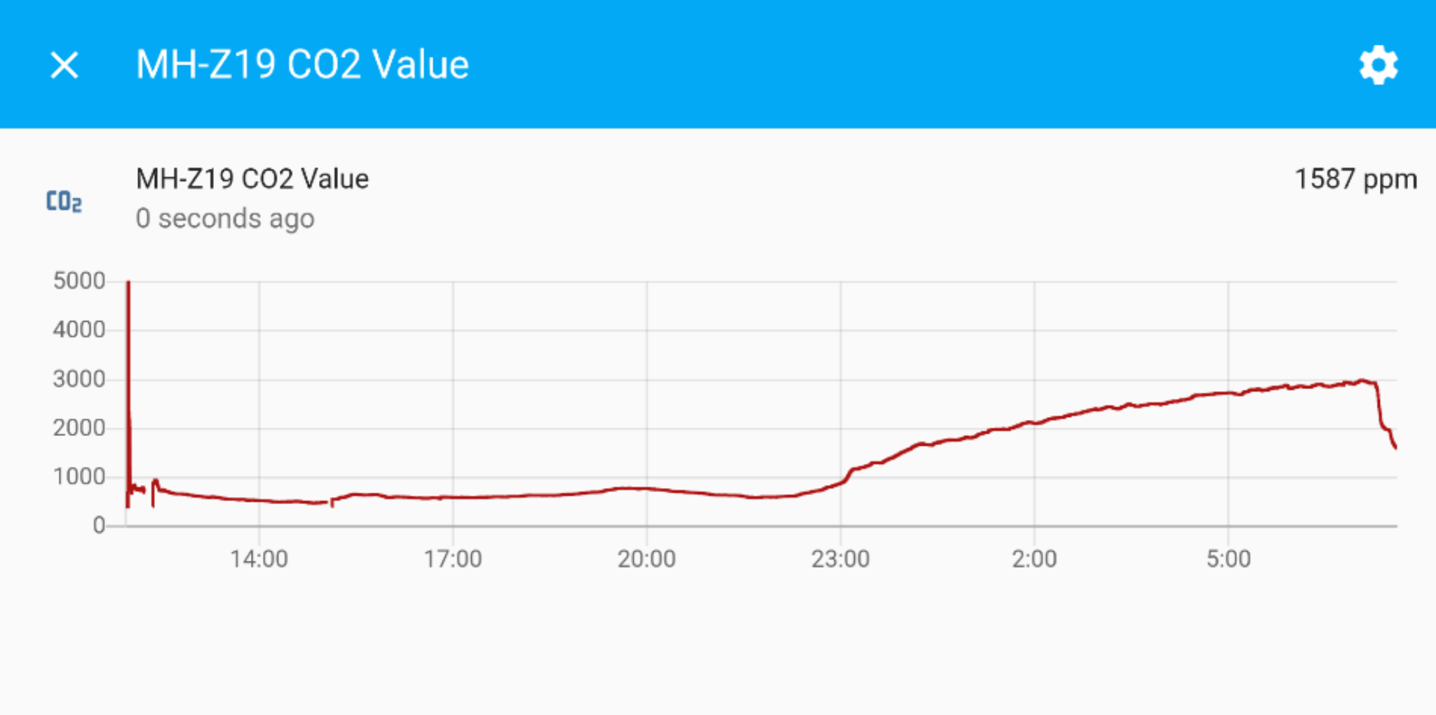

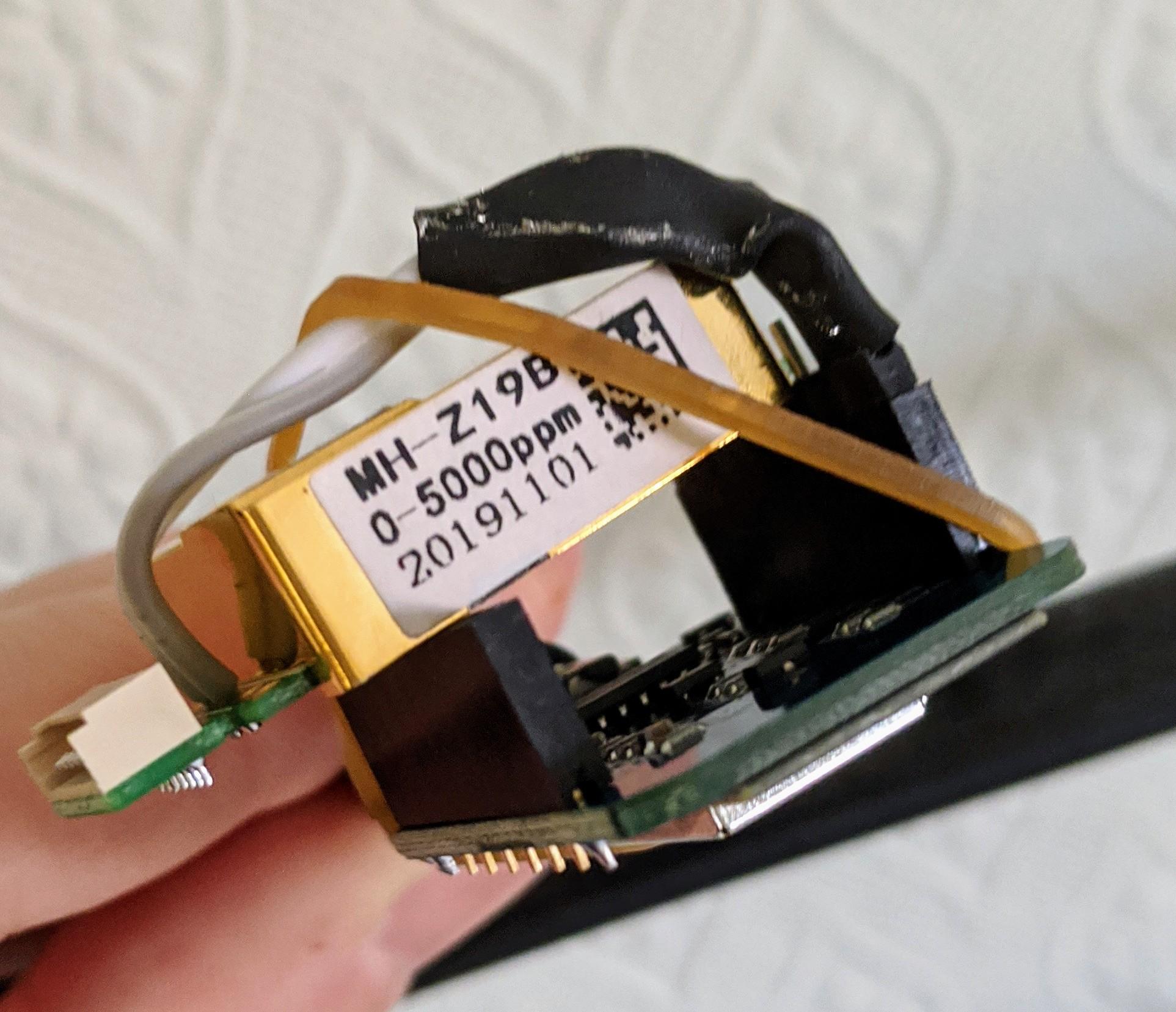

joth Posted February 3, 2020 Posted February 3, 2020 On 20/12/2019 at 10:15, joth said: Looks like the MH-Z19 is popular with Home Assistant users. £20 from amazon or half that from AliExpress https://www.open-homeautomation.com/2016/08/24/monitor-co2-levels-in-your-house/ https://esphome.io/components/sensor/mhz19.html Well that turned out to be a fun Sunday project. I hooked the MH-Z19 up to an ESP2866 (D1 mini) just about within my soldering ability, flashed ESPHome which has a bundled driver for this sensor and the readings appeared in Home Assistant first time. £20 not including the machine that's running HA. As an aside, I did a clean install of home assistant too, using the Hassio docker distribution this time, and goodness it's come along a long way even since May when it looks like I last tried it.

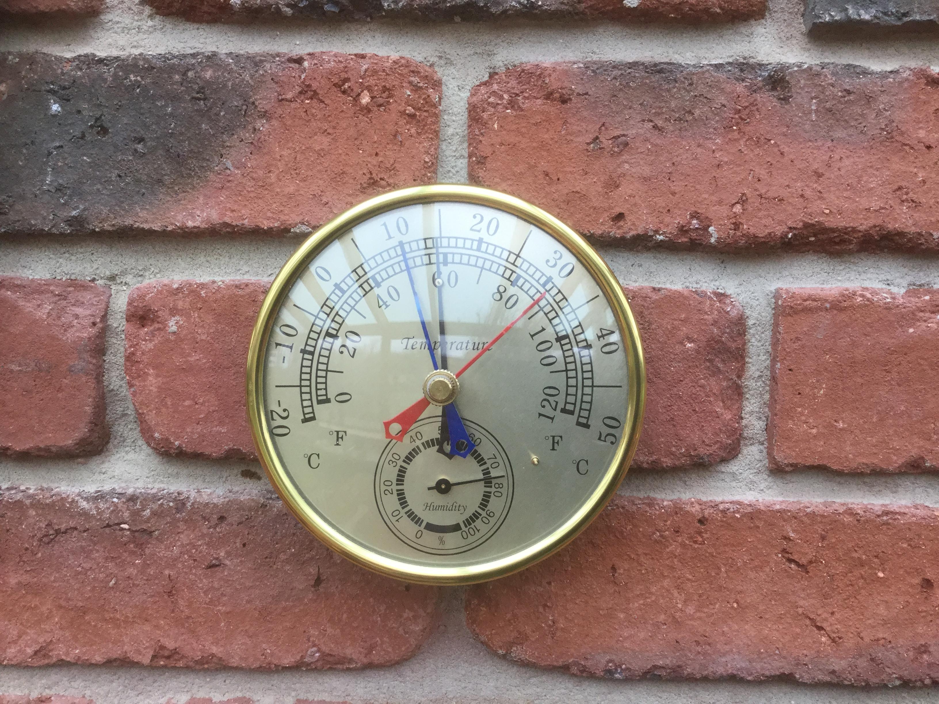

joe90 Posted February 3, 2020 Posted February 3, 2020 (edited) Well I am a Luddite so fir my conservatory I bought this on Ebay for a few quid ( a damp soggy feb day in Devon hence the high humidity). I was wanting a Co2 monitor to see how effective the MVHR was but convinced by others that RH was a good indicator of Co2. I have always thought that running the MVHR 24/7 was not needed (especially in summer when doors and windows are open). I have a humidity stat that I have yet to connect to the MVHR to kick the unit to boost after baths/shower/cooking, I am now thinking of installing a second one to switch the MVHR on when the RH and associated Co2 level get above a threshold that requires the house to be ventilated. Edited February 3, 2020 by joe90 1

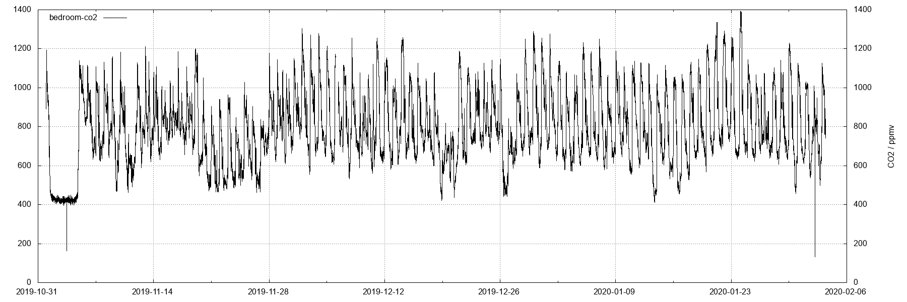

Ed Davies Posted February 3, 2020 Posted February 3, 2020 3000 ppmv, ouch! I've said it before on here but I'm a bit sceptical about those MH-Z19s as they calibrate by assuming that the CO₂ will go down to 400 ppmv at regular intervals. I'm not sure that assumption is sound. Here's the CO₂ level in my bedroom since the beginning of November. I was away for a long weekend at the beginning of that month and the CO₂ did get down to about 410 ppmv then but hasn't really done so very often or for long since. You can turn off that calibration (the HA software referenced above does that) but then you need to take it outside once in a while to calibrate it. I'm not sure how long a while is OK and what effect temperature has on that. Assuming 400 ppmv as the baseline is not something which is likely to be valid long term, either. My data was measured with a vAir monitor containing a CDM7160 sensor which, AIUI, is similar in principle to the MH-Z19 but has a separate internal path through a calibration chamber to compare against.

joth Posted February 3, 2020 Posted February 3, 2020 6 hours ago, Ed Davies said: 3000 ppmv, ouch! I've said it before on here but I'm a bit sceptical about those MH-Z19s as they calibrate by assuming that the CO₂ will go down to 400 ppmv at regular intervals. I'm not sure that assumption is sound. Here's the CO₂ level in my bedroom since the beginning of November. I was away for a long weekend at the beginning of that month and the CO₂ did get down to about 410 ppmv then but hasn't really done so very often or for long since. You can turn off that calibration (the HA software referenced above does that) but then you need to take it outside once in a while to calibrate it. I'm not sure how long a while is OK and what effect temperature has on that. Assuming 400 ppmv as the baseline is not something which is likely to be valid long term, either. Quite. I do indeed have that auto-calibration disabled and so also pretty skeptical about the absolute figures on it. I'll try leaving it for a few days and see. https://www.circuits.dk/testing-mh-z19-ndir-co2-sensor-module/ suggests it does include a reference gas chamber (nitrogen) but knowing quality control on these things it could be quite hit and miss anyway. For data logging it's still useful to see variation through the day and from one day to the next even if the absolute numbers aren't correct, and certainly could be enough for triggering an MVHR boost.
