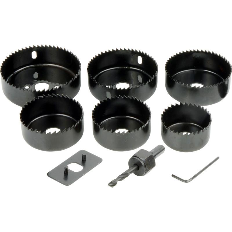

Barney12 Posted November 2, 2019 Share Posted November 2, 2019 1 hour ago, JSHarris said: The first one I tried chipped the plaster a bit. I switched to one with very much less set in the teeth and that was a great deal better. That is a good point. Whatever you do don’t use one of those adjustable hole cutters, it will end in tears. I swear by the Bosch Progressor hole saws. Nice clean cut every time. Link to comment Share on other sites More sharing options...

Jeremy Harris Posted November 2, 2019 Share Posted November 2, 2019 On the subject of hole saws, albeit smaller ones, I recently bought a cheapo set from China, that seemed as if they might have carbide teeth. As the set of 12 cost less than £13 delivered (from a UK warehouse) I took a punt. I'm simply amazed at how good they are. They seem to cut very cleanly, even when used on stainless. They do seem to all have brazed on carbide teeth. Goodness only knows how they can be manufactured, shipped and sold for this price. Only go up to 50mm though, so not much use for downlights. Link to comment Share on other sites More sharing options...
Onoff Posted November 2, 2019 Share Posted November 2, 2019 39 minutes ago, Barney12 said: That is a good point. Whatever you do don’t use one of those adjustable hole cutters, it will end in tears. I swear by the Bosch Progressor hole saws. Nice clean cut every time. I switch between proper "Starretts" and the cheapo generic type like this: For bfo holes I had success with one of these AS LONG as you screw a bit of ply on first to stop the centre drill wandering: 1 Link to comment Share on other sites More sharing options...

Barney12 Posted November 2, 2019 Share Posted November 2, 2019 3 hours ago, Onoff said: For bfo holes I had success with one of these AS LONG as you screw a bit of ply on first to stop the centre drill wandering: don’t go near these if you’ve plastered though. They will chip the skim like crazy. Fine for bare board. Link to comment Share on other sites More sharing options...
