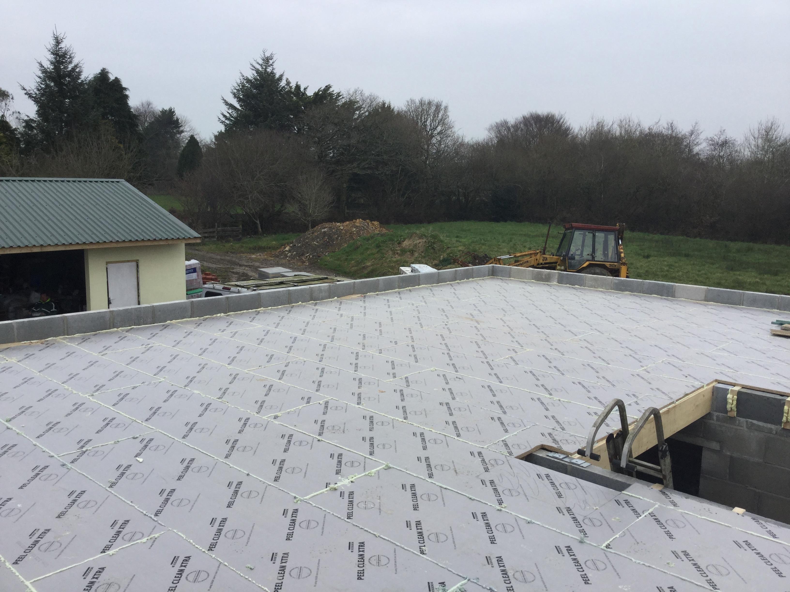

zoothorn Posted November 2, 2019 Author Share Posted November 2, 2019 Also I'm concerned about the weather: the dividing floor is chipboard with grey hard surface on the sections. These I noticed were carefully wrapped up against rain in the pile last few days. Now in, & rain is pooling on them (joined by some german adhesive stuff between) the water is pouring down thru gaps into lower room, & pooling on the floor. It'll be tuesday until roof trusses on. I'm concerned the floor will be ruined. If it is.. its either a wibbly floor.. or a screed ontop to level it (I can't.. no room H top play with even 1cm), or its not stucturally ok if chipboard's compromised. Link to comment Share on other sites More sharing options...

PeterW Posted November 2, 2019 Share Posted November 2, 2019 1 hour ago, zoothorn said: Also I'm concerned about the weather: the dividing floor is chipboard with grey hard surface on the sections. These I noticed were carefully wrapped up against rain in the pile last few days. Now in, & rain is pooling on them (joined by some german adhesive stuff between) the water is pouring down thru gaps into lower room, & pooling on the floor. It'll be tuesday until roof trusses on. I'm concerned the floor will be ruined. If it is.. its either a wibbly floor.. or a screed ontop to level it (I can't.. no room H top play with even 1cm), or its not stucturally ok if chipboard's compromised. its called Egger Protect board and it is waterproof for 60 days - the foaming glue joining the boards will make it like a pond ..!! I’ve had a floor exposed for 3 months with no issues. Link to comment Share on other sites More sharing options...
joe90 Posted November 2, 2019 Share Posted November 2, 2019 1 hour ago, PeterW said: its called Egger Protect board and it is waterproof for 60 days - the foaming glue joining the boards will make it like a pond ..!! I’ve had a floor exposed for 3 months with no issues. Yup, mine was out in very wet weather fir months and did not suffer at all. The grey surface is great as any plaster spilt on it comes up and leaves a very clean floor, don’t take it up till after decorating etc. Link to comment Share on other sites More sharing options...
zoothorn Posted November 2, 2019 Author Share Posted November 2, 2019 3 hours ago, PeterW said: its called Egger Protect board and it is waterproof for 60 days - the foaming glue joining the boards will make it like a pond ..!! I’ve had a floor exposed for 3 months with no issues. Hi Peter- ok thanks but I bet yours didn't have gaps between with water getting down/ a helluva lot is pouring into the btm room.. no prob on floor below.. but surely the edges are fallible if gaps? Link to comment Share on other sites More sharing options...
zoothorn Posted November 2, 2019 Author Share Posted November 2, 2019 2 hours ago, joe90 said: Yup, mine was out in very wet weather fir months and did not suffer at all. The grey surface is great as any plaster spilt on it comes up and leaves a very clean floor, don’t take it up till after decorating etc. Hi Joe- ok I'm reassured about the surface.. but the glue had only 2 hrs before the rain came in 4pm y'day, & its been pretty heavy since. Ive got the whole upstairs exposed. I just bought huge FO tarp & I'll mop up what collecting on the surface.. its just bad luck weatherwise, but the stress remains then until its weatherproofed. Link to comment Share on other sites More sharing options...

joe90 Posted November 2, 2019 Share Posted November 2, 2019 (edited) 5 minutes ago, zoothorn said: Hi Joe- ok I'm reassured about the surface.. but the glue had only 2 hrs before the rain came in 4pm y'day, & its been pretty heavy since. Ive got the whole upstairs exposed. I just bought huge FO tarp & I'll mop up what collecting on the surface.. its just bad luck weatherwise, but the stress remains then until its weatherproofed. Zoot, don’t waste your time, the glue will go off underwater, mine sat like a big puddle fir months (I was not convinced at the time) but my builder was right, it suffered not a jot. Edited November 2, 2019 by joe90 Link to comment Share on other sites More sharing options...

PeterW Posted November 2, 2019 Share Posted November 2, 2019 1 hour ago, zoothorn said: Hi Peter- ok thanks but I bet yours didn't have gaps between with water getting down/ a helluva lot is pouring into the btm room.. no prob on floor below.. but surely the edges are fallible if gaps? yes in some places and it will be fine. It’s designed to be left in all weathers for up to 65 days ... Link to comment Share on other sites More sharing options...
jamieled Posted November 2, 2019 Share Posted November 2, 2019 @zoothorn due to my cockup I ended up with a load of non-waterproof chipboard exposed for weeks this summer. Water was pissing through the gaps, but it all dried up fine. You'll be fine for a few days for sure. Link to comment Share on other sites More sharing options...
