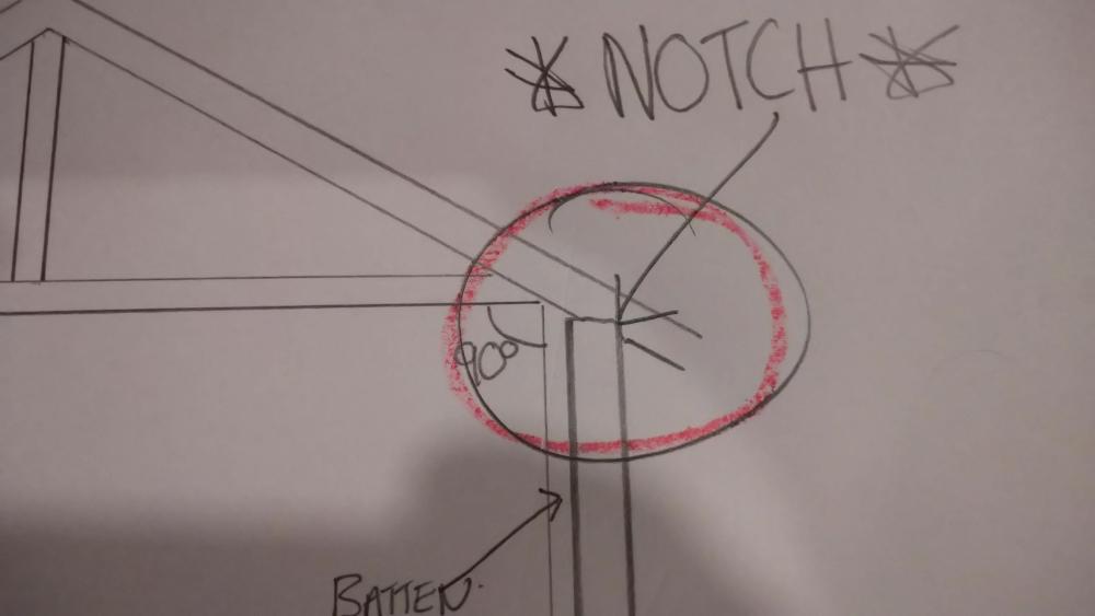

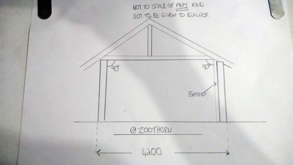

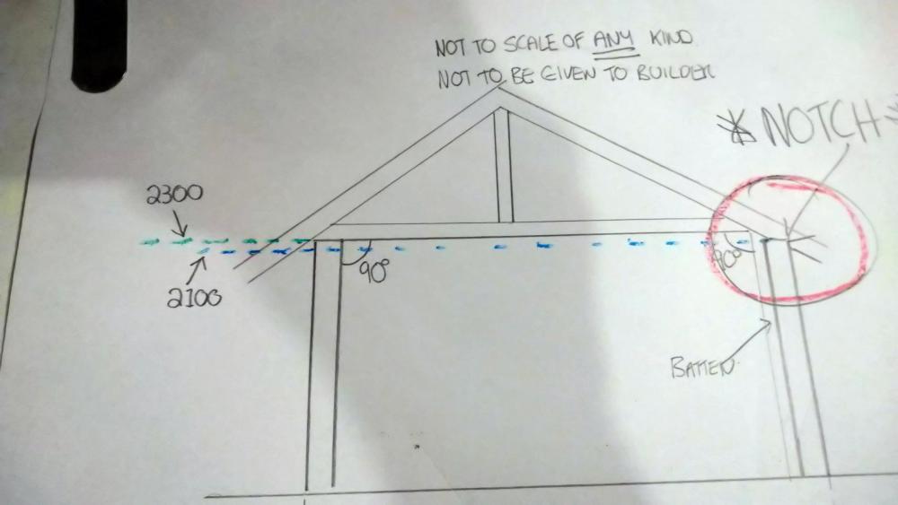

zoothorn Posted October 31, 2019 Posted October 31, 2019 Hi chaps, groundwork having been done (+350mm too deep, & my concerns remedied by this extra being "put onto the lower room H" via a call I made- ok fine/ tho why this mistake still unknown). Today 1st day of Timber Frame build: chaps suddenly appear 12.30pm. I was told monday/ tuesday only yesterday by my builder.. so why they (4) all suddenly turn up 12.30.. I'm querying. And problems are continuing. The lower room was done in 3rs, roof trusses on. 1st I asked my builder re. what H are we aiming for the lower room? (altho already established on the call ^ at 2350mm: the mystery extra 350mm added on to plan's 2m). I repeatedly asked about the room H today.. "2.2m" (so 2350mm now n/a). I was shown 8x2 canadians "so we can make up/ shims". Aha ok. 2.2m I thought.. right I can just about accept.. but TOTAL MIN as now its very concerning as to the upper room's H increacing > balcony lowering > the step-into this room increacing.. & the roof lowering??? Once they'd gone I measure: 2.2m it is to trusses.. but without floor insulation & scree or ceiling pB. Now I feel like I'm being played like a fool, &/ or outright lied to. So 100mm insulation +40mm scree(?) +10pB = 2050mm. Its extremely low in here. I was told & I was insistant etc this would be so.. this room H would be 2350mm. All total bllx to cover for innitial mistake. The trouble is now my trust is shot. As to the build its way off my plan, not rectified by adding the 350mm on my lower room H, & most of all (as I assume will happen) IF the upper room's just made to the orig plan (regardless of the extra 'mystery' 350mm I was told "all fine" only as to a reason why it occured).. ie 2300mm.. the whole roof will be 350mm short, so A) the step into it is now @ 450mm (my plan: 1 step) & the most concerning thing, B) the door into it will be ~& I can only approximate here~ 1650mm max.. which will not pass BRegs, & be awful to have to duck to use anyway even if were to be done. All depends on the top room H. Discounting what answer I'd get now, I have to find out how the remaining sections might go (orientation).. basically try & find out what this figure is to be.. before they start.. & stop them if neccessary continuing.. or I'll be left totally fkd at the end. So yet another night without sleep. I cannot tell you how many times I ve discussed the critical nature of simply the two rooms' heights with my builder. 2 years of planning, design, chats with him, all down the toilet.
Big Jimbo Posted October 31, 2019 Posted October 31, 2019 So, and correct me if i'm wrong, the finish floor level of the extension is lower than your existing house finish floor level ? By how much ? What is the ceiling height from the floor of your existing house ? What is the ceiling height anticipated by you in the new extension ? How are you going to access the new extension from your existing house ? A door with steps down ? Do you have enough height for a full height door ? To get from your existing house into the extention Answer the above, and i will see if i can help further.
zoothorn Posted October 31, 2019 Author Posted October 31, 2019 Hi BigJ- FFL of extention on the plan is 1 step, below existing FFL. What's been done, is 350mm extra -ontop- of this. Why? a mistake, clearly so. I anticipated 2m H, this is on my plan. I was told tho, once I asked why the +350mm? "oh all fine/ it'll be added to the lower room H". Altho not what I specified, if I were to gain 350mm.. then I could make this addition 'useful' (tho a pain & expense to refashion ground around it). But what's been built is 2.05m. This 'extra' hasn't happened. The extention is simply 2 storys, access -only- via a knock-thru from master bedroom, into top room. This on plan is a small step, now its grown to 450mm. Btm room door to outside only. I do not know- & this is my current HUGE concern- if I have enough room for a full H door between now. Because the position of the lower room ceiling/ dividing floor/ & critically the floor level ontop has all shifted down 350mm.. I cannot establish what my top room H will be. I'm outside panicking trying to measure xyz in the dark: I'm panicking I'll not have enough ceiling height in new room to connect between via a normal H door.

Onoff Posted October 31, 2019 Posted October 31, 2019 (edited) 8 minutes ago, zoothorn said: The thing is Ive got the dpm layer (black thick stuff) 11cm above the surface. Ive got 2.2m between this & the goddam ceiling truss things (which have to be pB onto). Im so sick of this H issue!! promised 2.35m, then told 2.2 today, then in acutality its maybe 1.95m!! I can understand your frustrations but it's a bit tricky sometimes to understand without photos. Most of us would be holding tapes up etc and snapping away. For instance when talking about how my two gate posts were at different heights a couple of pics conveyed the issue to anyone looking: Edited October 31, 2019 by Onoff
