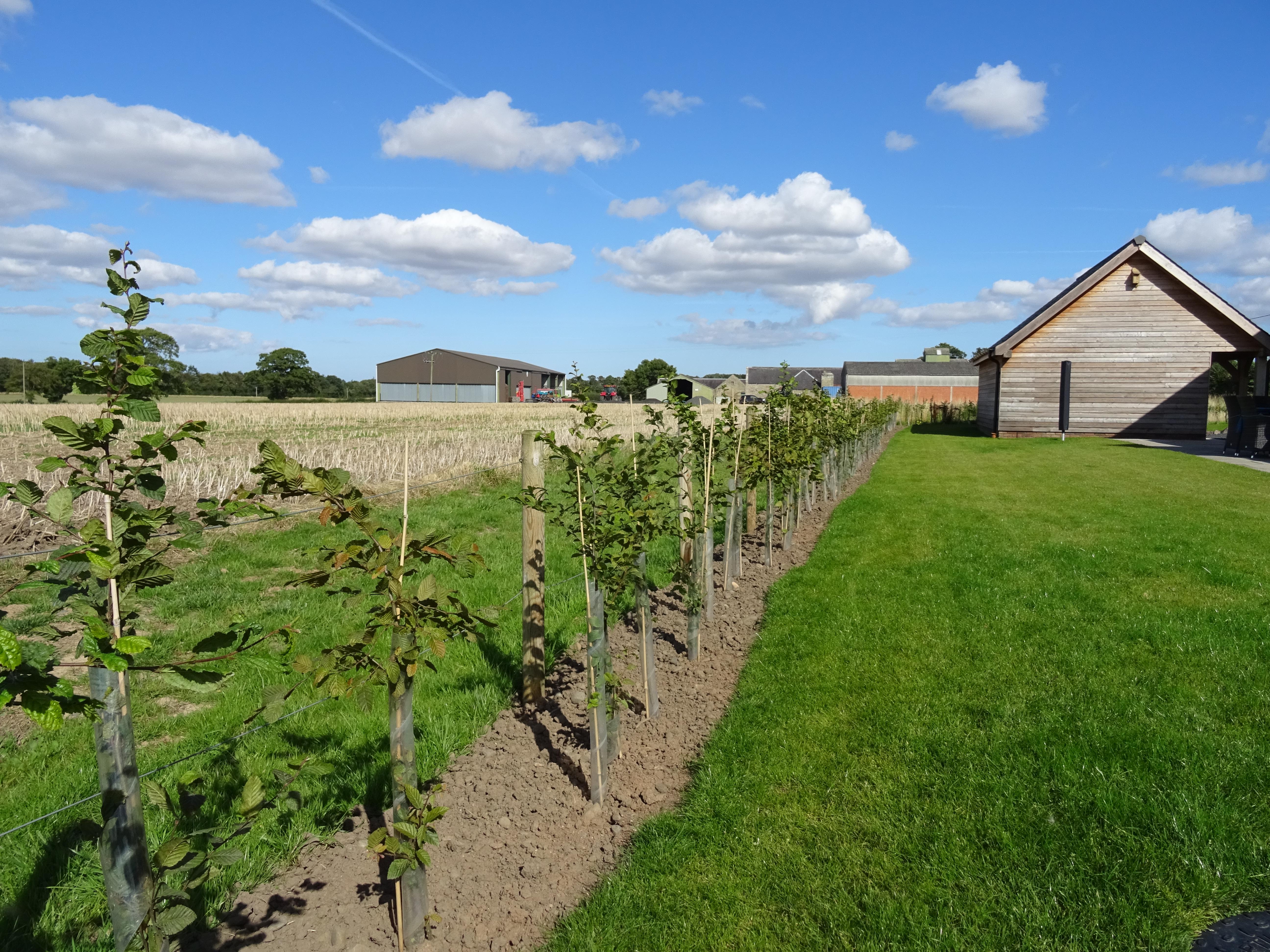

epsilonGreedy Posted November 1, 2019 Author Posted November 1, 2019 On 29/10/2019 at 19:44, PeterW said: how long is the bund you need to cover ..? 5-7 plants per metre is a good estimate - we use this company for most of ours. https://www.hedgesdirect.co.uk/acatalog/Blackthorn-based-40-60-cm-bare-rootsx100.html#SID=330 Enough in that pack for 15-20m. If you need tree guards I’ve got about 3,000 spare somewhere ... someone didn’t read that there were 10 spirals of 10 per pack....... not 10 per pack ... I will need to plant 45 meters of hedge eventually though I have to leave a 5 meter access gap until the build is finished to allow mid size plant access to all sides of the house. A local in the village is happy to turn up for £35 per hour with his telehandler which is money well spent I hope when moving packs or bricks and blocks to ideal positions as the build progresses. Then there is still the possibility of needing to dig a hole for the LPG tank if I don't go 100% electric. Thanks for the offer of tree guards, apparently Muntjac dear are the main problem here.
Jeremy Harris Posted November 1, 2019 Posted November 1, 2019 Our experience of planting a few hundred 600mm bare root mixed native species hedging was that they didn't do much the first year, but took off after that, although we did have a few losses. Cheap as chips, though, and very well worth getting in now, if you can. I think part of our minor problem was putting them in a bit late (late January) when I think that, ideally, they should have gone in by the end of November.
epsilonGreedy Posted November 1, 2019 Author Posted November 1, 2019 3 minutes ago, JSHarris said: Our experience of planting a few hundred 600mm bare root mixed native species hedging was that they didn't do much the first year, but took off after that, although we did have a few losses. Cheap as chips, though, and very well worth getting in now, if you can. I think part of our minor problem was putting them in a bit late (late January) when I think that, ideally, they should have gone in by the end of November. The first completed property at my 3 plot self build location has shown similar slow 1st year growth with their hedge. I think the raised bunds required in the planning approval are prone to lack of water in the summer hence the saplings will struggle for a few years, I am not expecting anything like @Redoctober's surge of first year growth. I get the impression that bare root hedging will only be supplied when the nurseries are sure the plants are dormant. I was told that even if I placed an order in September they would only ship in November or December.
Cpd Posted November 1, 2019 Posted November 1, 2019 I have put in a few thousand bare root plants and they are always slow to get going, this year I have put in 600 cell grown trees so will see if they respond quicker. This year I planted 300eucalyptus (x3 varieties ) 100 lodgepole 100 Italian alder 100 snowy mespilus
Jeremy Harris Posted November 1, 2019 Posted November 1, 2019 9 minutes ago, Cpd said: I have put in a few thousand bare root plants and they are always slow to get going, this year I have put in 600 cell grown trees so will see if they respond quicker. This year I planted 300eucalyptus (x3 varieties ) 100 lodgepole 100 Italian alder 100 snowy mespilus Be interesting to see if there is a difference. We were given some unwanted seedlings, a bit smaller than the bare roots we had delivered, and they did a great deal better. Might have something to do with them being local, perhaps, so already adapted to our soil.
PeterW Posted November 1, 2019 Posted November 1, 2019 When doing bare root we tend to have 15/20 spares and they go into a corner to grow on. If there is a gap in the hedge a year later, one or two of these get transplanted into the gap - same batch so they tend to look and be the same size as the rest 3
Redoctober Posted November 1, 2019 Posted November 1, 2019 11 minutes ago, PeterW said: When doing bare root we tend to have 15/20 spares and they go into a corner to grow on. If there is a gap in the hedge a year later, one or two of these get transplanted into the gap - same batch so they tend to look and be the same size as the rest This is exactly what happened with our first order - there were a good 50 or so spare so they were planted in the neighbouring field collectively like a bushel. This acted like a nursery and come the spring, we replanted them in place of the ones that had been eaten by the Hares! @epsilonGreedy the hedging is a mixture of what they call native hedging - Hawthorn, Horn beam, field maple and blackthorn. Although across the back for continuity we have gone for Hornbeam - very similar to Beech.
Jeremy Harris Posted November 2, 2019 Posted November 2, 2019 I wish I'd thought to do the same, and heel in a few dozen spares. Where I've filled in some gaps the hedge is now a bit uneven. I also found that with the mixed native species hedging, some grow a lot faster than others. In our case it's the field maples and wild cherries that have established a lot faster than the hazel, hawthorn, wild rose and blackthorn. The wild cherries, in particular, see to grow at a prodigious rate when established, and need far more pruning than the others. I'd be tempted to leave them out of the mix if ever planting a similar hedge in future.
Gone West Posted November 2, 2019 Posted November 2, 2019 2 hours ago, JSHarris said: I wish I'd thought to do the same, and heel in a few dozen spares. Where I've filled in some gaps the hedge is now a bit uneven. I also found that with the mixed native species hedging, some grow a lot faster than others. In our case it's the field maples and wild cherries that have established a lot faster than the hazel, hawthorn, wild rose and blackthorn. The wild cherries, in particular, see to grow at a prodigious rate when established, and need far more pruning than the others. I'd be tempted to leave them out of the mix if ever planting a similar hedge in future. We only used hawthorn and blackthorn so it would be easy to keep them in check. We were lucky and nearly all of our bare rooted whips took well and we only needed to replace two from our heeled in replacement stock. It's amazing how quickly the heeled in spares rooted. It took a lot of digging to remove them after a year.
