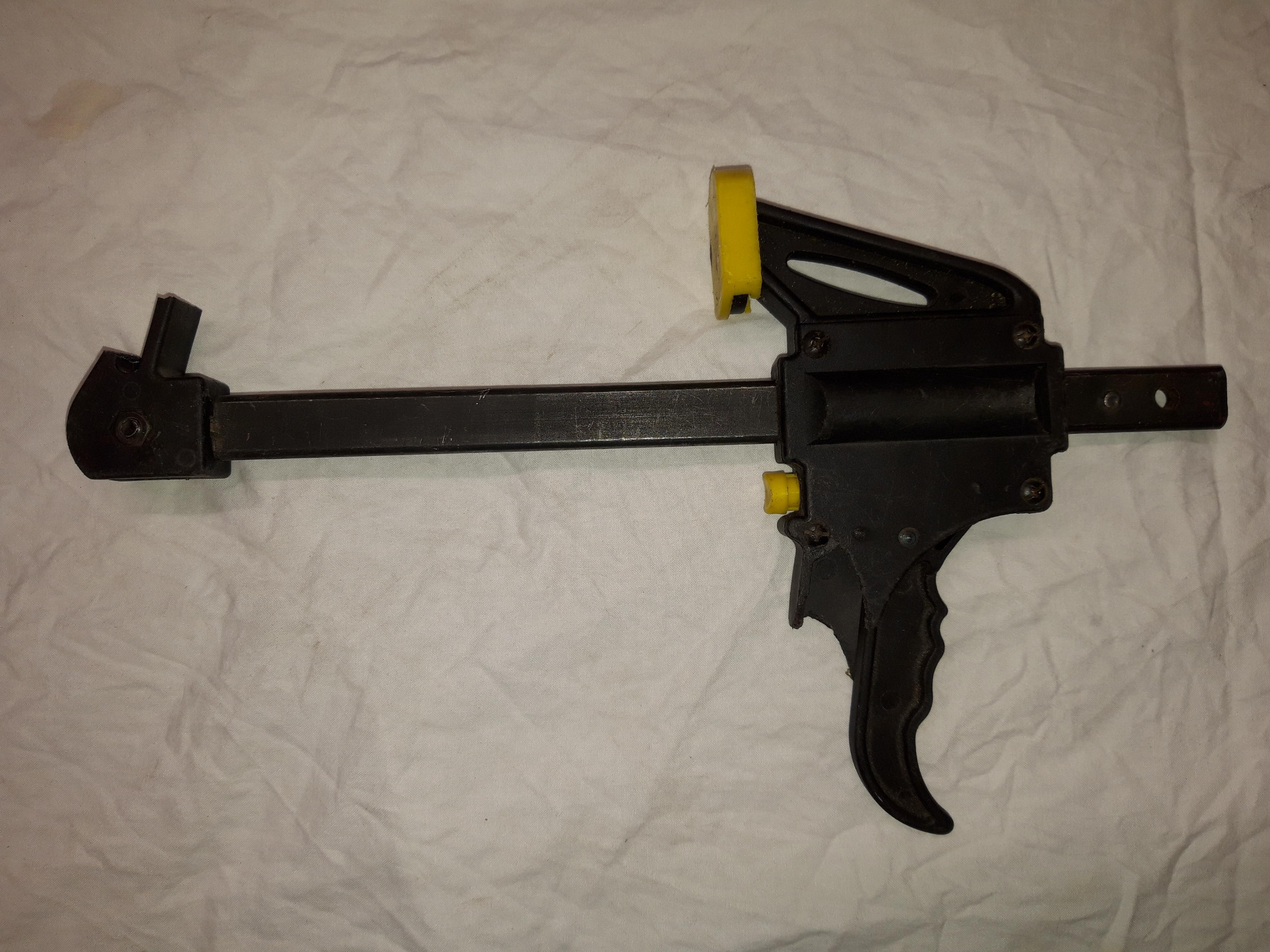

Onoff Posted October 17, 2019 Posted October 17, 2019 My original type. All metal & still using them. Have like a silicone gun construction: Lidls often have these in, cheap and sometimes quite long lengths. I've half a dozen for multiple clamp jobs: Avoid this type, they just break. Squeeze too hard and the mechanism goes "bang":
PeterW Posted October 17, 2019 Posted October 17, 2019 24 minutes ago, Onoff said: Avoid this type, they just break. Squeeze too hard and the mechanism goes "bang": don’t agree, sorry !! My Irwin ones are 15 plus years old and still going.
Onoff Posted October 17, 2019 Posted October 17, 2019 11 minutes ago, PeterW said: don’t agree, sorry !! My Irwin ones are 15 plus years old and still going. See my post above. Irwins are great, its the cheapo copies that go bang on me. The ones I pictured were Lidl Powerfix I'm sure. Same concept as the Irwins but I guess plastic insides. I'll dig the broken ones out and post a pic. 1

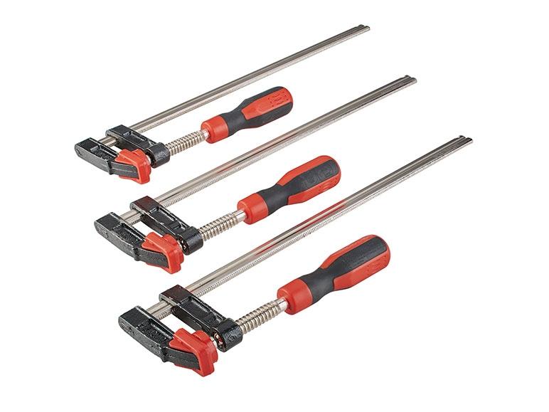

H F Posted October 17, 2019 Author Posted October 17, 2019 6 hours ago, joe90 said: If the workpiece is large enough to hold, simply hand held would be ok but if your not confident then any kind of clamp that secures the piece and stops it moving about will be suffice As my diy skills continue to improve, I would like to retain all my digits for a few more years to come, so clamping is a good option. looks like the Irwin you suggested is a winner - thank you. Also, what is the consensus in G clamps?

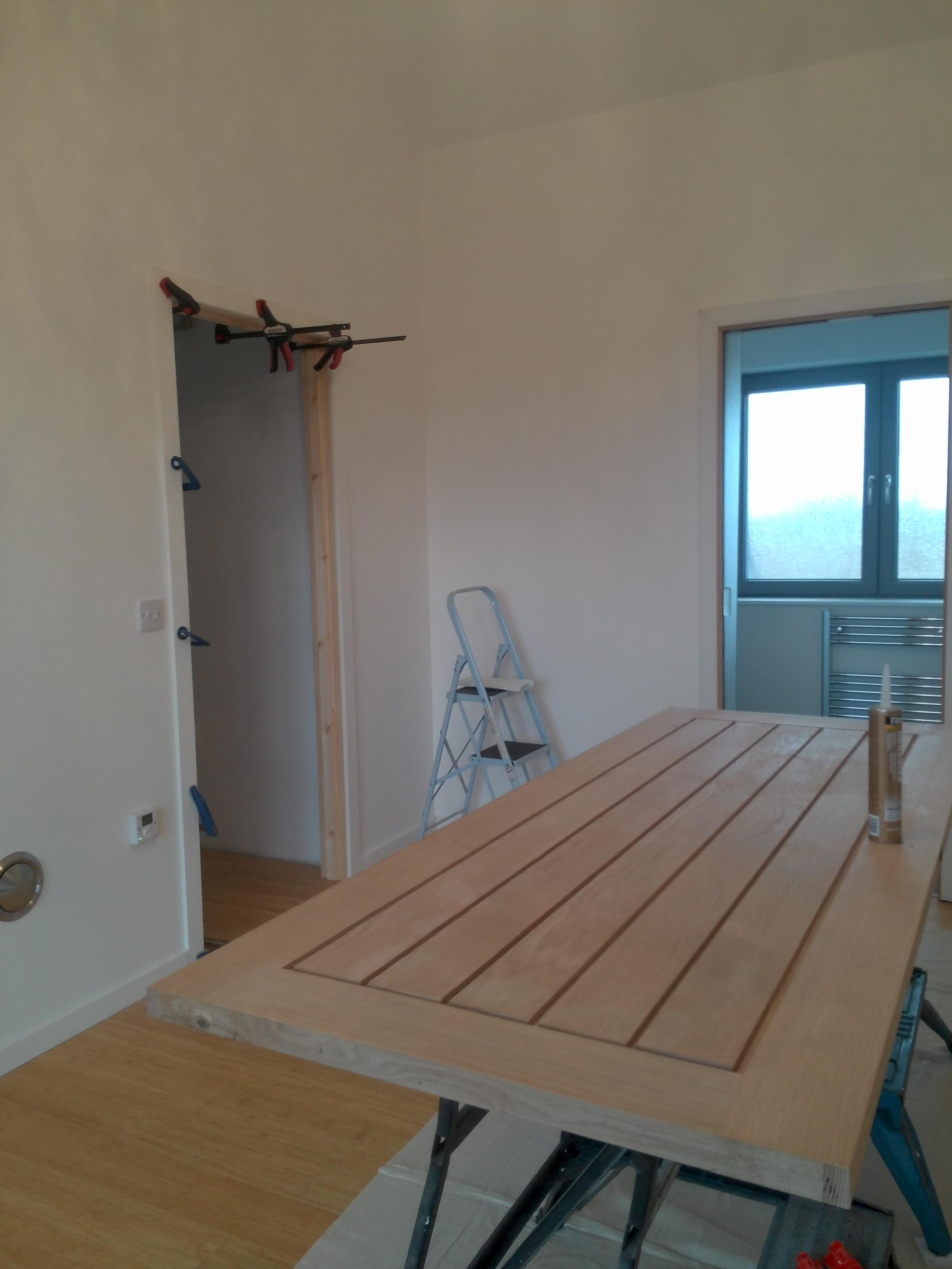

Onoff Posted October 17, 2019 Posted October 17, 2019 Just a few of mine put to good use when I foam filled a upvc cill. It prevented the cill distorting at all. I like the screw handle, G clamp type as you can set them to just lightly "touch" the sides of the pieces you're clamping without squeezing in any way but still preventing movement. The orange "silicone gun" type, along with the Irwin esque types I suspect apply a constant force until released.

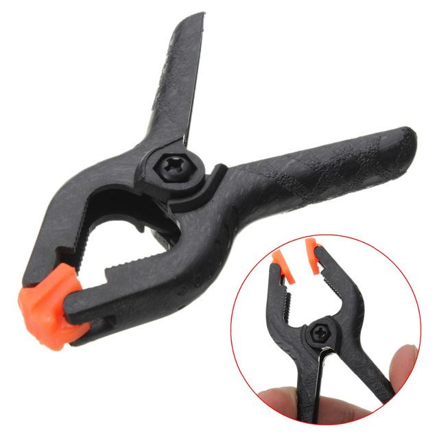

SteamyTea Posted October 17, 2019 Posted October 17, 2019 (edited) 1 hour ago, Onoff said: Avoid this type, they just break. Squeeze too hard and the mechanism goes "bang": I got sent 4 cheap ones when I bought 2 decent C-Clamps. I fond them useful to hold things lightly in place while I get the decent clamps, or cramps, on properly. Not a woodworking G-Clamp, but a metal working one, I like the Record ones. They seem indestructible, no matter how hard you screw them up. Not like my cheap wood working ones, some have twisted, and the swivel foot has fallen off. I use them to clamp my large ladder to the brackets I screwed onto my neighbour's fence posts. Makes a nice 'shelf' for the pot plants. Edited October 17, 2019 by SteamyTea
Gone West Posted October 18, 2019 Posted October 18, 2019 11 hours ago, Home Farm said: As my diy skills continue to improve, I would like to retain all my digits for a few more years to come, so clamping is a good option. looks like the Irwin you suggested is a winner - thank you. Also, what is the consensus in G clamps? I have a range of one handed clamps from 50mm up to 300mm which are very useful but I still use G clamps for some jobs.
joe90 Posted October 18, 2019 Posted October 18, 2019 @Home Farm g cramps (in my opinion) are more useful for metal work, down side is they can take ages to screw up whereas quick clamps are far quicker and one handed.

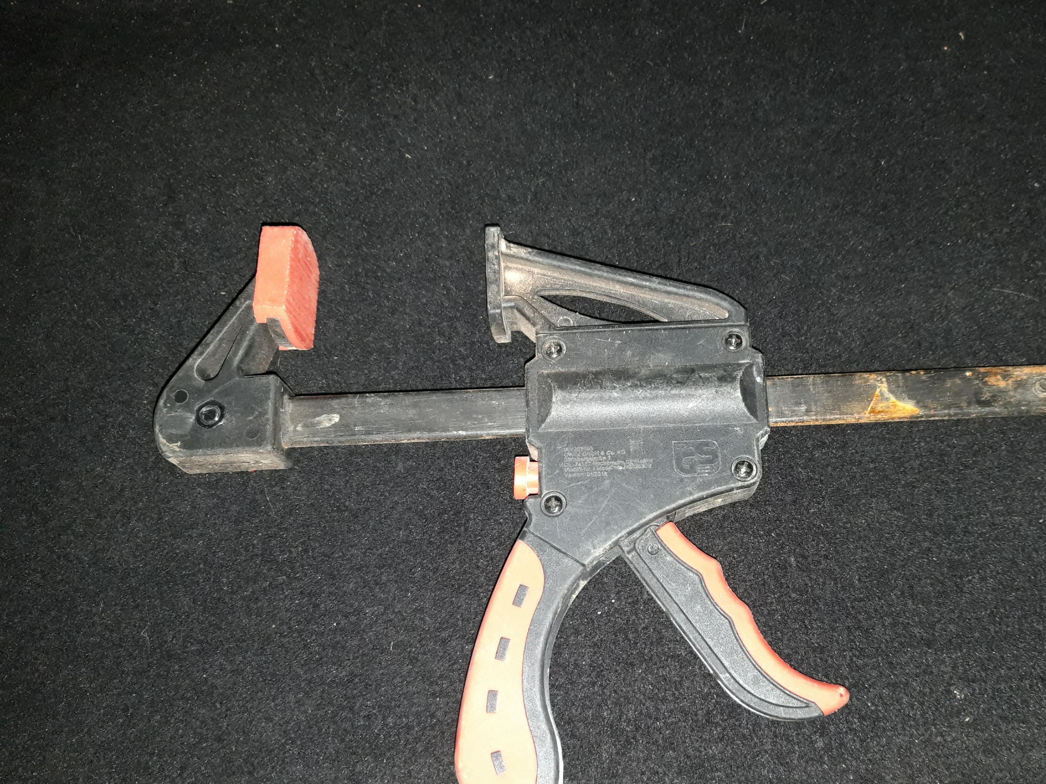

Onoff Posted October 18, 2019 Posted October 18, 2019 Of a pair of these, one went bang pretty soon after purchase. The other, seen here, continues to function: I've been using it to hold formwork together doing the brick pillars. I've kept the broken ones under the illusion (delusion?) I'll take them apart one day in case it's a simple fix! ? Tbf most have screws to disassemble rather than being riveted. This one, the front, then part of the handle/pistol grip broke off in use:
