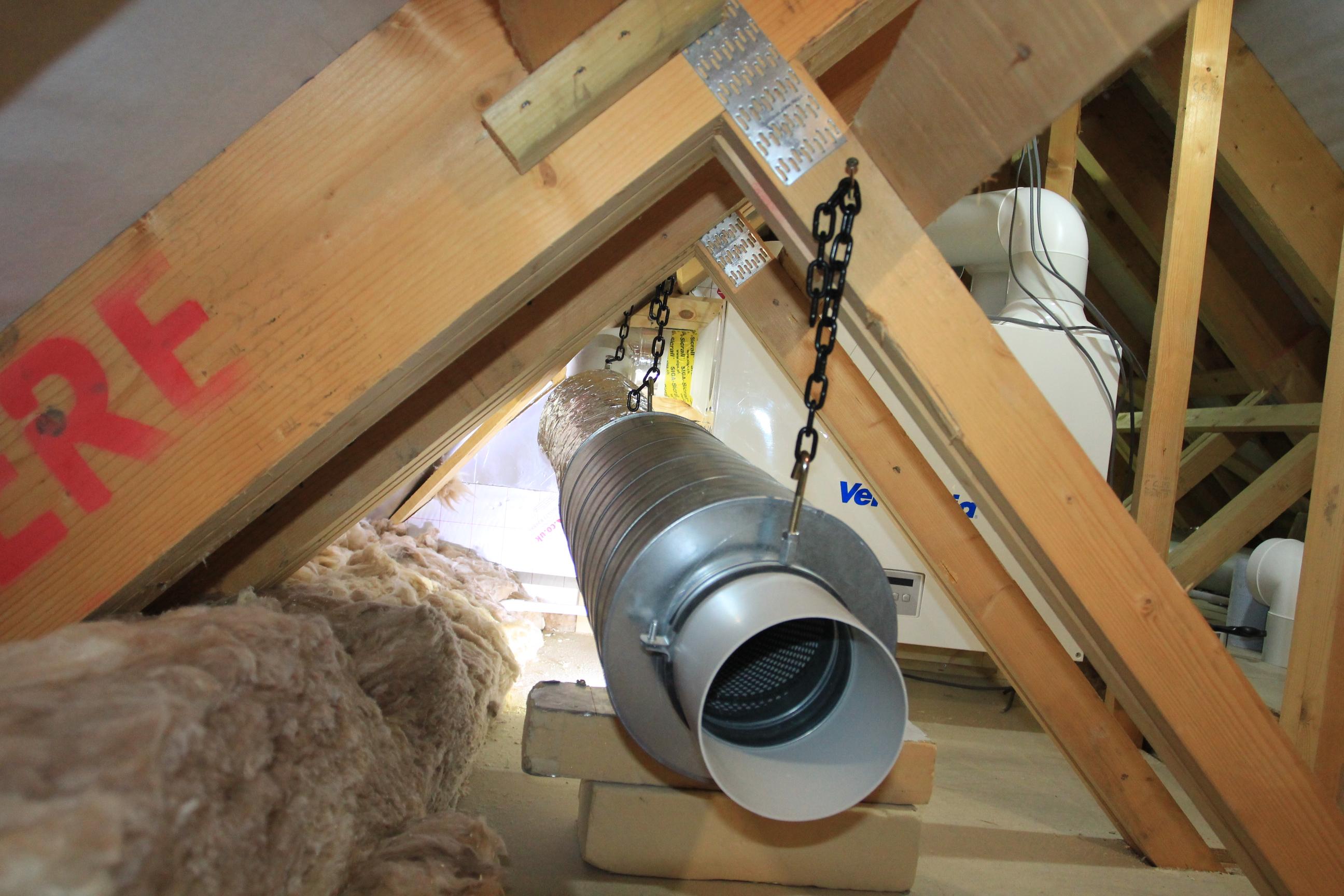

CC45 Posted November 25, 2019 Posted November 25, 2019 Well some progress. For those who wanted a picture of silencers... All suspended off chains but could easily be done with something more sound proof. The 150mm flexi pipe I've used to join the silencer to the MVHR is a pain to put on and its not overly robust. I've ordered some more connectors and I will put these into the ends of the pipes and then slide the flexi over that. All mounted in an unheated attic - it takes a lot of time to do all the insulation in amongst all that timber. Hope that's what some of you wanted to see. 1 2
phatboy Posted November 25, 2019 Posted November 25, 2019 1 minute ago, CC45 said: The 150mm flexi pipe I've used to join the silencer to the MVHR is a pain to put on and its not overly robust. I've ordered some more connectors and I will put these into the ends of the pipes and then slide the flexi over that. That's what I did on mine too... inserted a connector to the solid pipe and taped, then attached the flexi with a worm drive clip, then taped over that too. I used the fabric flexi's though, and there was no way at all they were going to go over the pipes any other way.
vivienz Posted November 26, 2019 Posted November 26, 2019 Looking at this photo, I can see why mine never got done as I can't see there being enough space to put this kind of arrangement into the loft. The pipework is very convoluted and takes up much of the space immediately around the unit so I don't think will be one for me. Thanks for the photos, though, very helpful for visualisation.

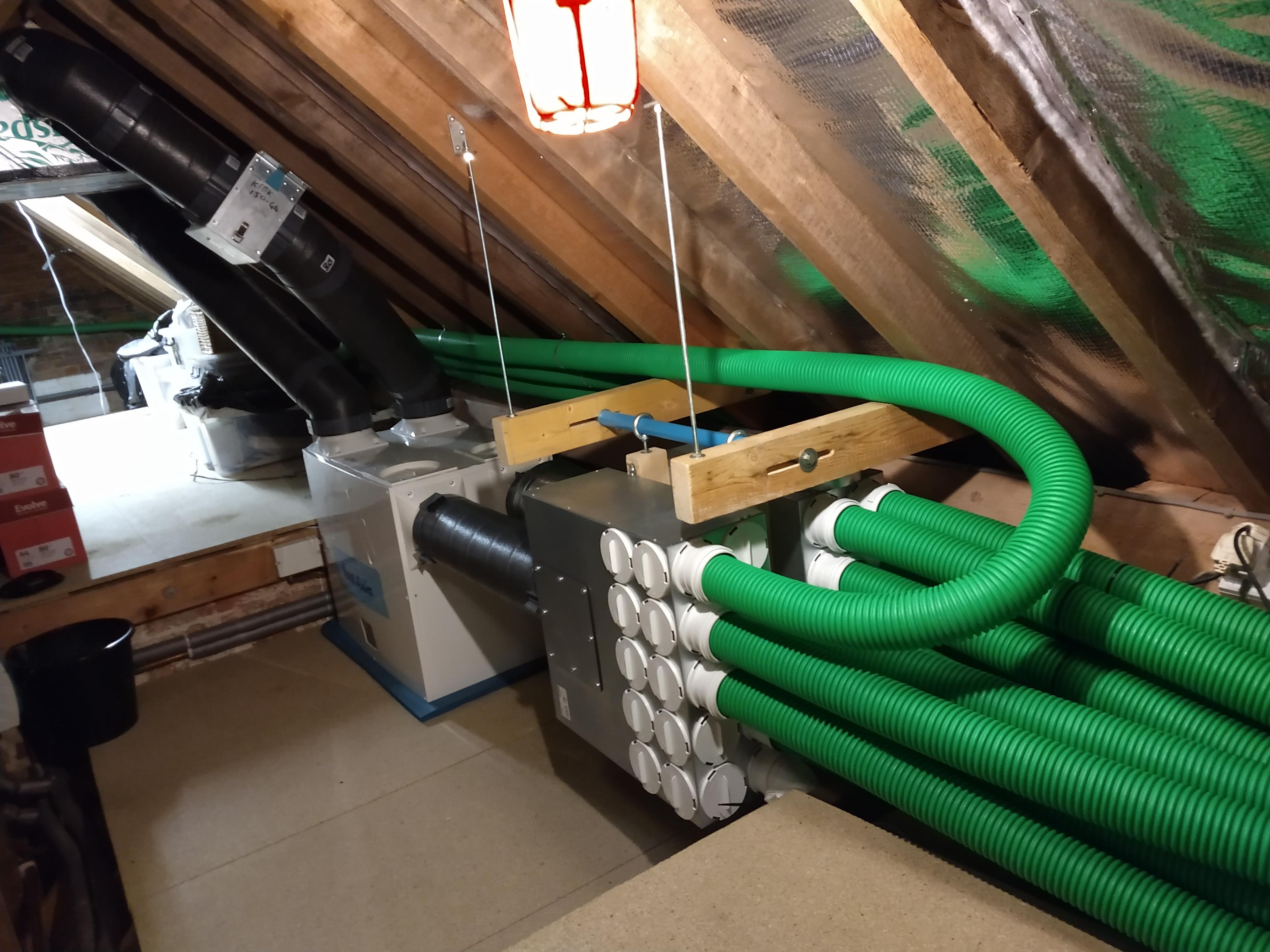

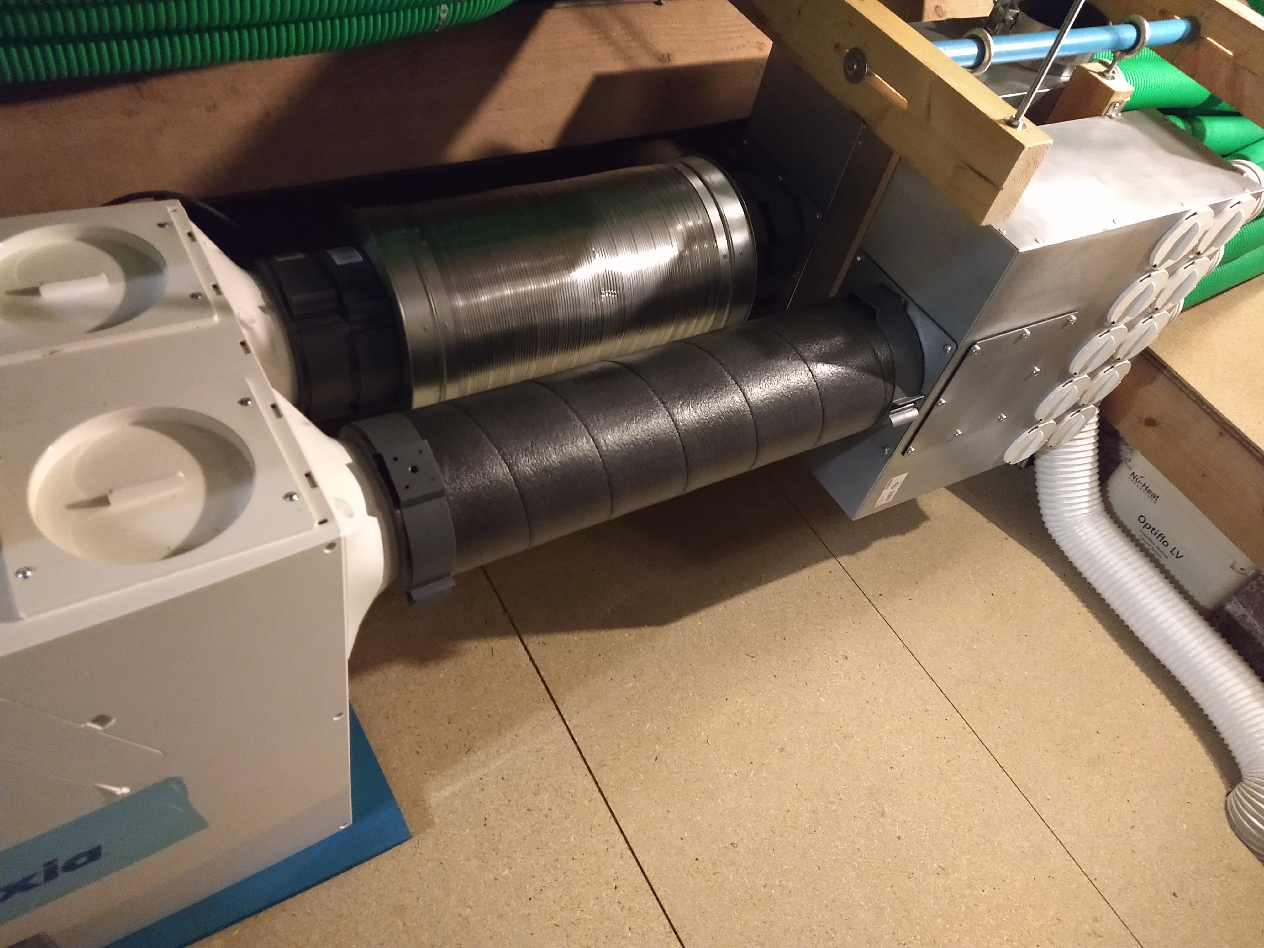

JFDIY Posted November 26, 2019 Posted November 26, 2019 (edited) Here's how I've done mine, semi-flexible silencer only on supply for now. I have space to do the same on extract at a later date if needs be. Edited November 26, 2019 by JFDIY 2
CC45 Posted November 26, 2019 Posted November 26, 2019 they look like really tidy connectors - any details? Tidy installation.
JFDIY Posted November 26, 2019 Posted November 26, 2019 30 minutes ago, CC45 said: they look like really tidy connectors - any details? Tidy installation. The 150mm stuff? It's ubbink insulated duct, there are joints and support brackets which you can use as clamps. 1
Pocster Posted November 26, 2019 Posted November 26, 2019 10 hours ago, JFDIY said: Here's how I've done mine, semi-flexible silencer only on supply for now. I have space to do the same on extract at a later date if needs be. Crumbs that’s super neat !!! 1
Onoff Posted November 26, 2019 Posted November 26, 2019 10 hours ago, JFDIY said: Here's how I've done mine, semi-flexible silencer only on supply for now. I have space to do the same on extract at a later date if needs be. Oh, thing of beauty! 1 2
Gone West Posted November 27, 2019 Posted November 27, 2019 21 hours ago, JFDIY said: Here's how I've done mine, semi-flexible silencer only on supply for now. I have space to do the same on extract at a later date if needs be. Excellent, that's the neatest installation I've seen. 1
