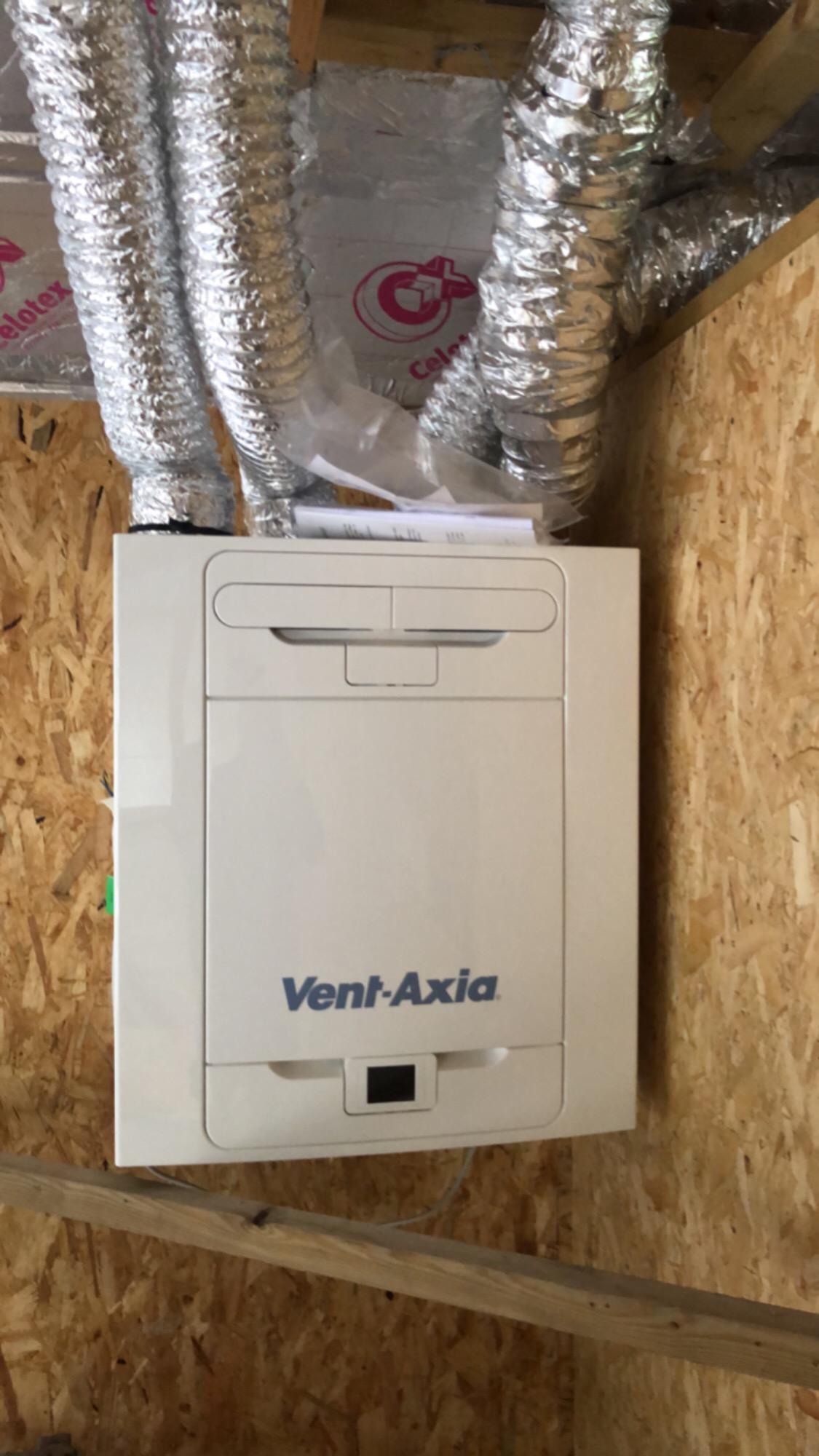

Pocster Posted November 12, 2019 Posted November 12, 2019 42 minutes ago, Savage87 said: What is the best location for the silencers? Is it before the MVHR unit or in between the unit and manifold/distribution box? Stuck mine straight on the mvhr
Savage87 Posted November 12, 2019 Posted November 12, 2019 that's what I'm planning to do, did you get the flexible or semi flexible silencer? Which duct(s) did you connect you're one(s) to ?
Pocster Posted November 12, 2019 Posted November 12, 2019 10 minutes ago, Savage87 said: that's what I'm planning to do, did you get the flexible or semi flexible silencer? Which duct(s) did you connect you're one(s) to ? semi flexible I think . Zip ties to Mvhr ; then taped throughly ? From memory ! By default mines a left handed system ; but I’m using it as a right handed system . So both ducts to the right are to atmosphere and from atmosphere; I think !!! ?
Pocster Posted November 12, 2019 Posted November 12, 2019 Hmmmm , now I’m thinking I’m wrong and it’s a left handed system looking at my photo . Silencers don’t go on atmosphere side - forgive confusing you and myself !! ?
Savage87 Posted November 12, 2019 Posted November 12, 2019 reading in the quiet vent brochure, it says: "It is recommended to install a flexible or solid acoustic silencer between the ventilation unit and the air distribution box in order to further silence the sound of the fan." and I've also seen other manufacturers say to fit them on the ducts that go to atmosphere. So, I'm a bit confused on what the best practive would be. 1
Pocster Posted November 12, 2019 Posted November 12, 2019 48 minutes ago, Savage87 said: reading in the quiet vent brochure, it says: "It is recommended to install a flexible or solid acoustic silencer between the ventilation unit and the air distribution box in order to further silence the sound of the fan." and I've also seen other manufacturers say to fit them on the ducts that go to atmosphere. So, I'm a bit confused on what the best practive would be. Yeah I’m not really helping am I ! I’m 99% certain my silencers are not on the atmosphere side - I’ll check tomorrow!!
CC45 Posted November 12, 2019 Posted November 12, 2019 just doing this now - the silencer (solid) is going between the unit and the distribution box - can't see why you would want it between the unit & outside. 2
vivienz Posted November 13, 2019 Posted November 13, 2019 13 hours ago, CC45 said: just doing this now - the silencer (solid) is going between the unit and the distribution box - can't see why you would want it between the unit & outside. Any chance of some action photos? I will be making some changes to our system soon.

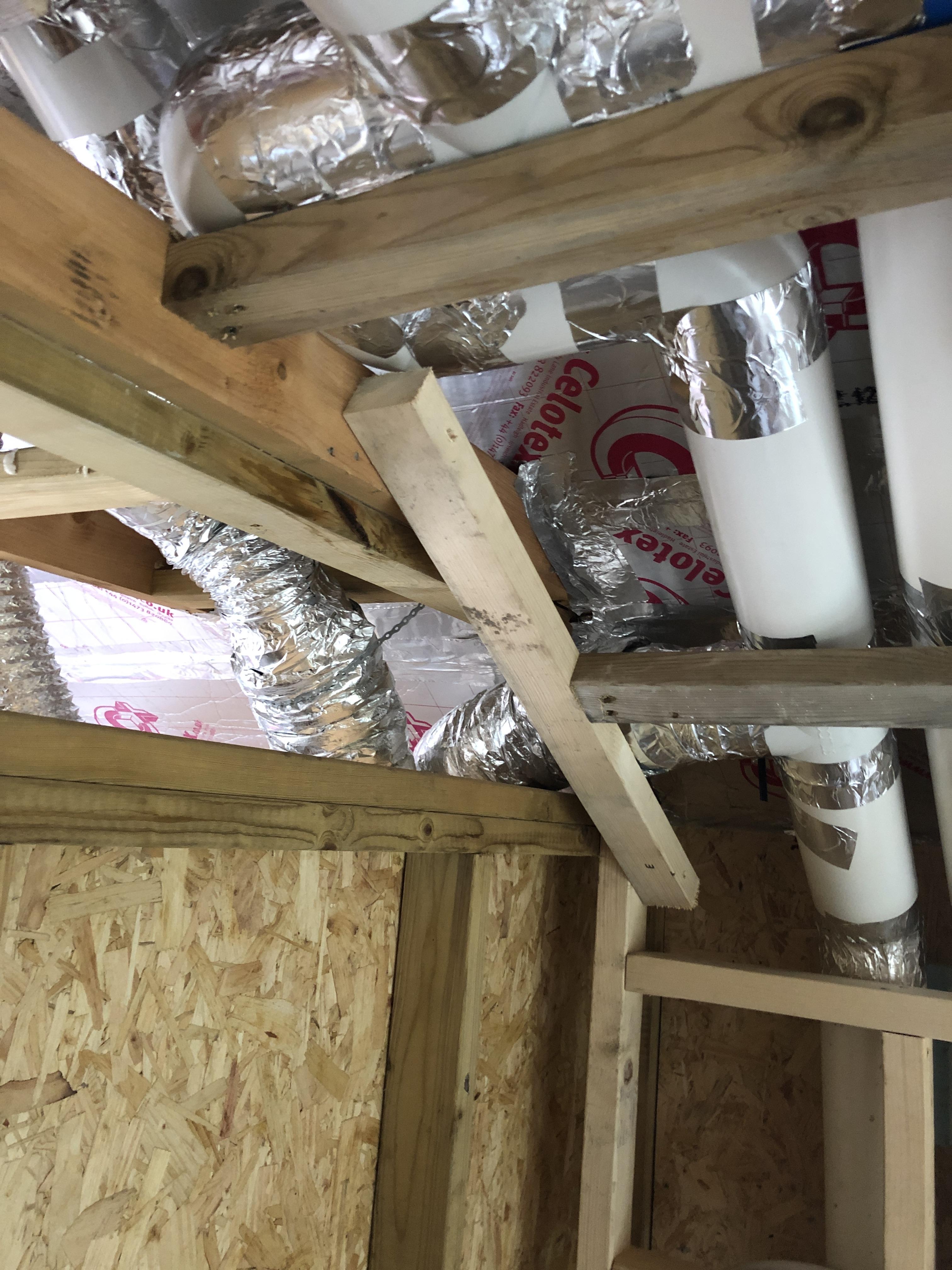

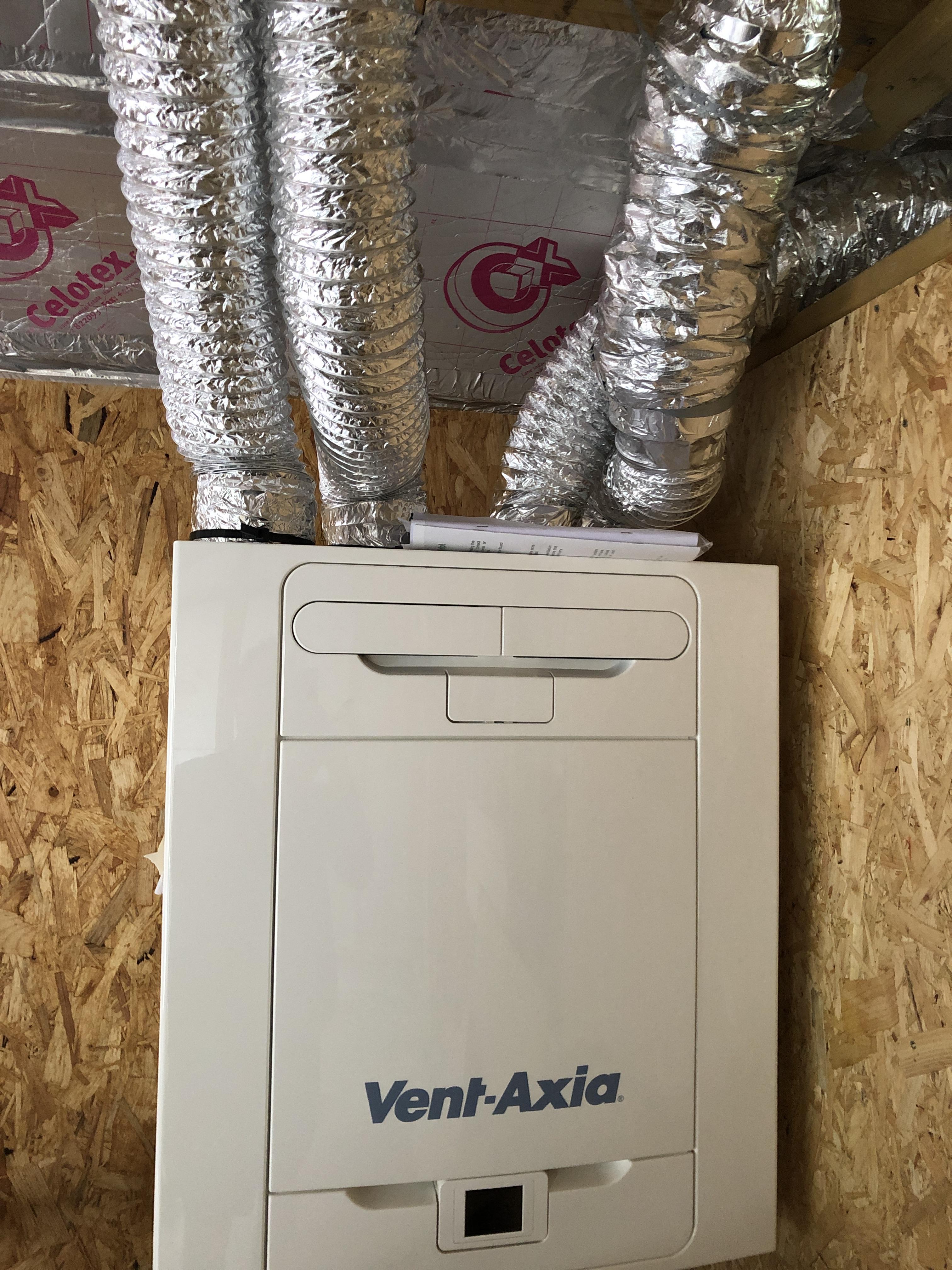

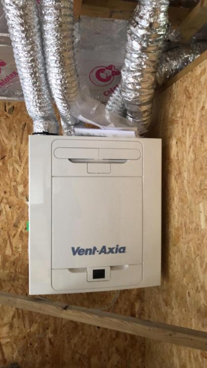

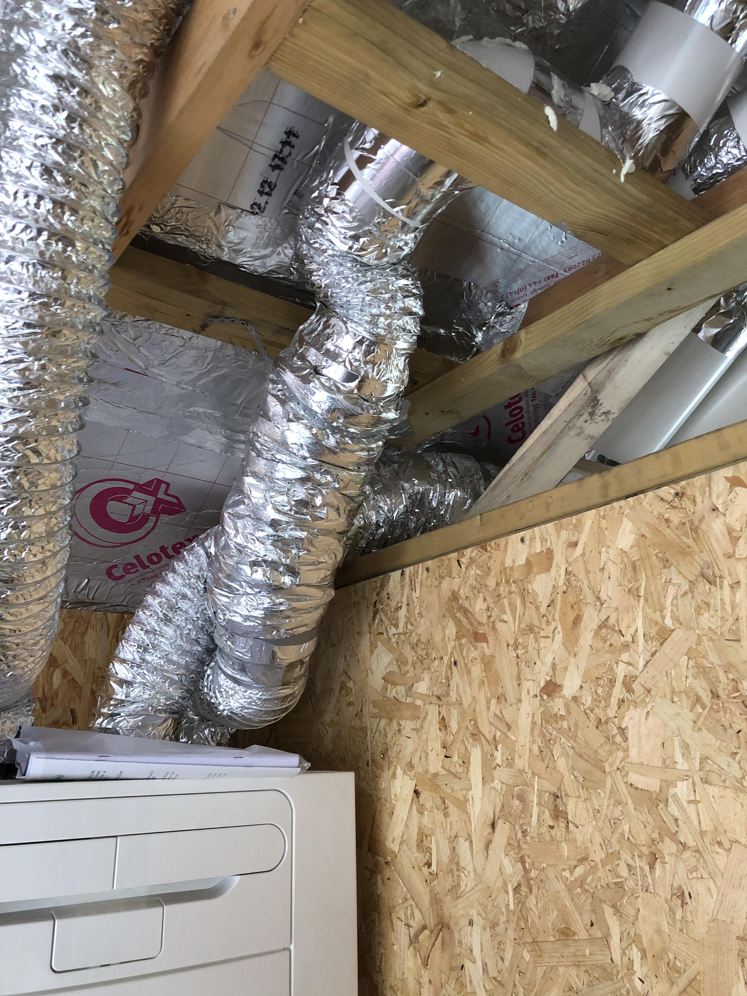

Pocster Posted November 13, 2019 Posted November 13, 2019 Can confirm as @CC45 said silencers NOT on atmosphere/ external vents . On site so got photos - forgive own dumbness . Installed it ( though not tested ) so automatically forget all about it and go and learn the next thing !!!
