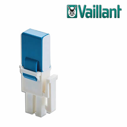

Dan F Posted June 29, 2020 Share Posted June 29, 2020 3 hours ago, joth said: ^ all of which is to say, your question is a very good one and I'd also be interested to know if anyone has experience of this with the Vaillant too ? But don't hold your breath waiting to find an installer that will give a straight answer! @davidc In the U.K they come with cooling disabled. Cooling can be enabled by adding a "coding resistor" 1 Link to comment Share on other sites More sharing options...

davidc Posted June 30, 2020 Share Posted June 30, 2020 (edited) Thanks @joth and @Dan F . I guess if clipping the resistor over a couple of pins on the PCB is sufficient alone to get the cooling working without any other measures on the UK units that is a result. Straying off topic ever so slightly, that would mean the installer would be unaware the system would be used for cooling post-install so are there any subtleties that the wider system i.e. UFH, pipework, manifolds etc need to be designed in mind with if the whole system is to be able to run in cooling mode also ? Instincts tell me not as it is the same thermodynamics just with the energy flowing in the opposite sense to warming mode. Interest in these for me was piqued a few weeks back as supplier local to my build (who was previously going to supply and install a Woodfire CX12 and 500L thermal store) phoned me up saying there were expanding into heat pumps and were now a new Vaillant agent - obviously he started extolling the virtues of the new aroTHERM units. I was slightly concerned about the potential to add to summer overheating problems with a thermal store under the previous plan and also to have both heating and cooling delivered by the one single appliance is a potential bonus. Edited June 30, 2020 by davidc typo Link to comment Share on other sites More sharing options...
