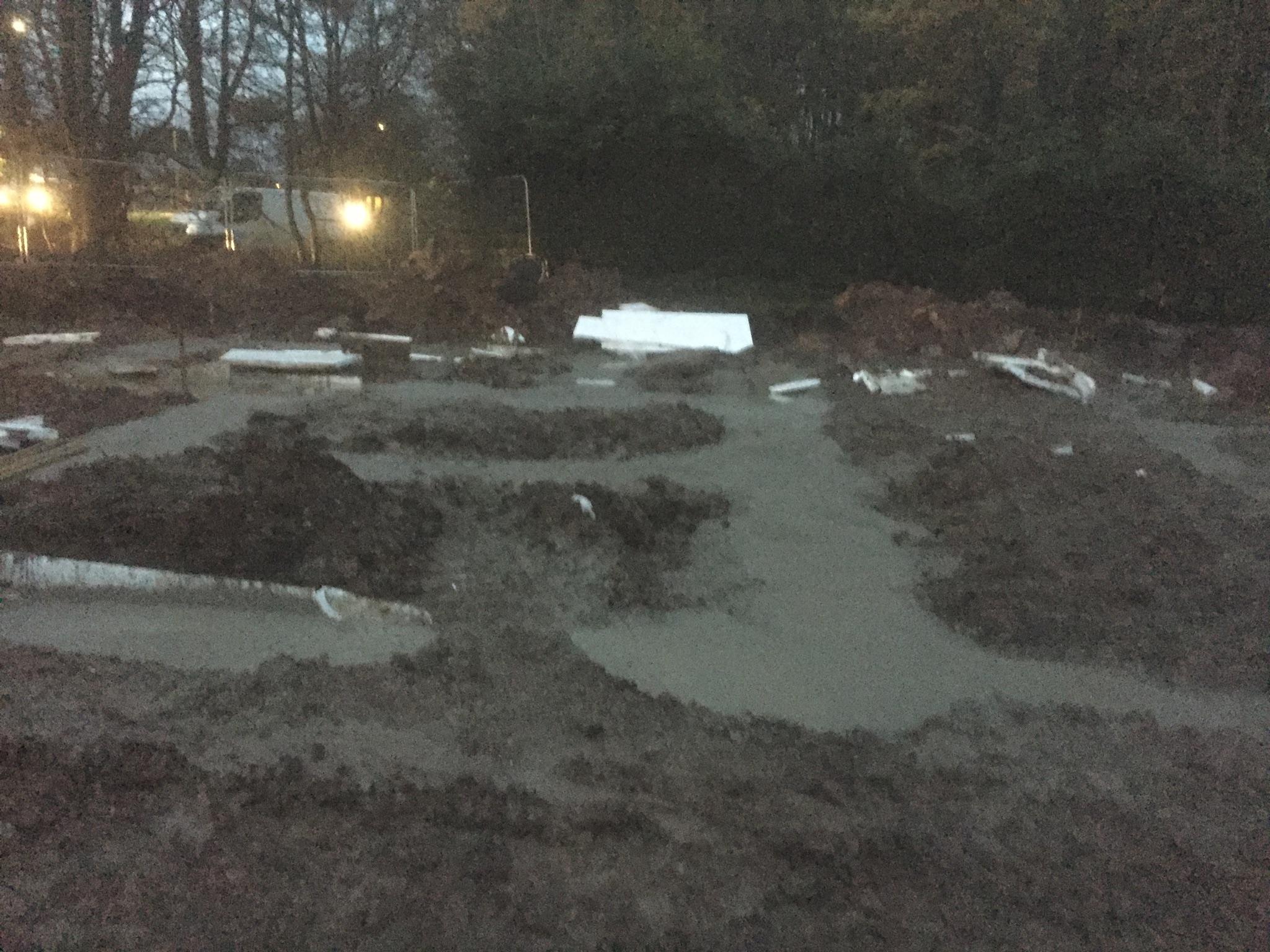

PeterW Posted October 9, 2019 Posted October 9, 2019 Get it poured and just get the founds covered with a sheet of plastic resting on a couple of piles of blocks in the middle to make a tent over the lot. Shouldn’t be more than £20 for the sheet - can always use the DPM for the ground floor. Time to start posting photos of the build then !

zoothorn Posted October 9, 2019 Author Posted October 9, 2019 2 minutes ago, nod said: The rain won’t bother the concrete The water will settle on top and can easily be pumped out before bricklaying starts I reassured by this, but look if 50-70mm hammers down during & after the pour it'll surely mix in.. I mean how could it not.. which therefore has to weaken the mix-?

nod Posted October 9, 2019 Posted October 9, 2019 Just now, nod said: Take a look at any building sites near you They won’t cover anything up The whole plot on ours flooded I had to full fill the trenches as the side where falling in due to heavy rain Like you we are on Clay The whole plot had to be pumped out whilst building the foundation brickwork
Oz07 Posted October 9, 2019 Posted October 9, 2019 They can pour concrete underwater. Unless your mixing it in it should mostly displace it. Await a boffins explanation... Get a pump, pump trenches out before pouring then leave well alone. They using a pump to get it round the trenches? I think far worse crimes are committed when builders have it piss wet to help rake it round
Oz07 Posted October 9, 2019 Posted October 9, 2019 1 minute ago, nod said: The whole plot on ours flooded I had to full fill the trenches as the side where falling in due to heavy rain Like you we are on Clay The whole plot had to be pumped out whilst building the foundation brickwork Images like this make you feel so much better when you're done!

PeterW Posted October 9, 2019 Posted October 9, 2019 Just let him get on with it. As @Oz07 says, concrete will set under water anyway - just make a brew and watch him get wet while he’s pouring it from inside the house ....
