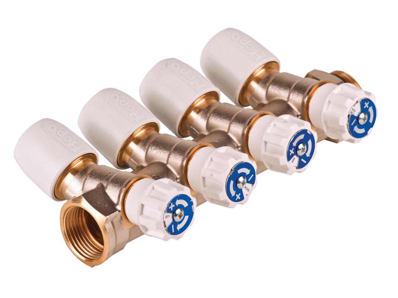

Pocster Posted October 8, 2019 Share Posted October 8, 2019 Ok ! So to supply domestic hot and cold intend to bolt these together . I do love them ; brass and isolation valve - don’t like the price though ! Anyway - how do you mount this mega manifold of manifolds to a wall ? They have no fixing holes . I know Wavin do a mounting bracket for ufh manifolds - but not this .... Link to comment Share on other sites More sharing options...

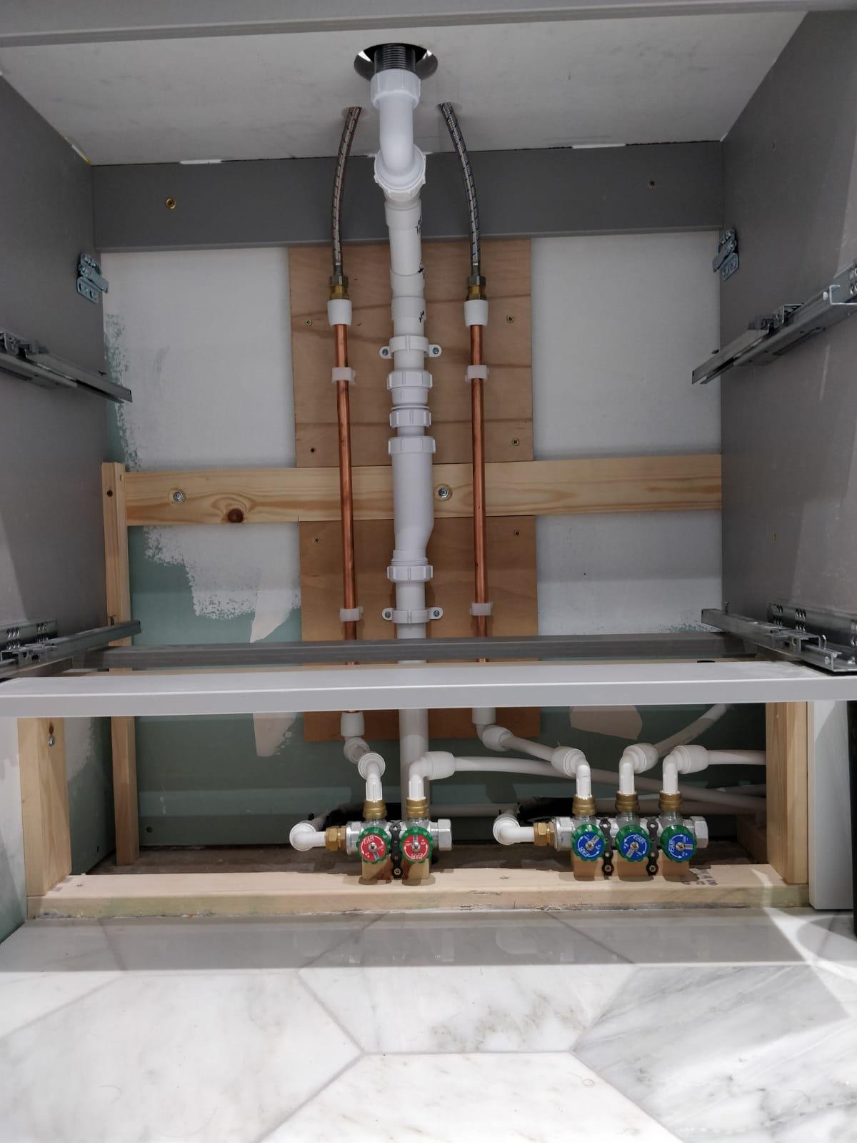

Adam2 Posted October 8, 2019 Share Posted October 8, 2019 Why not just use 2 shelf brackets and cable tie (or stronger) the manifold on top: 1 1 Link to comment Share on other sites More sharing options...
Pocster Posted October 8, 2019 Author Share Posted October 8, 2019 (edited) 3 minutes ago, Adam2 said: Why not just use 2 shelf brackets and cable tie (or stronger) the manifold on top: Yeah ; something as simple as that might work ! But i’m Going vertical now ! Edited October 8, 2019 by pocster 1 Link to comment Share on other sites More sharing options...

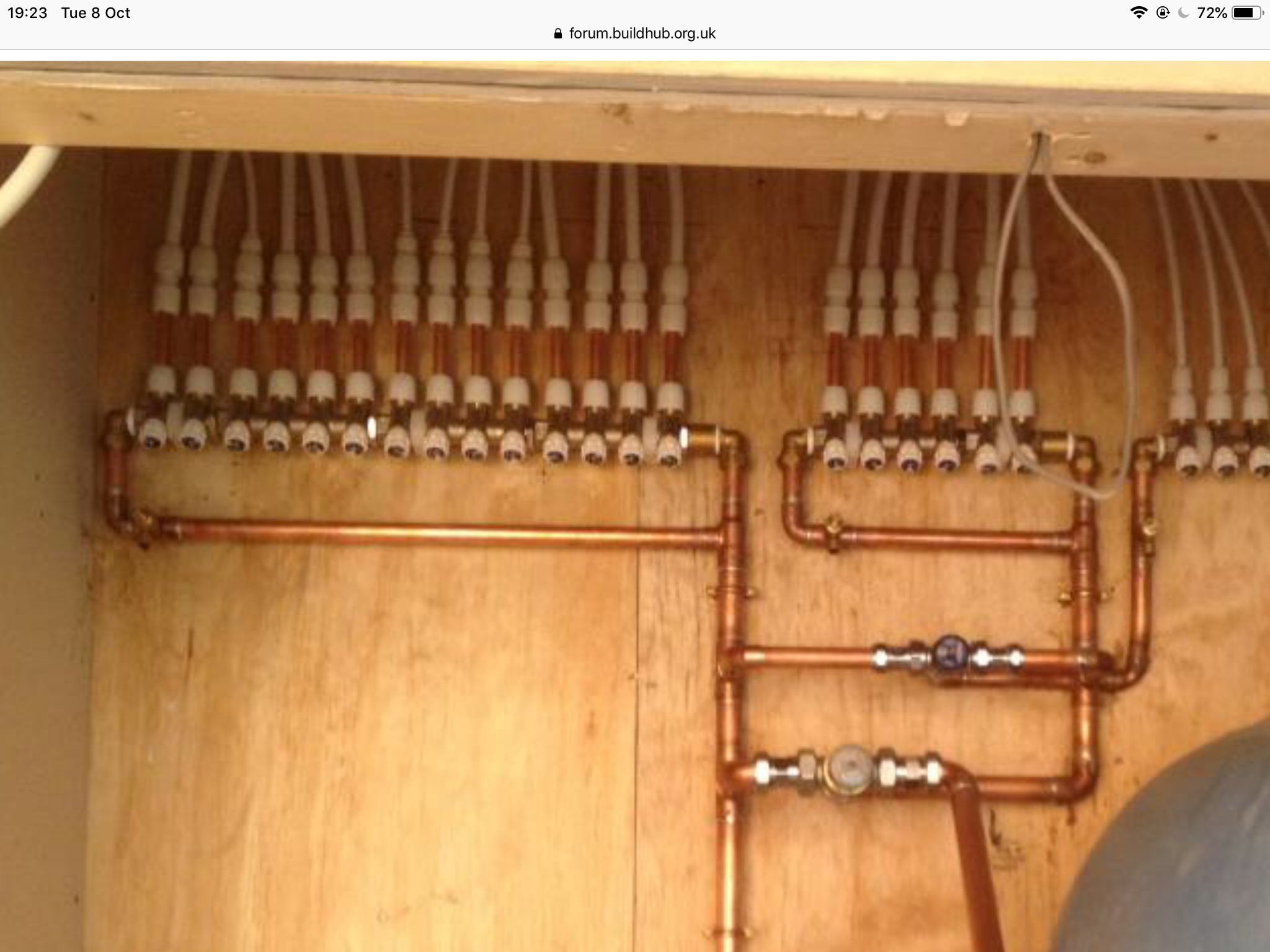

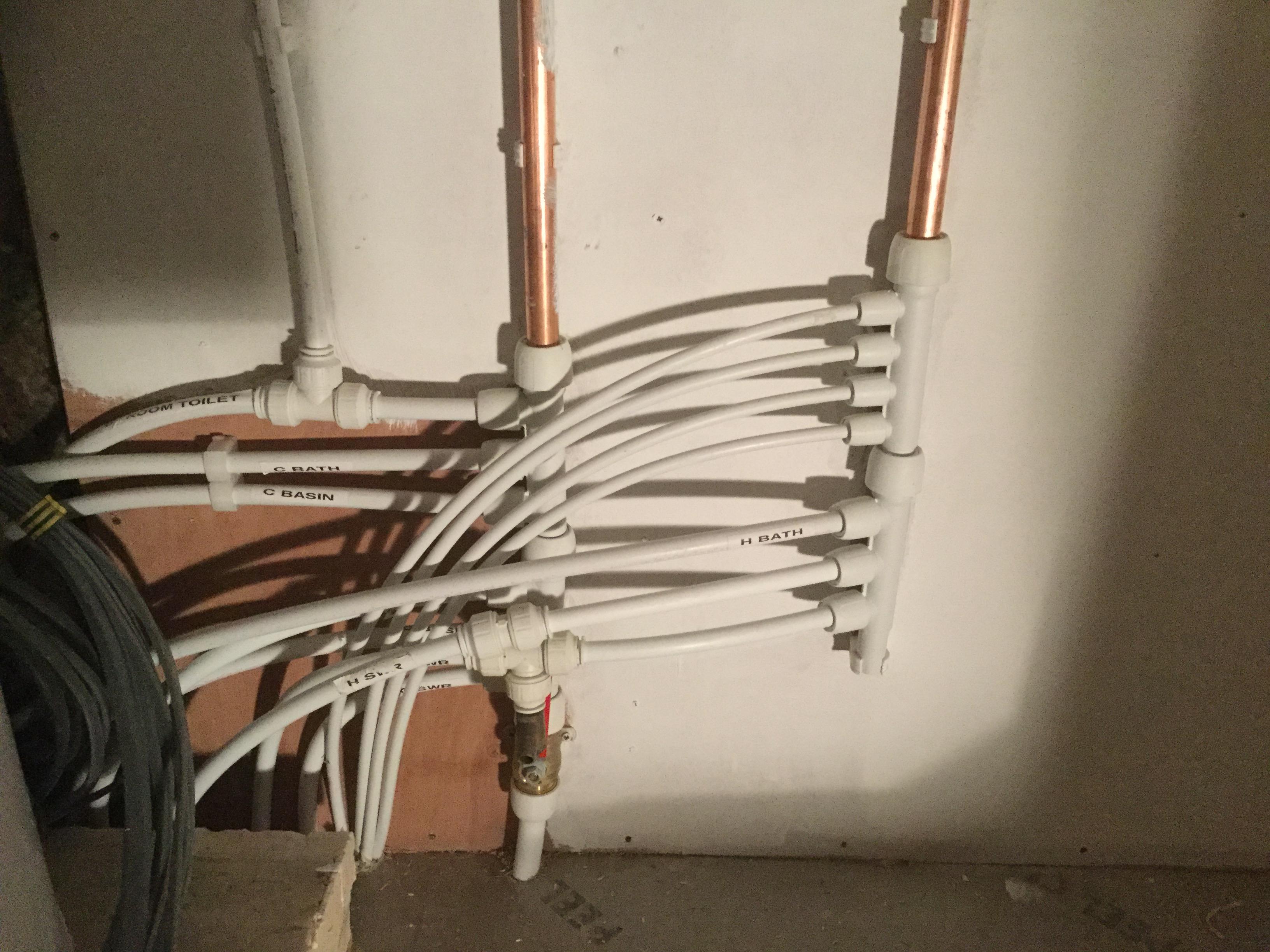

Russell griffiths Posted October 8, 2019 Share Posted October 8, 2019 here ya go. Picture stolen from nick the welsh wizard. 1 1 Link to comment Share on other sites More sharing options...
Barney12 Posted October 8, 2019 Share Posted October 8, 2019 5 hours ago, pocster said: Yeah I thought of that . But these things are quite heavy . I didn’t fancy say 5 joined together ‘sagging’ the pipes . Just seemed strange there are no lugs with holes for screw fixings . As long as the 15mm/10mm pipes coming out of the manifolds are also clipped it will be fine. I’ll try and find a photo of mine. 1 Link to comment Share on other sites More sharing options...
Barney12 Posted October 8, 2019 Share Posted October 8, 2019 Here we go, more of @Nickfromwales welsh wizardry 3 1 Link to comment Share on other sites More sharing options...
Pocster Posted October 8, 2019 Author Share Posted October 8, 2019 (edited) 29 minutes ago, Barney12 said: Here we go, more of @Nickfromwales welsh wizardry Neat ! So I could just use a bit of copper at either end with @joe90 suggested clips just to hold the entire thing ?! So which ‘copper end bits’ do I need ?? Edited October 8, 2019 by pocster Link to comment Share on other sites More sharing options...
joe90 Posted October 8, 2019 Share Posted October 8, 2019 With mine the 22mm copper pipe will suffice, but I think even 22mm plastic would be stiff enough if the clips are close to the manifold. 1 Link to comment Share on other sites More sharing options...
Barney12 Posted October 8, 2019 Share Posted October 8, 2019 21 minutes ago, pocster said: Neat ! So I could just use a bit of copper at either end with @joe90 suggested clips just to hold the entire thing ?! So which ‘copper end bits’ do I need ?? All my copper (inc the ends into the manifolds) are on munsen rings. I.e. https://www.screwfix.com/p/brass-munsen-ring-22mm-5-pack/3444J?tc=DB1&ds_kid=92700020952479607&gclsrc=aw.ds&ds_rl=1241687&ds_rl=1245250&ds_rl=1249404&gclid=EAIaIQobChMIoPPfvcuN5QIVBrDtCh22cQBwEAQYDyABEgKljvD_BwE definitely the strongest of all fixings and they enable full lagging. 1 Link to comment Share on other sites More sharing options...

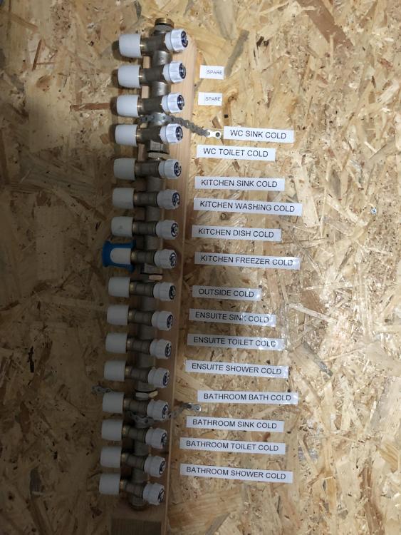

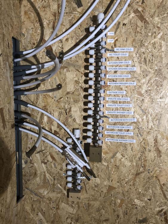

AdamSee Posted October 9, 2019 Share Posted October 9, 2019 I used the abacus manifolds for the bathroom. There were quite expensive for what they were and you can buy a bracket that hold them flush to a wall. But i just used a steel banding that you screw through. I particular like how each knob has colour face plates and a pre set list of appliances that there connected to (Sink, Toilet, Shower, etc). Its great because when I hand write a description, it looks like a child did it. Annoyingly they need a huge amount of ptfe tape to not drip and the feed in. Hoping the hard water in the area eventually clogs the tiny dip coming off of it. 1 Link to comment Share on other sites More sharing options...
joe90 Posted October 9, 2019 Share Posted October 9, 2019 5 minutes ago, AdamSee said: Its great because when I hand write a description, it looks like a child did it. And me, which is why I bought one of these https://www.ebay.co.uk/itm/DYMO-LT-100H-LETRATAG-HANDHELD-LABEL-MAKER-PRINTER-MONOCHROME-BRAND-NEW/181402127590?epid=78068478&hash=item2a3c68cce6:g:OLcAAOSwqu9VQ0RD sticks to pipes cables etc etc. Link to comment Share on other sites More sharing options...
AdamSee Posted October 9, 2019 Share Posted October 9, 2019 2 minutes ago, joe90 said: And me, which is why I bought one of these https://www.ebay.co.uk/itm/DYMO-LT-100H-LETRATAG-HANDHELD-LABEL-MAKER-PRINTER-MONOCHROME-BRAND-NEW/181402127590?epid=78068478&hash=item2a3c68cce6:g:OLcAAOSwqu9VQ0RD sticks to pipes cables etc etc. Sounds like a plan, I usually just wait until my wife is available and then give her the sharpie. 2 Link to comment Share on other sites More sharing options...
